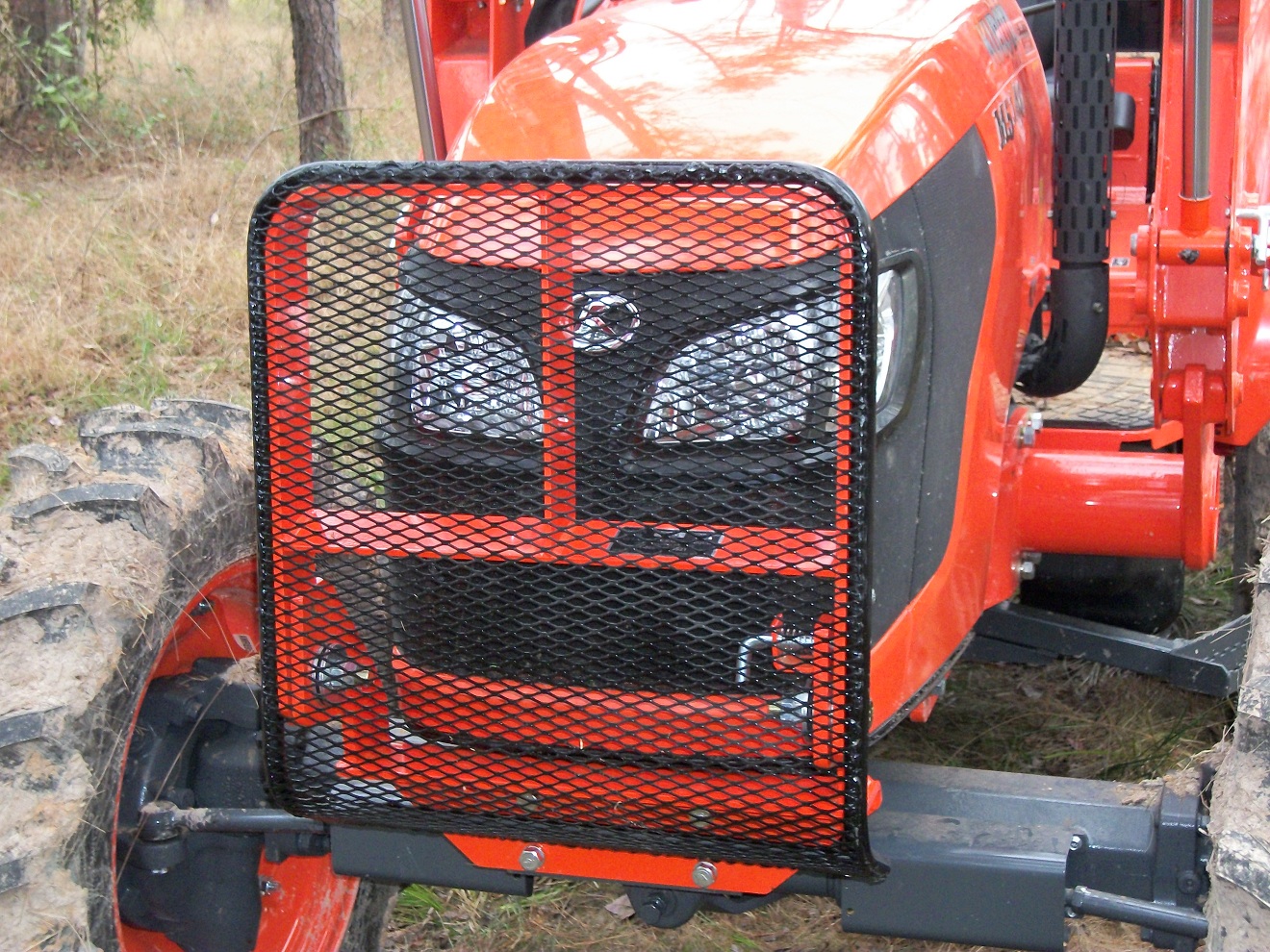

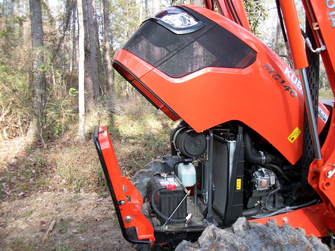

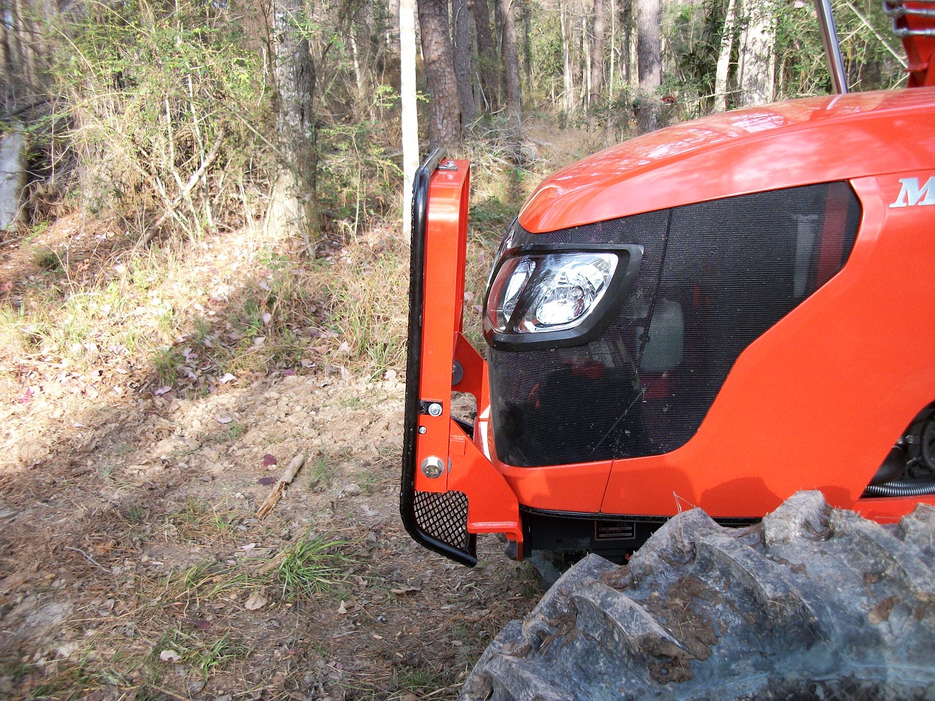

I would like to thank all u guys here at TBN for helping me decide on a grapple. I've ordered the LD 60" gator root rake...also wanted expanded metal for the front grill guard but couldn't bring myself to weld on a brand new tractor. So my solution was to build a light weight frame with the expanded metal welded to it...which fits over the original tractor guard and attach駸 with three bolts.

G_man, is it much trouble reaching around your grill to pop the grill guard latch
Hi jciburn, there is no trouble reaching the grill guard lacth....but I only had 1/8" clearance in order to open the hood.....too close for comfort. I'd shorten the bottom or lessen the curve at the bottom to allow for more clearance

Very nice work. Looks great. I punched a hole in my grill last year, so I'm seriously considering doing something like you did.
   / heavier grapple or not
#110
Thanks.
$20 material and 1 1/2 hours labor may save ya a couple of dollars in the future...good luck!
