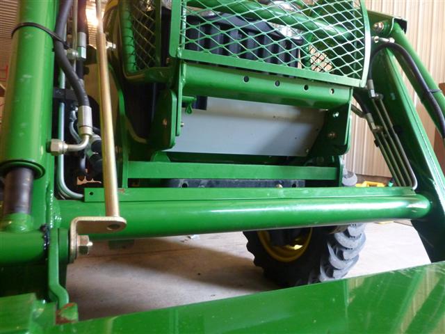

I would like to thank all u guys here at TBN for helping me decide on a grapple. I've ordered the LD 60" gator root rake...also wanted expanded metal for the front grill guard but couldn't bring myself to weld on a brand new tractor. So my solution was to build a light weight frame with the expanded metal welded to it...which fits over the original tractor guard and attach駸 with three bolts.
Very nice job! That's what I need to build.

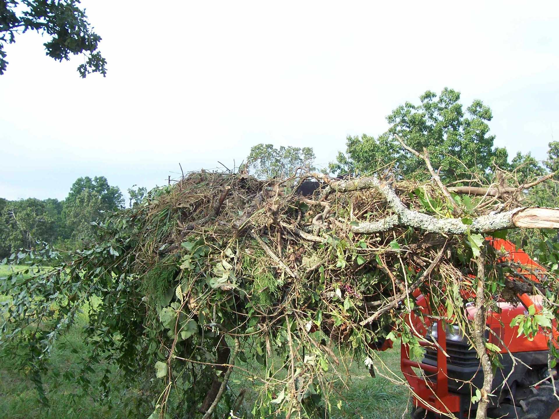

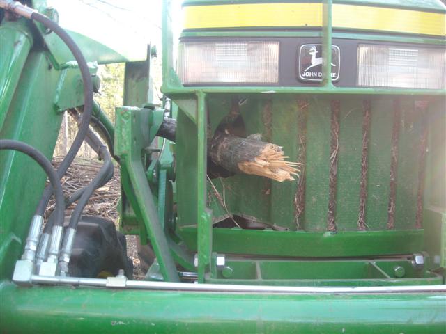

If you operate in timber and brush....sooner or later you wont see a branch....and its gonna bite you. While I am not proud of this event.....it seems to instill a certain urgency in some folks (including myself) to build better brush guards. ;)
After the incident in the first pic....I upgraded the guard on my old tractor. My new tractor (second pic) had a hole left unprotected by JD. A plate (in primer) solved that issue.
It's kinda a pay me now or pay me later deal IMO.
OH.....and protecting hydraulic lines can be worthwhile too.....don't ask me how I know.

You're right about that.. mine got a snout full of clay the other day when I was rolling a stump over, no damage but that was just luck. I may hook a piece of plywood up there untill I come up with a permanent guard cover. I think it ought to be solid, doubt if the ventilation is much of an issue, it's about six inches in front of the grill.

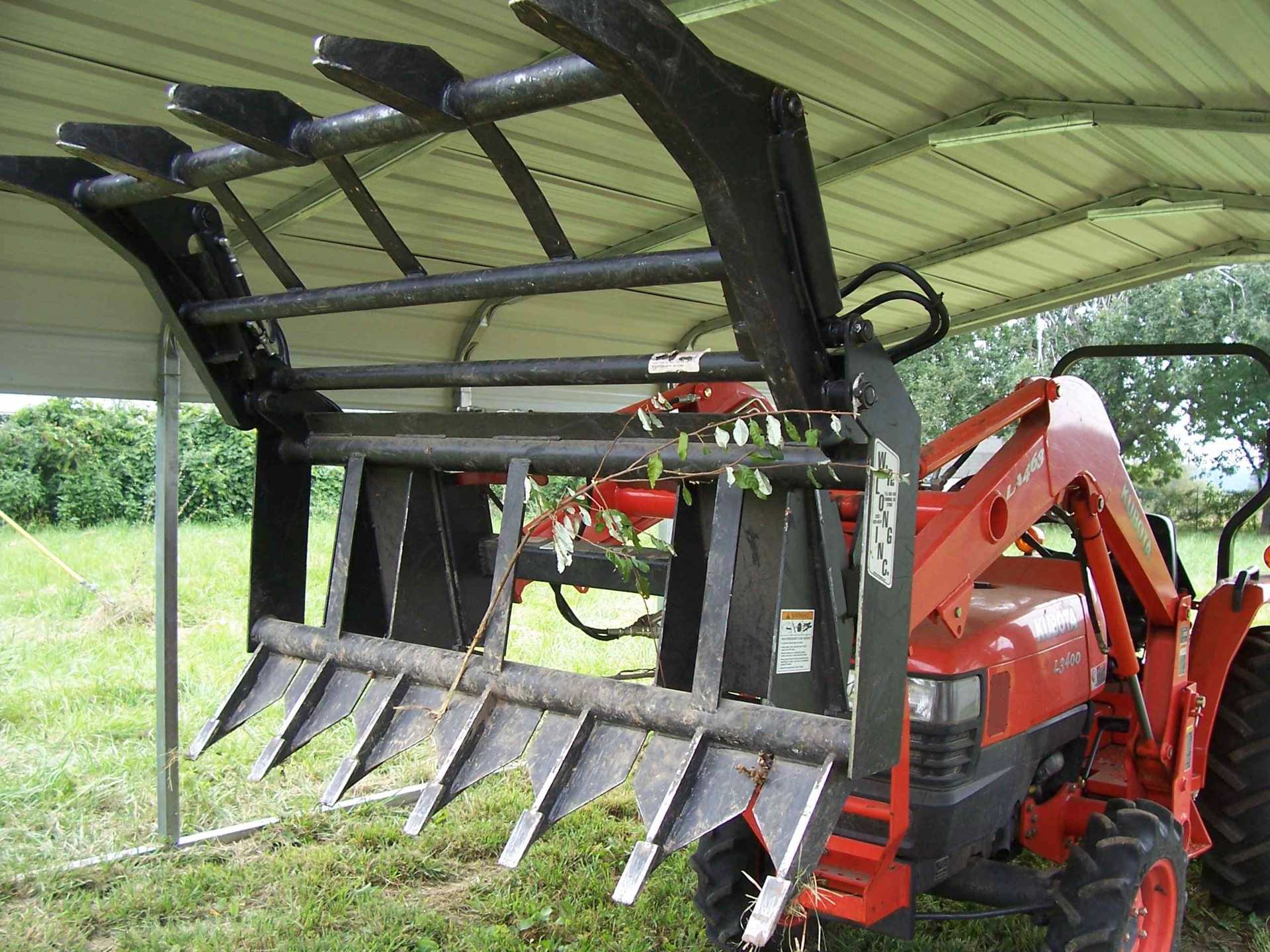

I really like my WRLong.

hey felllas, would it be best for added protection to add more spacers on the back of the grapple or something like 1/8" plate? The 1/8" plate has a weight of about 5.5 to 6 pounds per sq. ft. I was thinking of running it for 48" across the center...just don't know if it's a wise move.
   / heavier grapple or not #118
What do you mean, "spacers"? Plates to close in the back of the fingers?
#119
The extra spacers to close in the rear of the grapple or steel plate to seal it off from wayward limbs.
#120
sorry, not extra spacers...extra tines
