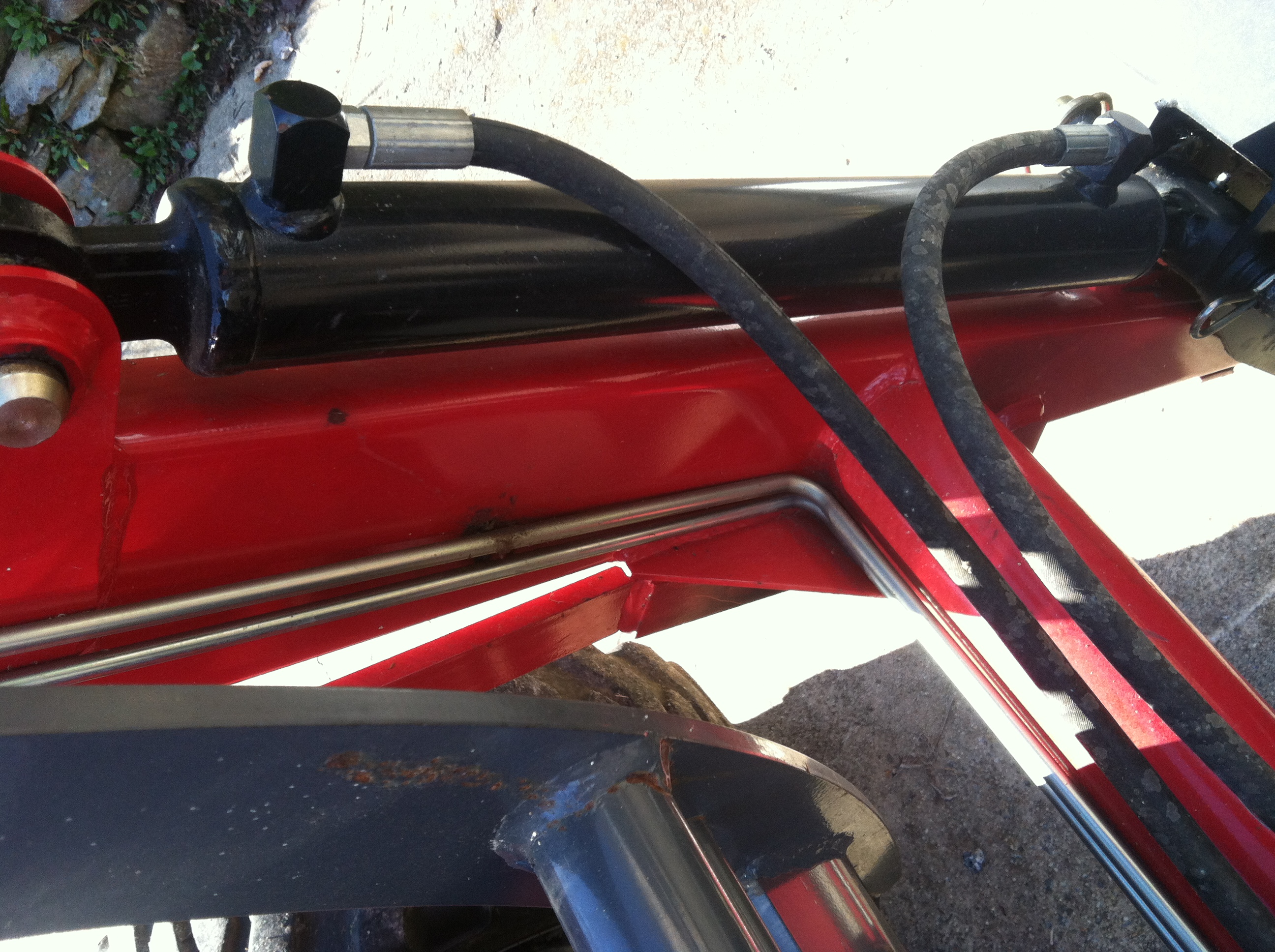

Got any pictures of how its plumbed? Or a drawing of where ALL 6 hoses go? IT could always be a bad diverter valve out of the box. But I think its more likely you just got some hoses crossed up.
And even if your loader is regen.....no it wont work for a grapple....but the curl/dump should be unaffected. Without "activating" the grapple button....the diverter just allows fluid to flow straight through it as it normally would before you started this process.

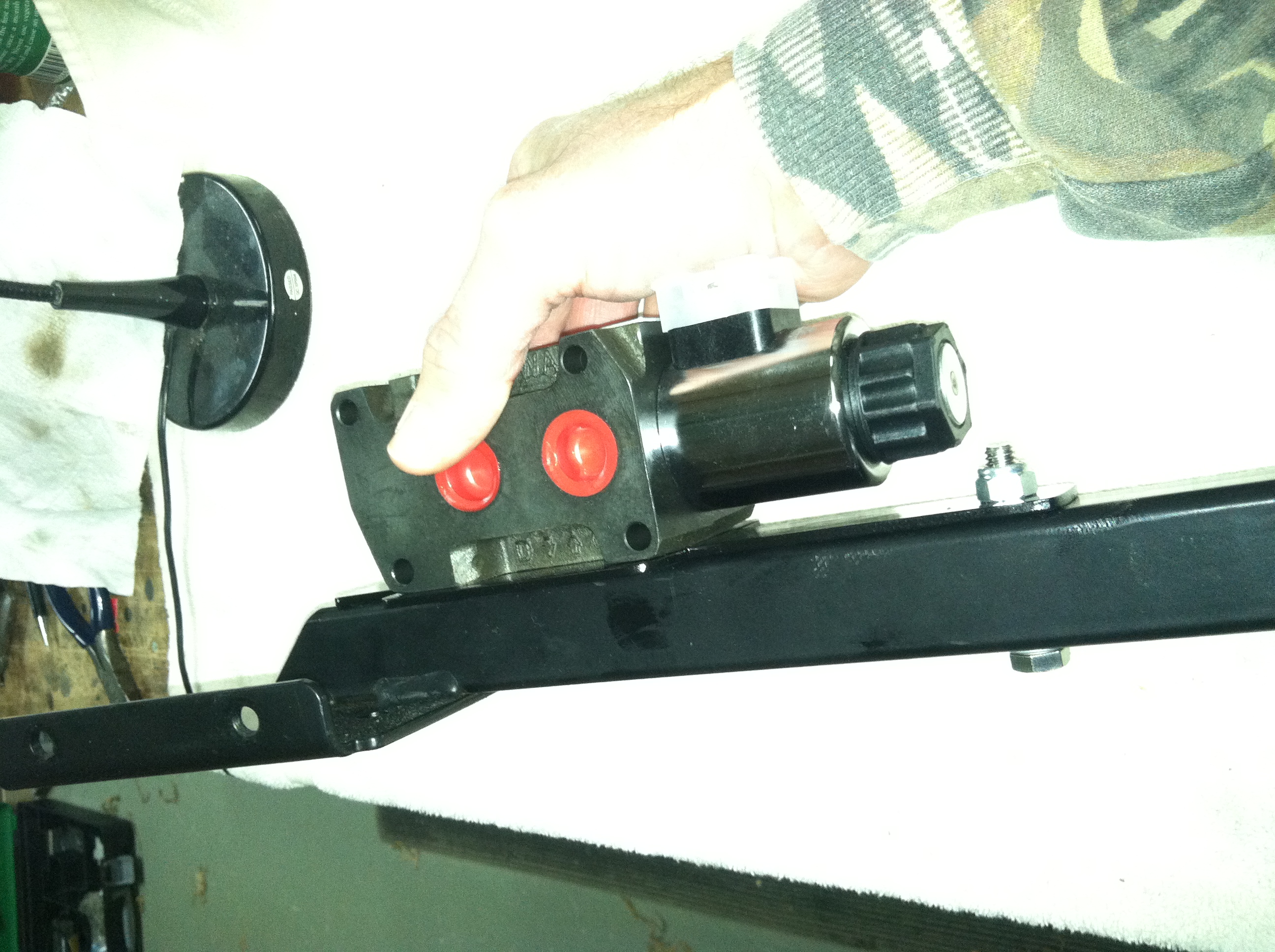

Hey LDI, I have it plumbed exactly like this diagram on the Surplus Center site; https://www.surpluscenter.com/_MoreSpecs/I9-8602.pdf.
All I did was to remove the two lines that feed the dump/curl from my loader valve, and in their place, I put two lines that sent their flow to the diverter valve. These two short lines go into ports P1 and P2 on the diverter. I moved the old dump/curl lines to port C and D on the diverter. My grapple open/close comes through two new hoses from ports A and B on the diverter.

Regen works for extending the cylinders to DUMP your loader because not alot of power is needed. On a grapple though.....Regen to extend /clamp down.....you will have about 1/4th the bite force the grapple should have. But that's only if it's a Regen valve
