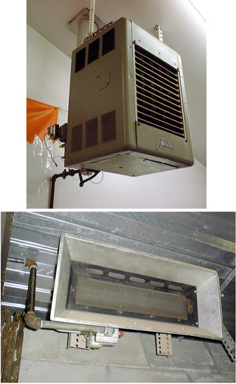

I was aware of the flicker problem with lighting and fans. My vision was, and I have never done it, that the lights would be hanging from the rafters at what would be ceiling height (no ceiling) and the fans would be above them attached to the ridge beam.
I have seen the tubes you describe. Use to have them in an old helicopter hangar that I worked in at Ft Stewart Ga. No, I never worked on helicopters. The Engineers took it over when the 24th Division was activated there.
When I said solar, I was thinking simpler and cheaper. I saw a design for a simple heat box to move air on the internet a couple of years ago and now I can't find it. It was nothing more than a plywood box with a glass face and it was painted black on the inside. It was attached to the south outside wall with vents to the inside. It drew air in, the sun heated it and the heated air went back into the room all by natural convection. It was a very slick design. I'm still looking for it.

Ozarker, Du-uh, of course, why didn't I think to think of the fans being above the lights? Oh, well. You like passive solar pumper warm air?
A book I read by a civil engineer who built houses, instrumented them, and sold them tells of a neat design:
Floor has regular cinder blocks laying on their sides with holes lined up horizontally as a substrate to the poured slab. Plenums (manifolds?) collect the north extremes together and likewise the south side. Registers in the floor and or wall at floor level allow air to circulate under the floor. House is typical passive solar with long dimension running E-W and lots of fenestration on south. Sun heats slab and likewise the air in the floor on the south side. It rises drawing in floor level cool air on the north side. As long as the slab is warmer than the cold air at floor level on the north side (sun is shining or has shined recently) the air is heated and circulated. Delta T from north to south side of the slab is only a few tenths of a degree. Thermosyphon continues several hours into the evening after there is no sun on the slab. Very even heat. Whole slab is warmed so get benefits of radiant floor heat plus gently circulating warm air. No electricity, no noise, no moving parts but air. He said some folks liked to have a small quiet fan to give stronger circulation, especially if the house is larger and flow paths are convoluted.
Pretty darned slick. Same guy did an analysis on building costs vs energy efficiency and found that 2x4 studs were often a "loss leader" item at builder supply stores but over all your total purchases came out about the same store to store. SOOOOOO he designed a double stud wall using the cheap 2x4 studs in two staggered layers, simulalting the 2x6, 2x8, or 2x whatever stud wall but WITHOUT thermal bridging. His walls were as cheap as a 2x6 but had no thermal bridging and could take an unbroken insulation layer essentially equivalent to more that a 2x6, plus the extra thickness of the actual studs. Very high R value walls!

I've see that design, cinder blocks on the side, someshere before. I would probably work for a house but I would be afraid of it for a garage where I was parking heavy equipment on top of cinder blocks paying on their side.
I also saw a design often used by people in poorer countries who live in small huts. Essentially, they build a fireplace/firepit on one side of the dwelling and the chimney on the other side of the building. Under the floor is a baffel system that forces the heated air from the fire pit to snake it's way through the baffels under the floor to get to the chimney on the other side. The original thermal heated floor design.
But think even cheaper than that for a minute. The heat exchanger I saw a couple of years ago and can't find now was designed to give supplemental heat in a room without making any changes to the house. It put heated air in through the window. Think window air conditioner but a window solar heat exchanger.
