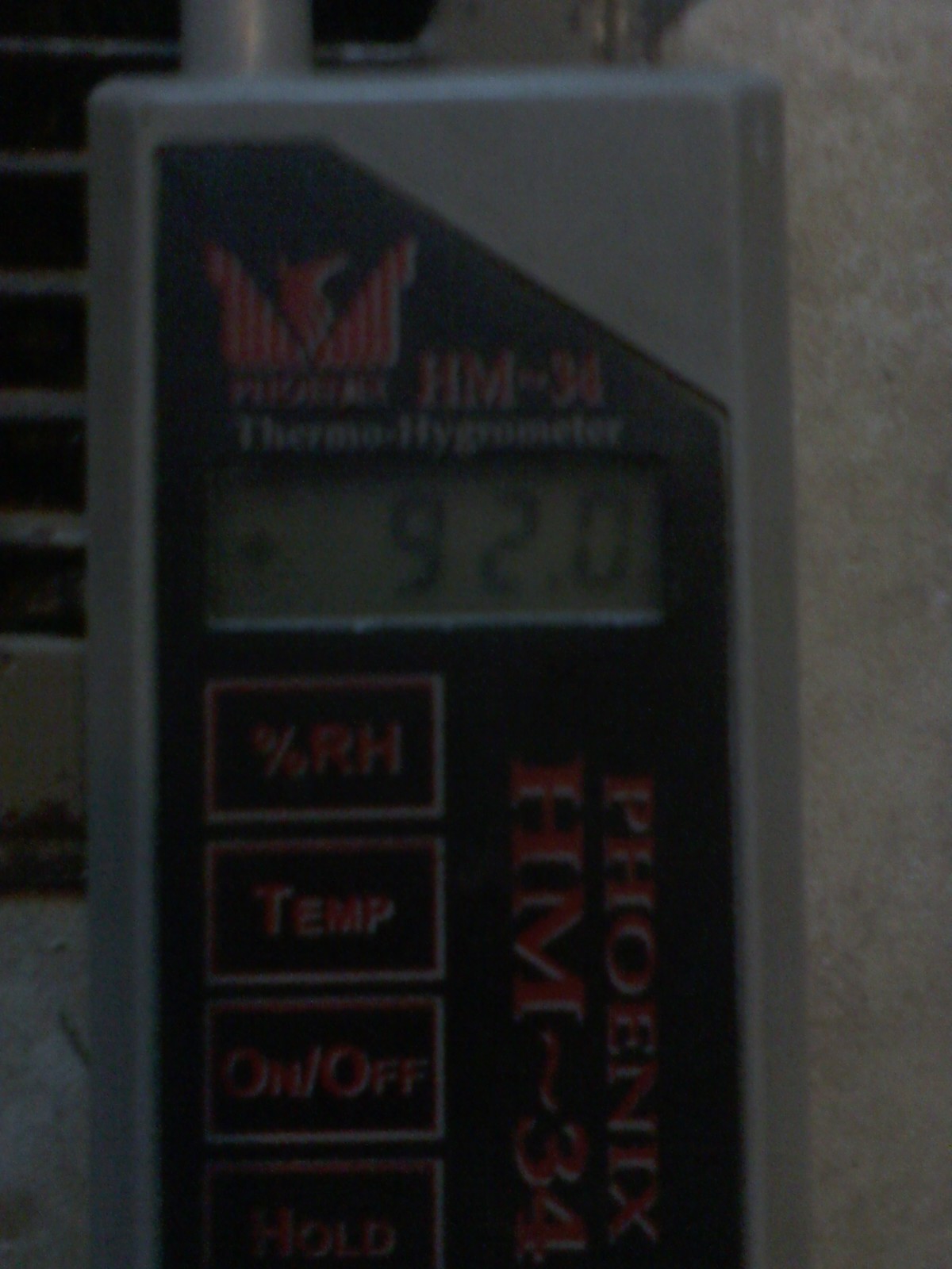

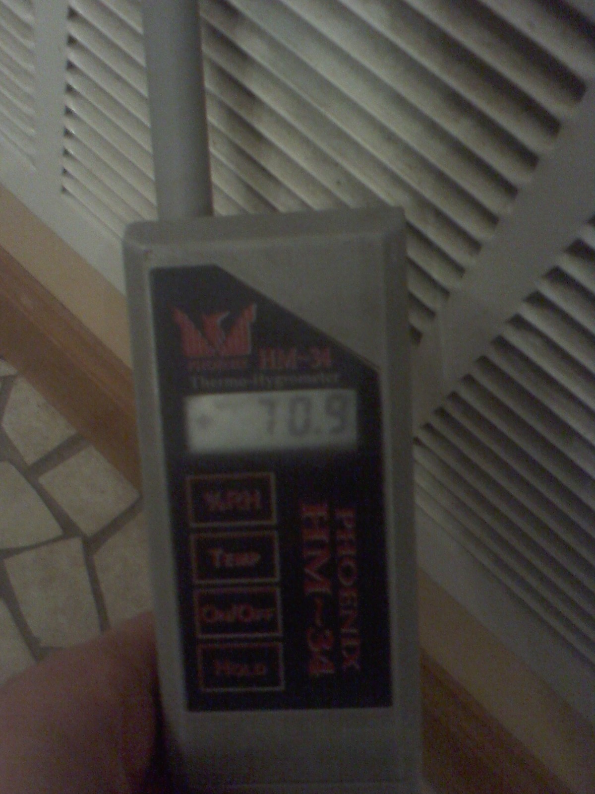

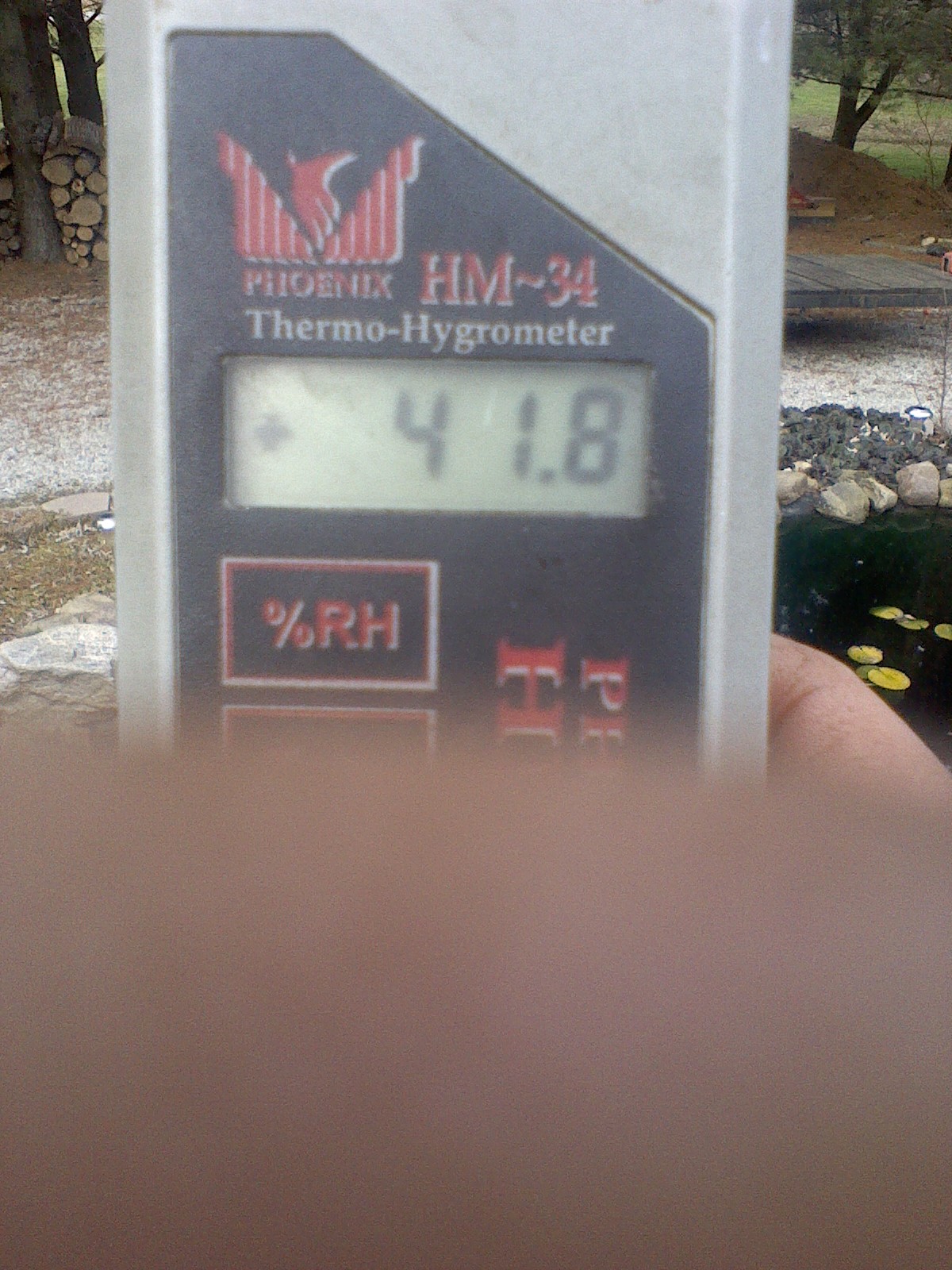

Pics of proof.
41.8 outside
70.9 vent return TO furnace
92 out of vents.
The 92 degrees was taken about 4 minutes after it kicked on. To allow all the duct work to get up to temp:thumbsup:
Using my spreadsheet I made last year, this equates to 23018 BTU/hr with my system. With the amps it draws, it is 12.5cents per/10000btu compared to 26 for propane and 29 for electric resistance.
So 2.3x's more eff than electric and a little over 2x's more than resistance.
If you guys are only getting 10 degree rises, either you have a blower blowing WAY more cfm to result in lower vent temps, or you have something wrong.
And I mean actually checking it with a thermometer. NOT just feeling it and guessing it isnt very warm. Because I assure you that 92 degree blowing air does NOT feel hot.

Most likely low on freon and it has been running with poor efficiency for a while. Now the pressure is too low and not allowing the compressor to run. Your EM heat is a pretty simple setup and I don't see why it wouldn't work. I assume that you can select it from your thermostat?
What is home warranty? It sounds like a homeowners association for appliances :confused2:
BINGO!!! HVAC guy just left. he foud a loose connection on the pressure side and he added just over 5lbs freon.
This very well could fix the efficiency problems also. I will monitor it.
