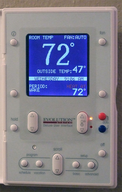

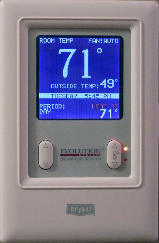

Before getting this HP, I had no idea how high-tech these things had gotten. Has a full color display which you have control over. With the cover open, you can see all the controls & if you know the secret handshake you get access to a whole lot more functions and info.
Air handler has a variable speed blower and I can see what the air flow is at any time. Controls measure pressure drop across the filter and pops up a message any time the filter needs replacing. Can also control humidity and if you live where the air is really dry and you have the humidifier attached in the system you can really control humidity over a fairly broad range.
Yesterday someone mentioned defrost cycles. Outside humidity impacts freq of defrost cycles. Real humid here and during real cold spells, my HP freezes up to the point system has to go into defrost mode 3-4 time an hr. All aux heat comes on at that time so if you have this situation you may be better off having the lock out point set a little higher so defrost cycles don't happen so frequently. Since my aux heat comes on in stages, it may be a little more economical to have aux heat come on in the 30-35 degree range than say low to mid 20's. During the heating season, I always have a small stream of water dripping from the HP.
This is true if you buy an 8-10 thousand dollar system, but folks like me bought a heat pump 3.5 yrs ago and just went with a base model Good quality goodman unit. I dont think it even has the capability and onboard computer to allow all that readout. I do have a normal programable t-stat. I just dont have 2 speed blowers and 2 speed compressors and 2 stage aux heat. So NOT all new heat pumps have ability like that. They still make units just like mine for afordable heat, which is all i want. My t-stat i think may be hunter now that i think about it.It was NOS from ebay i can see a cumulative aux heat usage from the whole time its on, and i can see a daily heat pump use for the day and day before in hours/mins.
