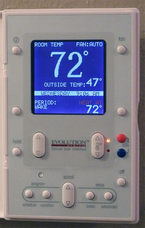

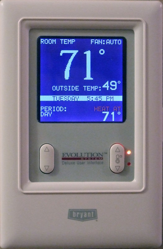

Been away from this thread for a few days so I'd chime in again.
David, check with you dealer to see what is available that works with your current equipment. In prior post you said the few features I mentioned are way more than yours. I have a Bryant a sister company to Carrier. Same thing with different name. Dealer said some of their equipment comes with labels for them to attach, either Bryant or Carrier. :)
In one of my posts I spoke about defrost cycles and how that can impact power usage with electric aux heat. Just to back up what I said, decided to take a look see at the recorded data. First stage is lowest and third the highest and is what is on during defrost cycle.
With lock-out point set @ 30F here are the run times in hrs for each heat cycle. 1st = 16, 2nd = 6, 3rd = 36 of which 31 hrs for just defrost. So far this yr HP cycles are as follows. Heat = 1894, Defrost 972. That's a whole lot of cycling and time spent on defrosting. Based on this I've adj the lock-out temp up to 35F in attempt to drop the number of defrost cycles. Could be even with the higher temp setting, total time and amount of aux heat could be less. So having the lock-out set to very low temps may not be the low cost solutions. Lot depends upon humidity during the winter months.
