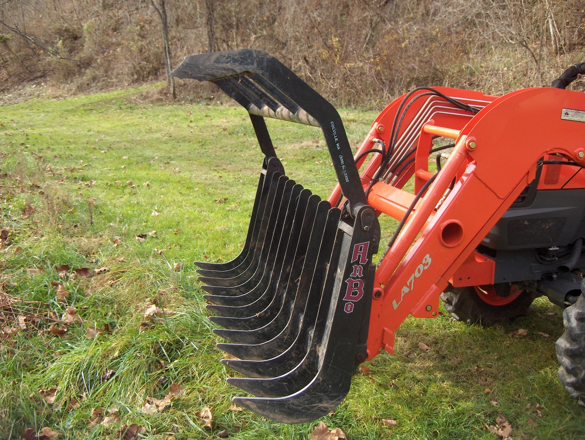

I have the Anbo Grapple Root rake and I love using it. You have nailed the shortcoming of the root rake design but they do offer the ability to back rake. Here is a link to a post from some work I did last weekend.
The Anbo is tough and light for its size.

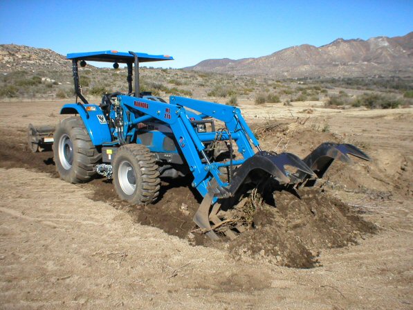

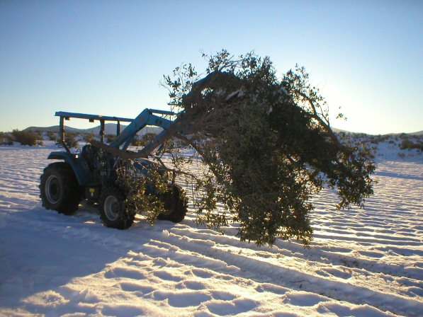

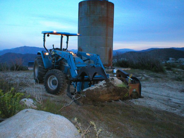

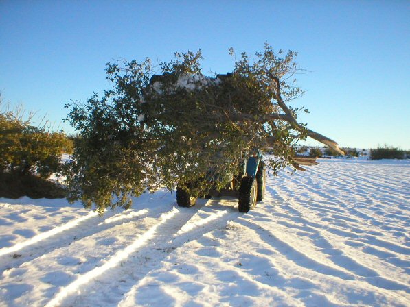

I am able to exceed the capacity of my tractor if I am not careful. It handles what I need it to do very well. Disregard the Jack Russel Terrier I let him run the grapple every now and again or he gets a bit grumpy.:D
