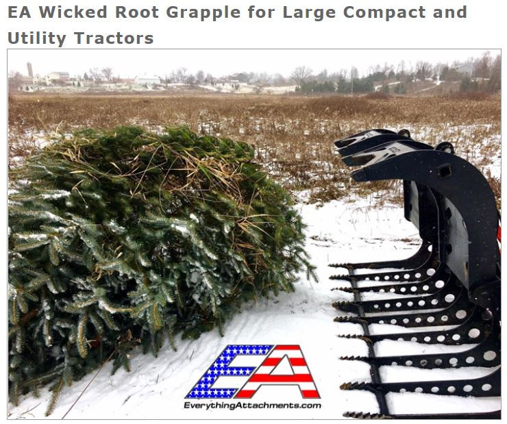

The best grapple Made in the U.S.A.: Wicked Root Rake Grapple
Free shipping
Not free shipping if you are outside 1000 mile radius unless they changed it. Also a very very long wait. Hope you dont need it this summer or fall!

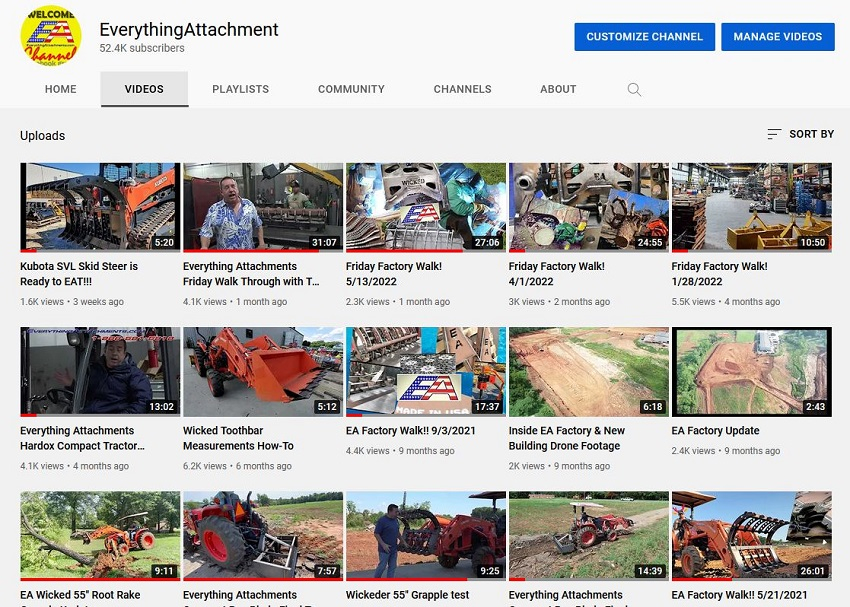

If you want the closest inside look at EA, go here: EA Group
Also, check out our factory tours. The latest couple give you a look at our new factory expansion. EA YouTube Channel
We're not crazy about the wait, but I've heard worse.
If you can wait, I'm confident that you'll be glad ya did.

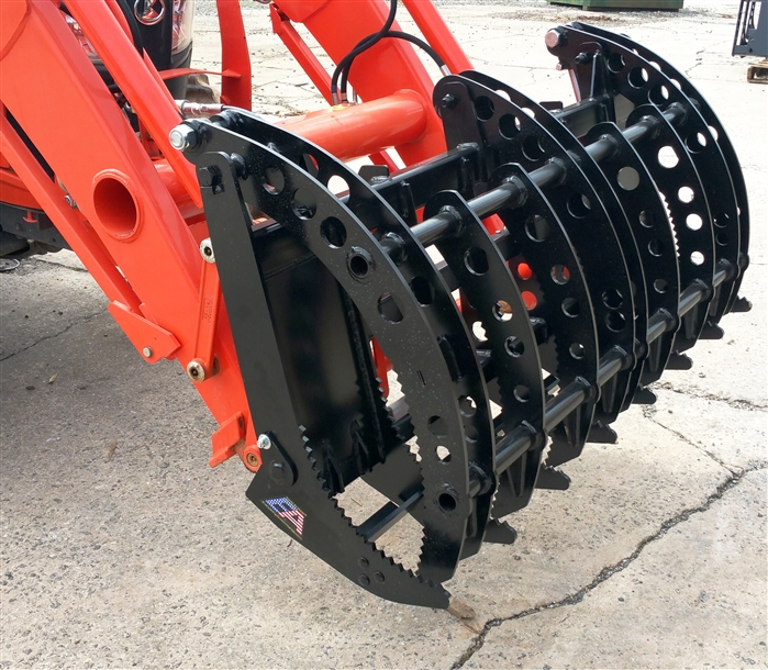

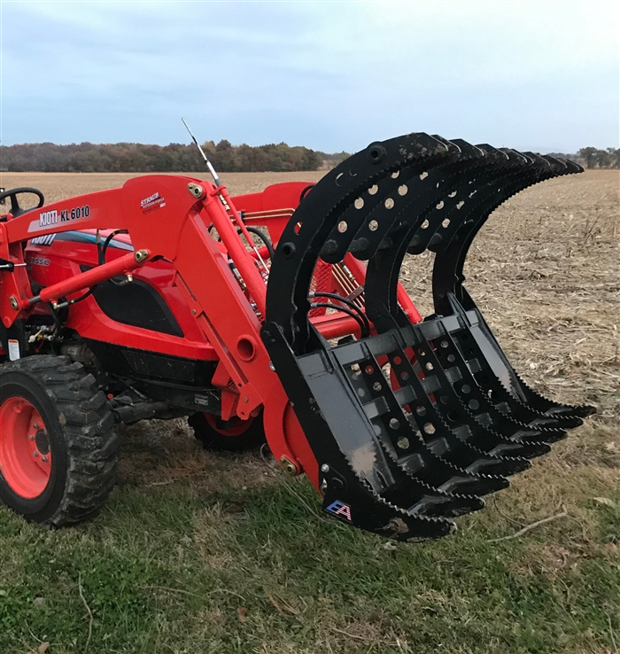

Regarding width, I like a wider grapple for brush (mostly what I deal with). "Wider" still does big stuff (I'll spare everyone my pics to demonstrate). HOWEVER, "wider" means you have to be a LOT more careful to avoid snagging it on things that you don't want to hit/snag! I've caught my grapple on a fence post (I've not only got a Wicked grapple, but also a wicked fence- it came to a draw, the tractor pretty much stopped, though I sensed the impediment and pulled off the travel pedal before I pushed the post any further [it was straightened out OK]). I clipped a corner of a pole shed roof and tore that up pretty good: the shed is an inherited (here when I purchased the property) low-budget affair, so some non-artistic cobbling and it was back in order.
My grapple (for my Kioti): 66" EA (single lid)

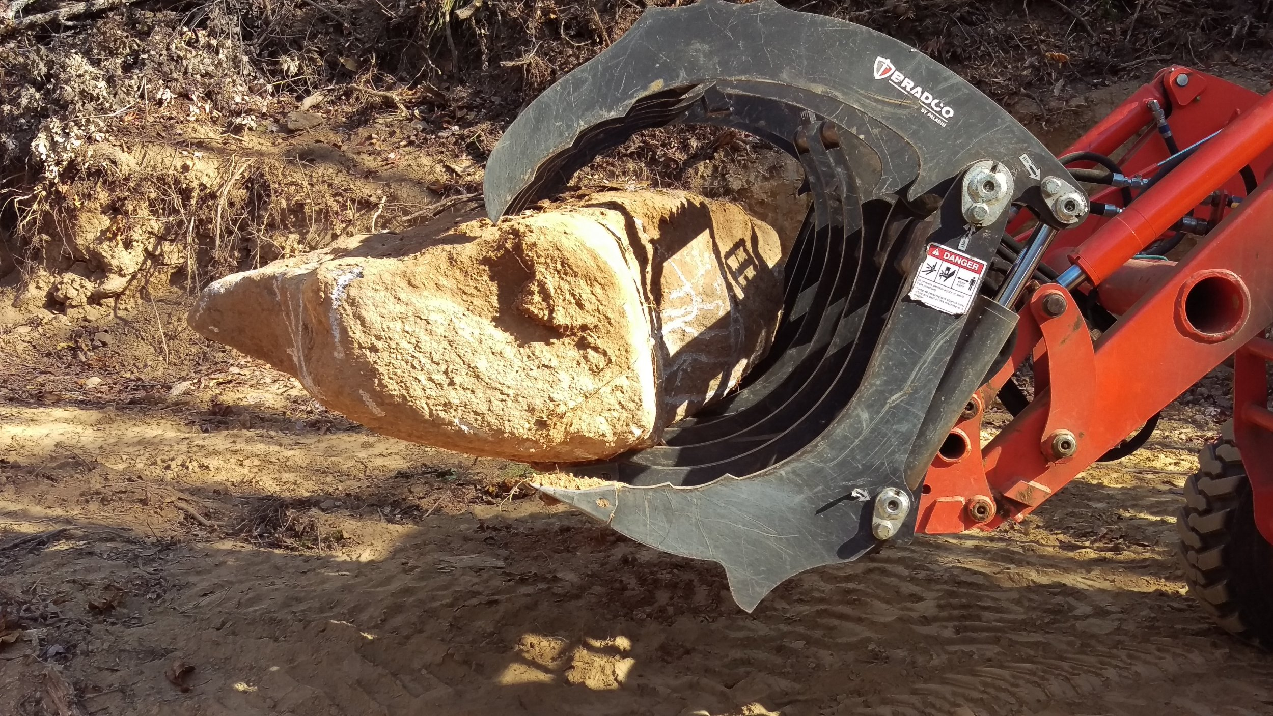

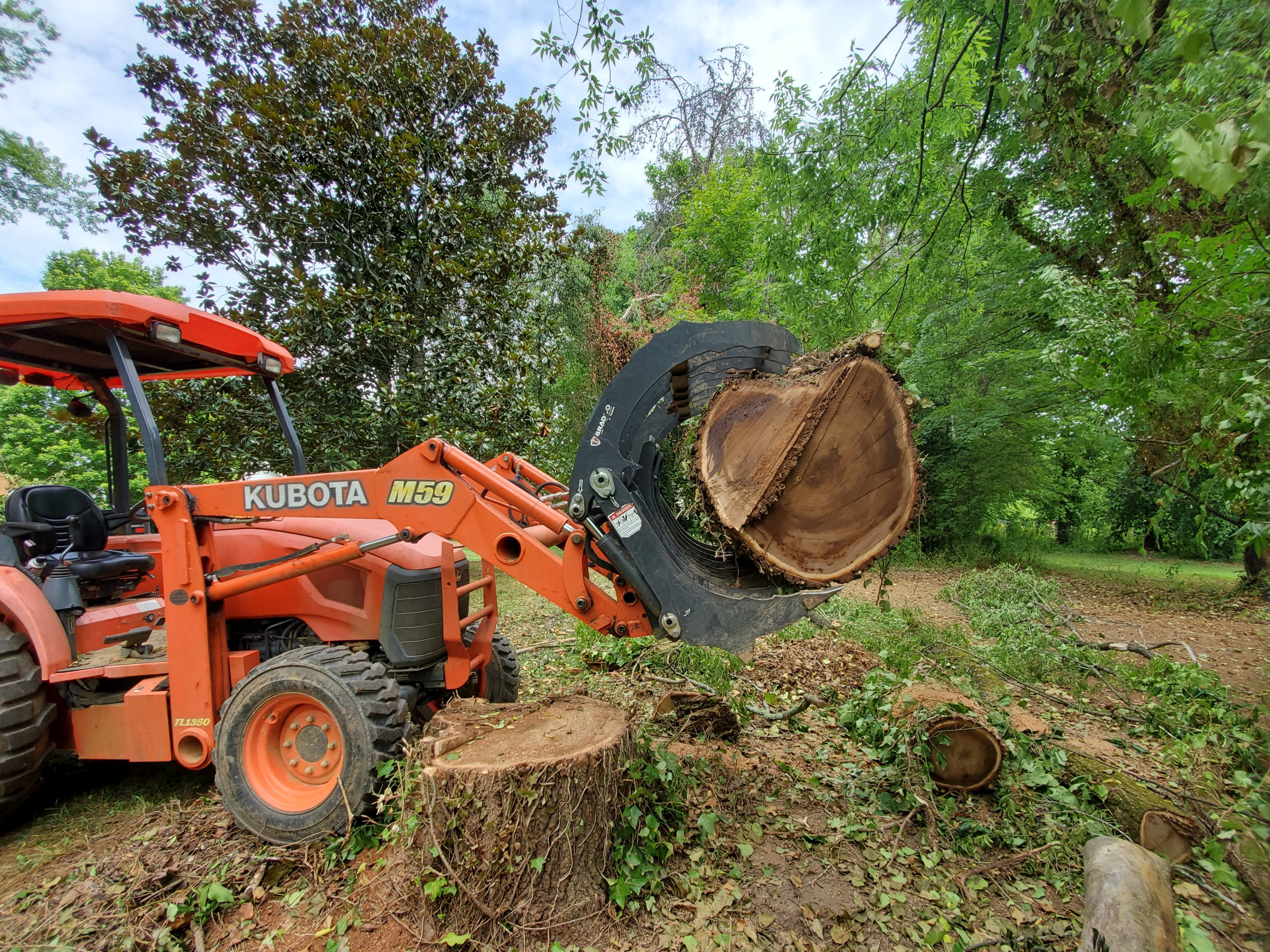

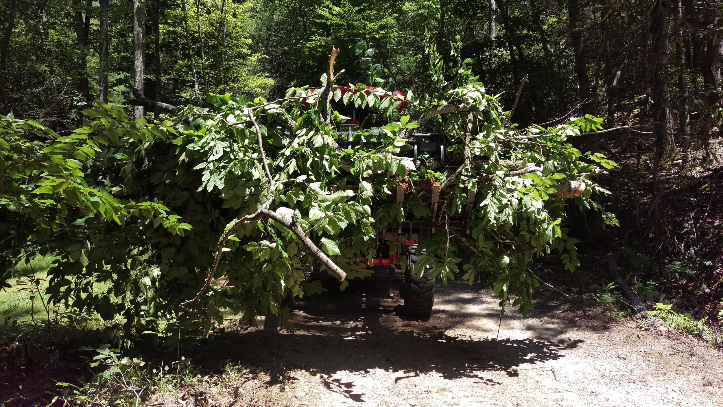

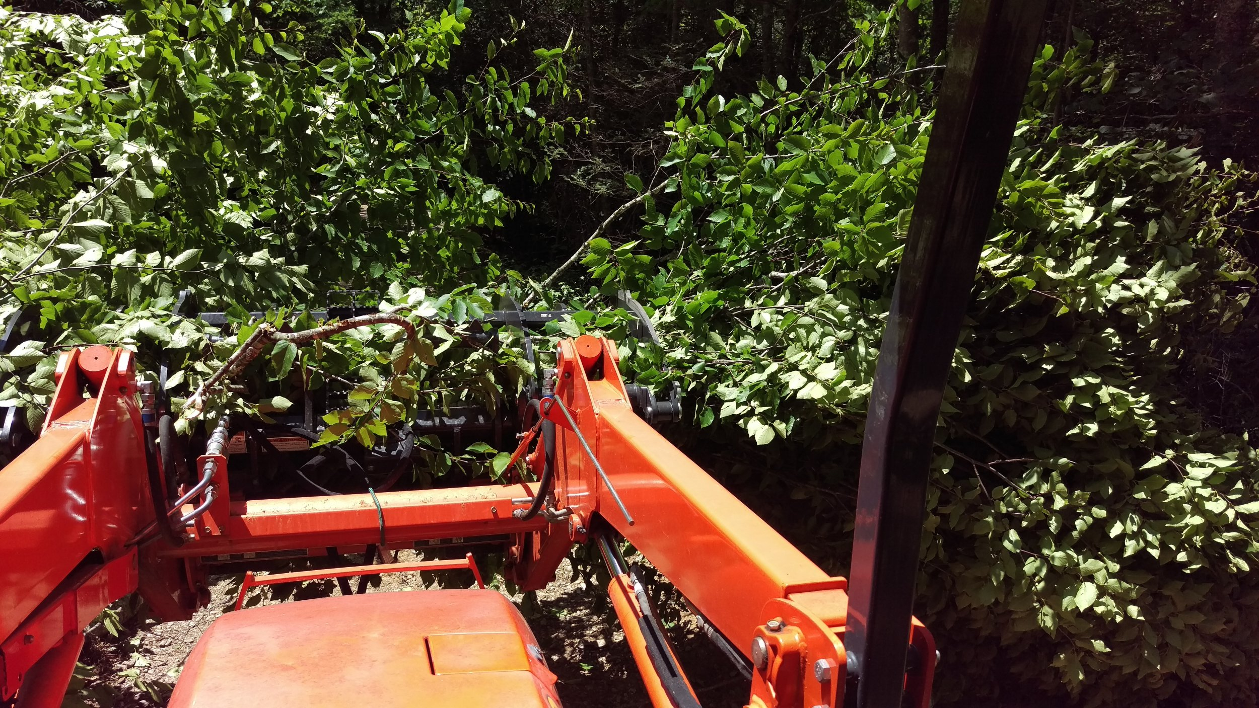

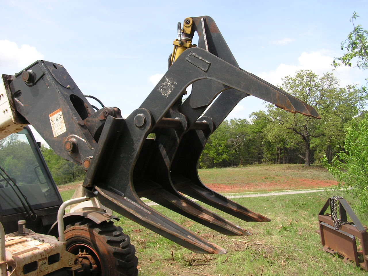

My 2 cents worth having cleared many acres and moved many tons of rock with this 72" Paladin grapple on a 60 hp M59 tractor. Your 73 hp tractor more than capable of using the 72" or larger depending what your machine track width is. Up front cost is a small factor in lifetime cost, especially given the very high current diesel cost. Couple of pics with brush and rock. If you look carefully, you can see the tractor behind the load of brush. I was backing up the driveway to the dump site not driving forward. Also included Paladin grapple specs with 49" wide opening.
Have fun with whatever your choice is.

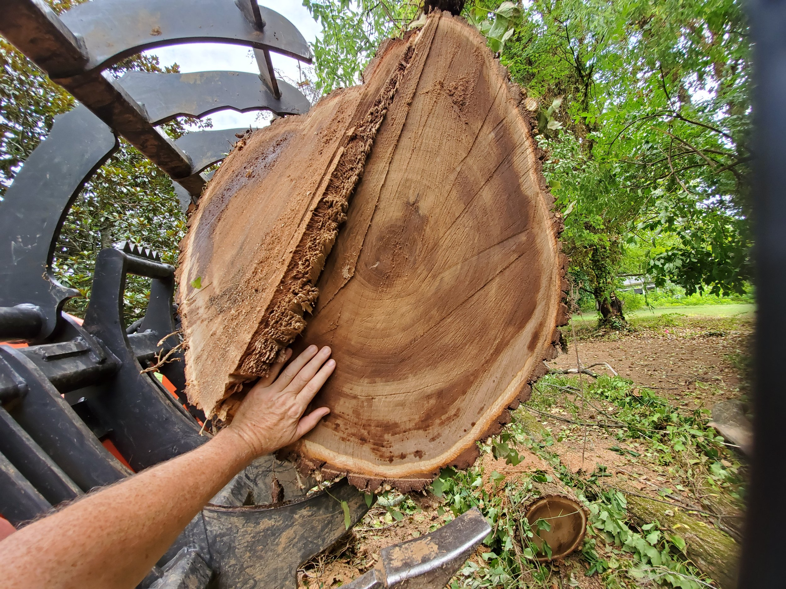

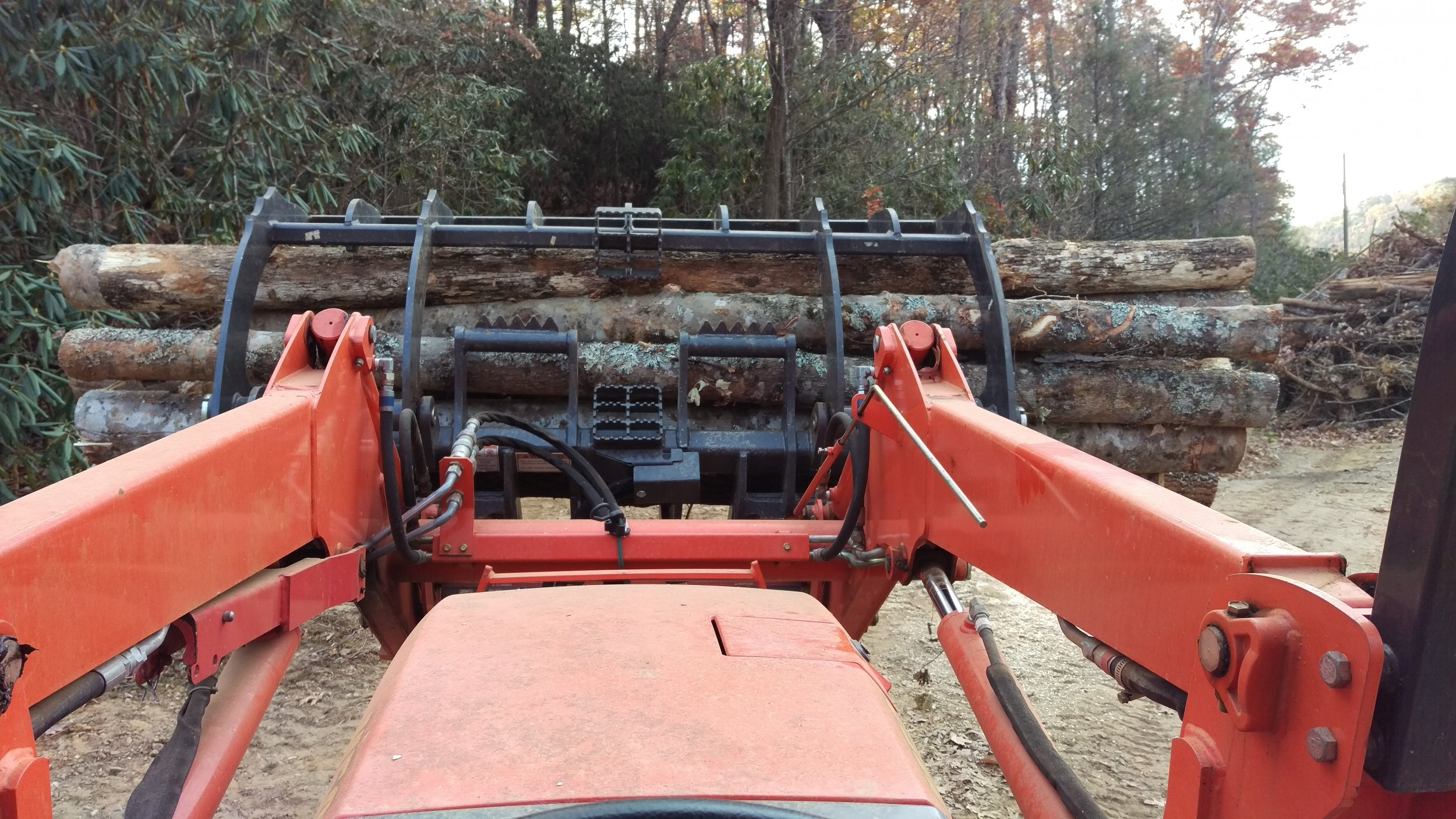

That's the one I am leaning towards since I'll be moving logs fairly often in addition to a decent amount of brush and rocks. With a 60 hp tractor is there any reason why to go with the larger version? Is it because the power of the tractor might damage one made for a lower HP tractor?
Future_vision,

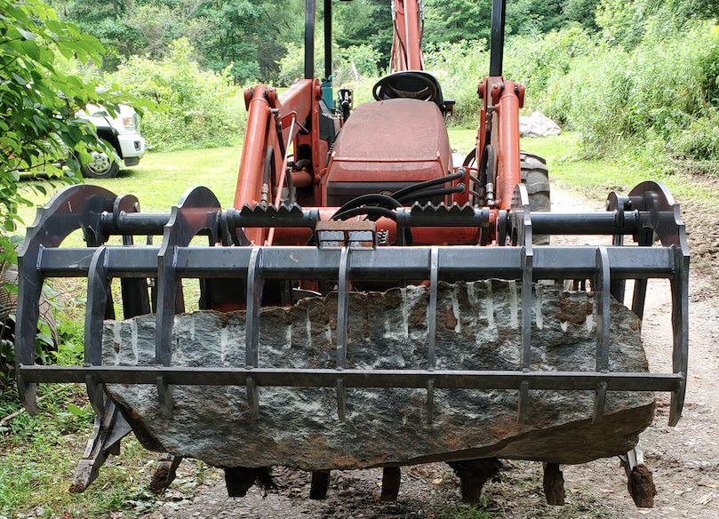

Grapples are rated for several reasons. The primary reason is so someone with a low horsepower tractor does not buy too much grapple that their machine can't lift or if their machine can lift the weight, then with the little remaining weight the machine can lift (rocks or trees) the grapple can't really do much. If I put a light duty grapple rated for 20-30 hp on my 60 hp M59 then I might be able to bend it but the hydraulic over pressure bypasses would probably prevent that. Secondary reason is a higher horsepower machine is typically wider and you want a grapple that is as wide as the machine track.
My Paladin Bradco 72 inch root rake is sized to my machine both in width and lift capacity. The grapple at 72 inch wide is wider than my tire width so the grapple picks up everything in my track. My total loader lift capacity is 4,000 lbs and the grapple weight consumes 1,500 so I can easily pick up 2,500 lbs. It is possible to pick up much more than 2,500 because the bucket curl force is 6,000 lbs thus I can actually pick up 4,500 Lbs. Picking up that much weight can create problems if you are not careful with grade, speed, and turning rate. The wider the grapple opens the bigger the pile you can get a hold of and carry away. In the far right picture I picked up so much brush I couldnt see to drive forward. I actually intended to back up the brush dump site so all good. I have attached few pics of trees and rocks in the grapple.
