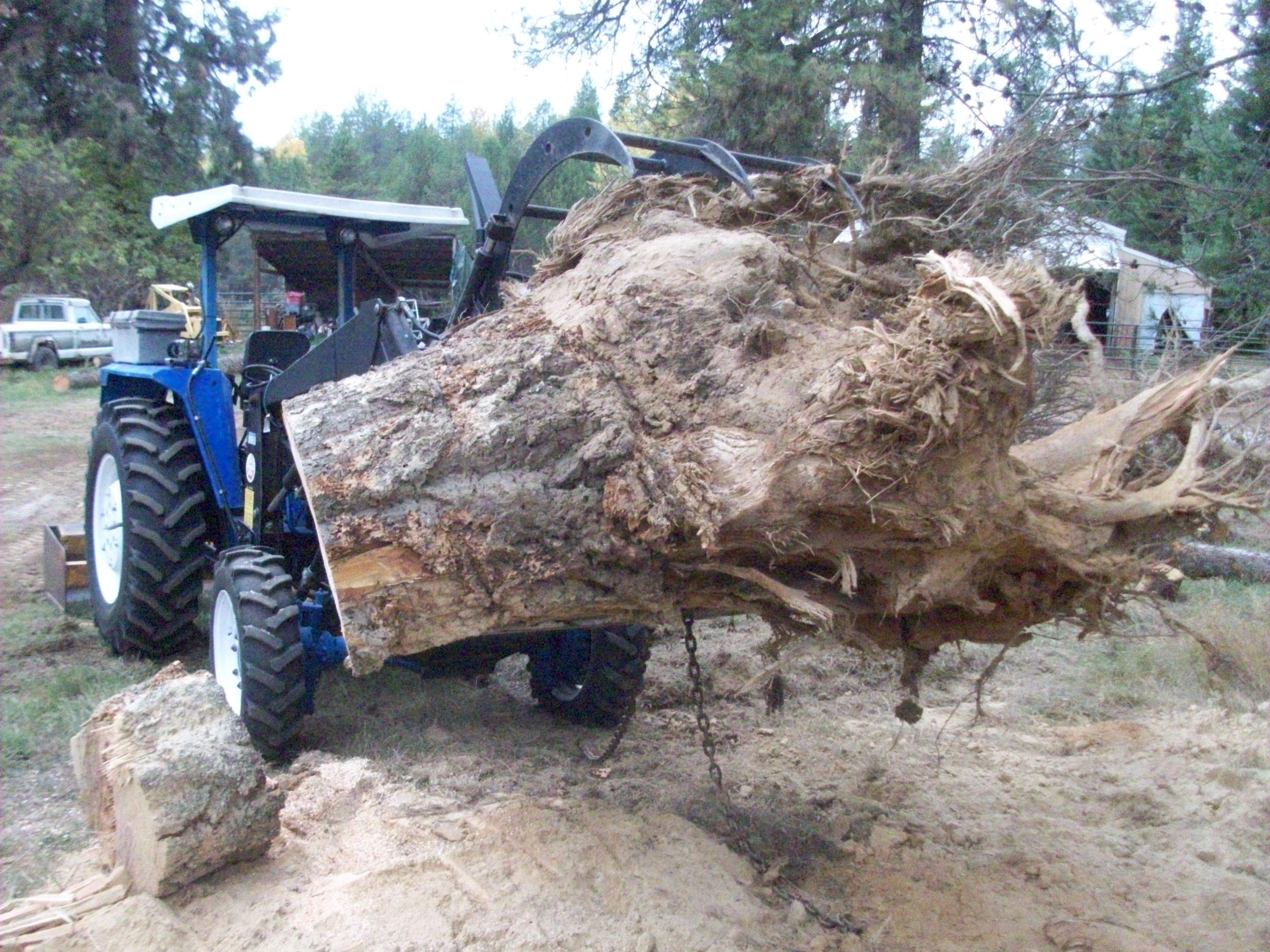

I have a Land Pride SGC1560 grapple on my Kubota M6040. Also the WR Long 3rd function valving. All was installed by my Kubota dealer. It's neither light nor cheap. Sadly - I found that light and cheap implements die quickly. And I'm very careful with my implements.
I only mention all of this because Land Pride and WR Long have been excellent - in my experience.
I move BIG rocks and LARGE chunks of pine tree trunks. I use what I call - "the knuckle dragging" technique. Loads are kept VERY low when lifted and moved. So low that most times the lower portion of the grapple will leave drag marks in the dirt.

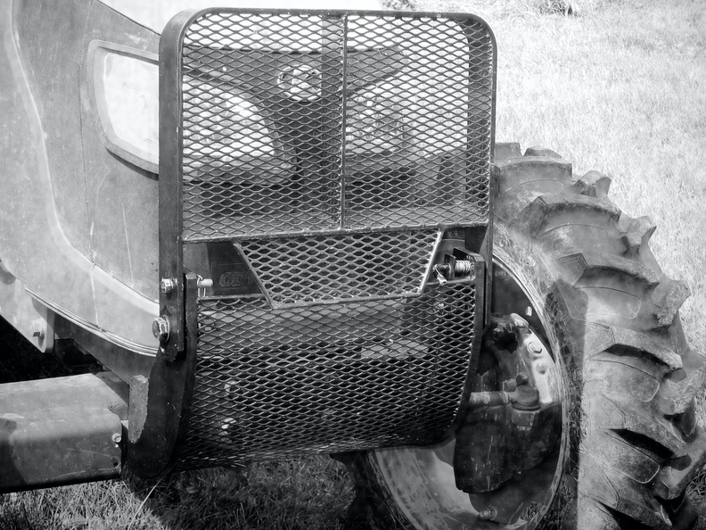

You should also consider mods to your grill guard - my second picture.

Root Cause - specs on many implements are like hen's teeth. Another easy comparison - divide the weight by the width. I bought the Land Pride because it is a root and rock grapple AND is sold by the local Kubota dealer.
At 820# - yes, it is heavy. This model is made for a skid steer. I've had it for nine years now. Only damage - loss of paint on some of the tines. However - I'm still able to lift 3000+ pounds and move CAREFULLY.
How much you will be able to lift - keep it low and you will lift a lot more than indicated in their normal specs. Look at the weight lift charts for your FEL. You could be pleasently surprised.

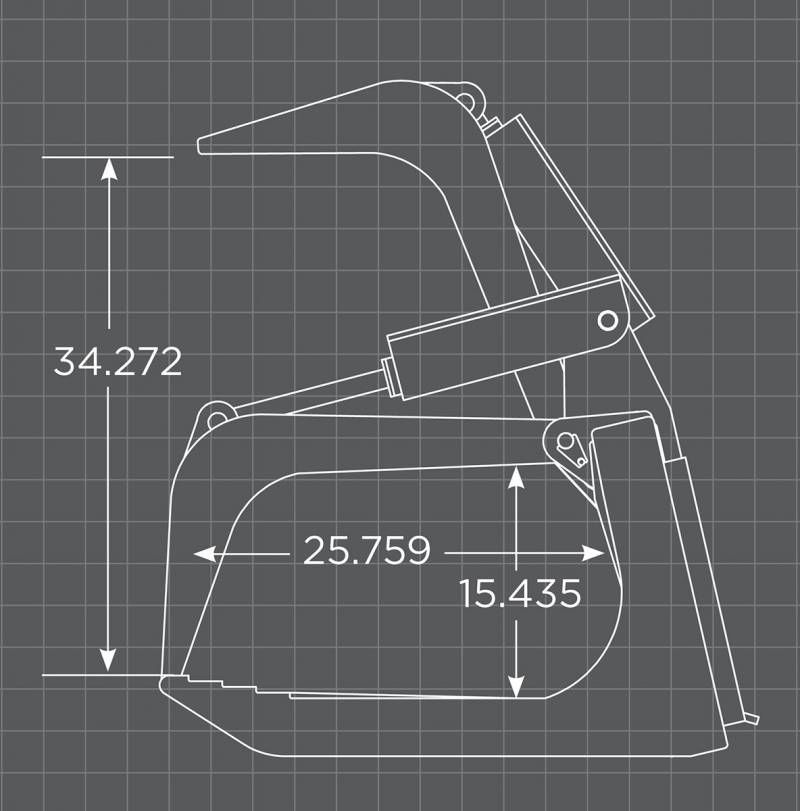

I am a fan of open tine Grapples, Also trying to maximize the Grapples opening distance if possible like Xfaxman shows in the linked diagram

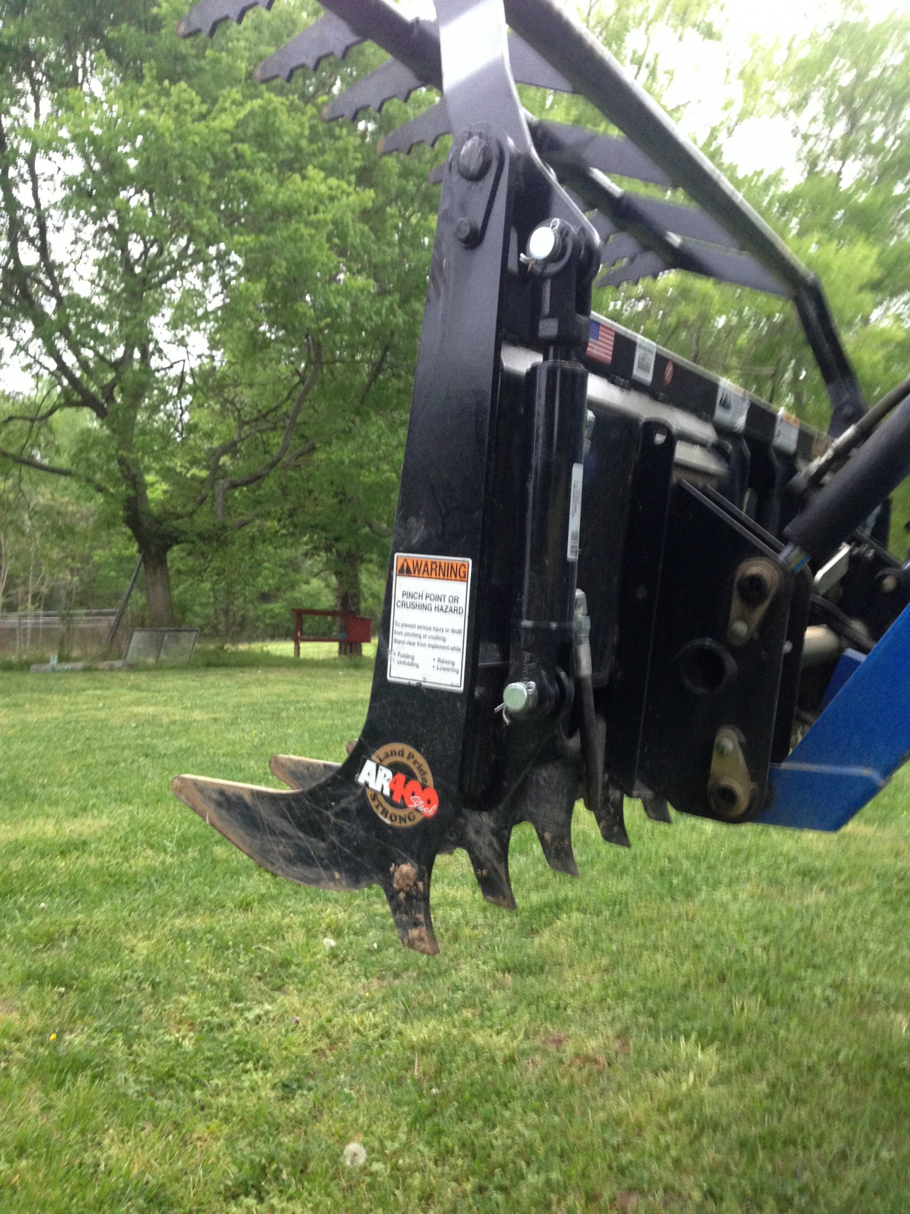

My Land Pride grapple is 60" wide. Just very near the same width as the front tires on the M6040. I don't have much brush to fool with so 60" is more than adequate. When dealing with big rocks and tree trunks - width is of little concern. My grapple is constructed of AR400 steel - if that makes any difference. I know I DO NOT like the powder coat paint used on the grapple. It flakes off the tine tips pretty easy. I spray the tips with rattle can and it keeps any rust at bay.
