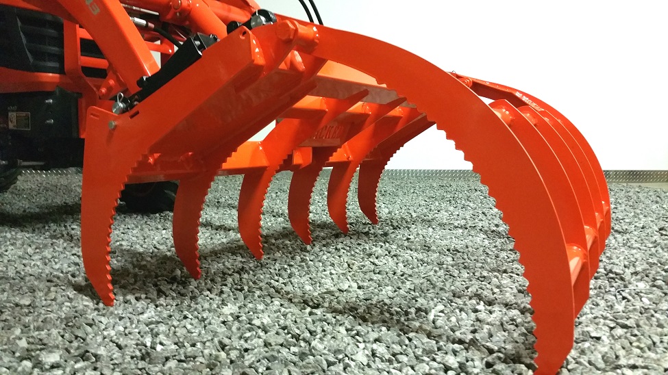

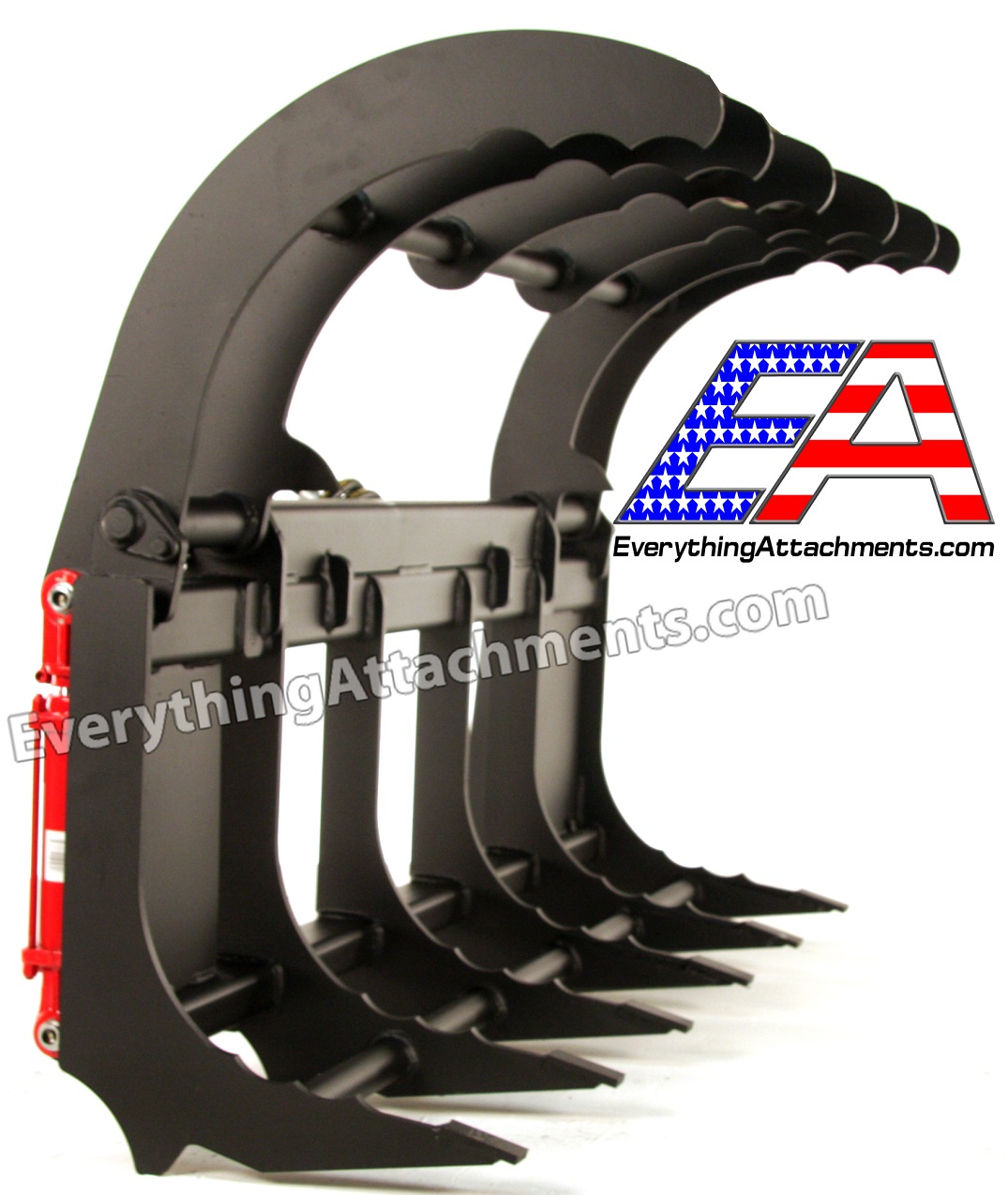

Root Rake Style:
The dozer-like tine geometry of the rake style promotes a tractor's ability to push the tines through the ground with ease.
The root rake style allows you to pull brush, vines and other debris backwards, which isn't recommended with many long bottom grapples. Besides pulling backwards, you can also pull down. Reach up and snap a limb off the tree if you feel like it. The root rake style will easier "unload", so you can hover over the trailer, dumpster, pile, etc., open it up and whatever you've captured is gone!

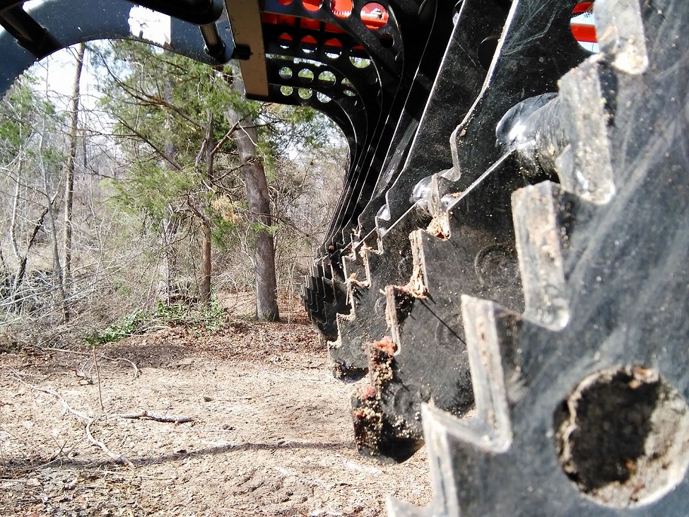

The serrated upper and lower tines will hold the load and greasable pivot points are a must! We even added the bolt in runners like our 55 has!

Our 200 pound Wicked 55 rake style grapple has been amazingly popular and effective on subcompact and small compact tractors under 40 horsepower. It really ups a tractor's ability if it is starving for lift capacity.
Wicked 55 Root Rake Grapple for tractors under 40HP

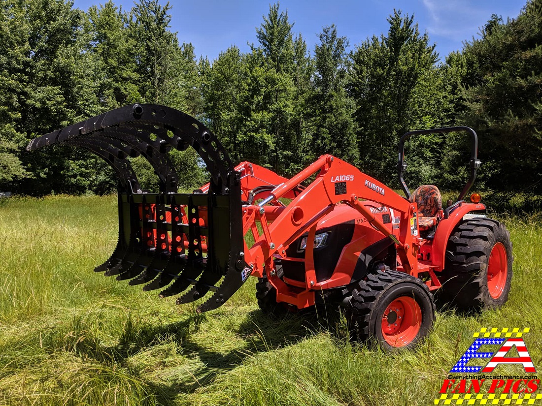

If you love the 55, but need heavier due to tractor size, our new Wicked 60 rake style grapple is it's juiced up bro. It is a 400 pound versatile brute unlike any other rake style grapple on the market.
3/8" AR400 construction and an added 3rd lid hinge makes it VERY rigid and capable!
Wicked 60 Root Rake Grapple for 35-65+HP Tractors

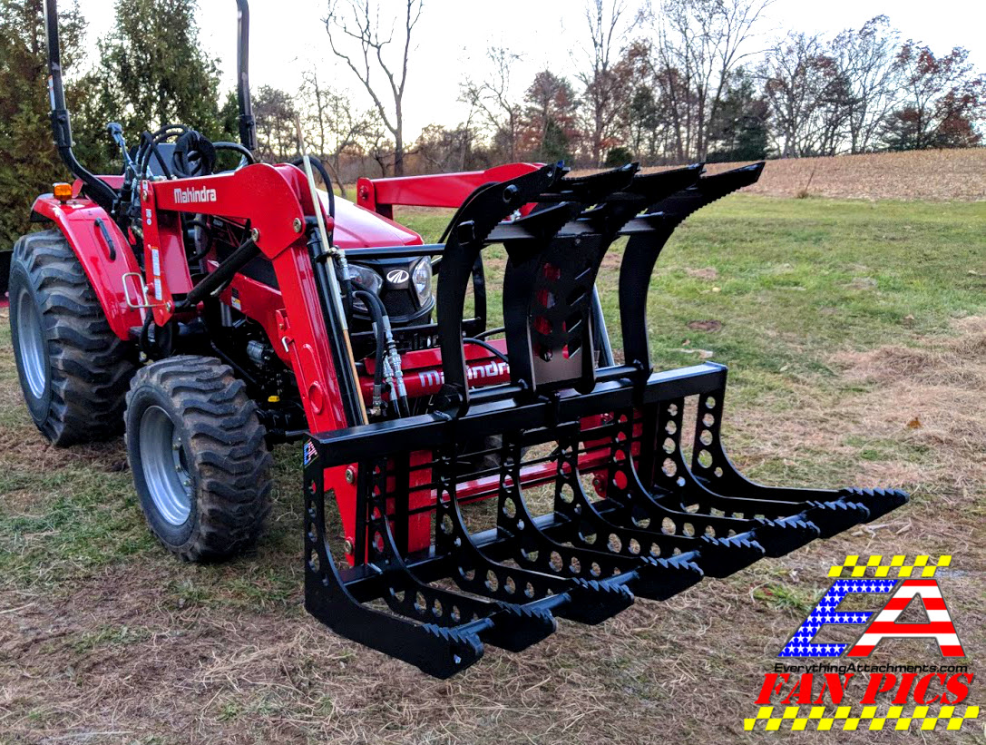

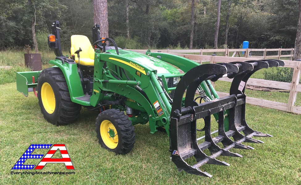

I didn't have any action pics of our newest rake style Wicked 60 at the time, so I'll add them.
We're recommending the 400 pound range Wicked 60 for compact tractors. For larger machines, we have a brand new 66", 600 pound range Wicked rake style on the horizon!

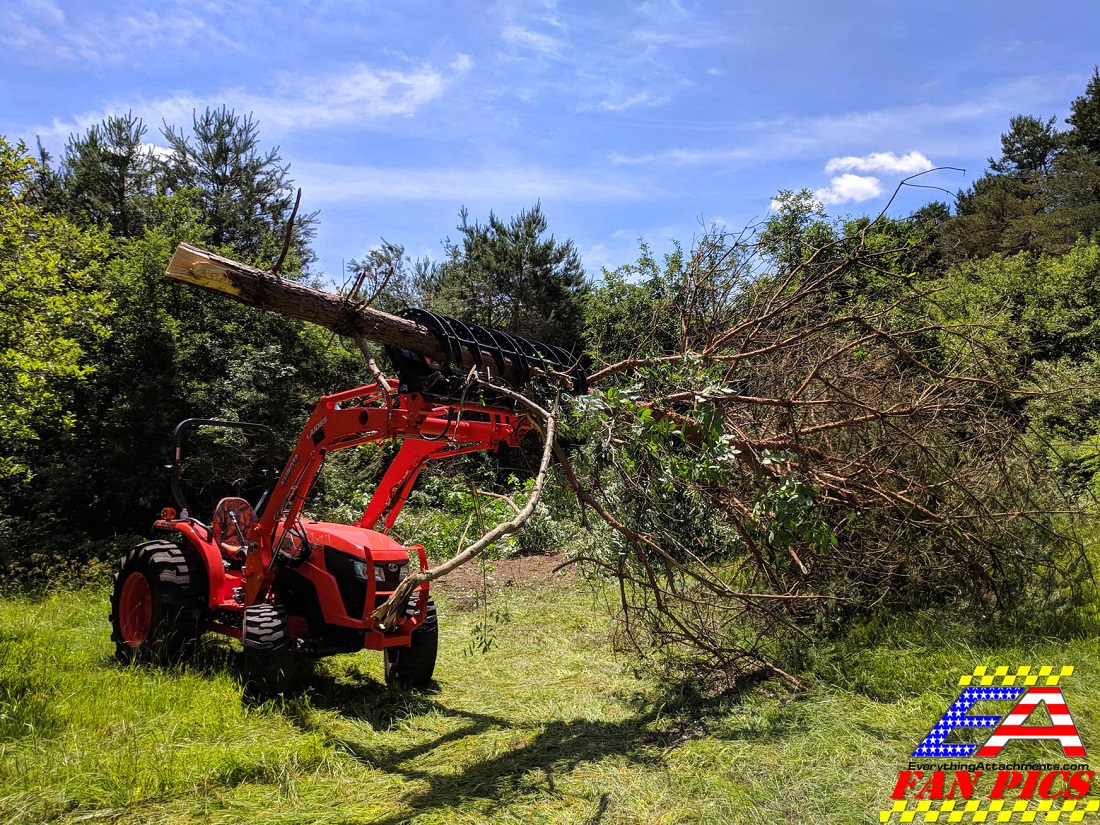

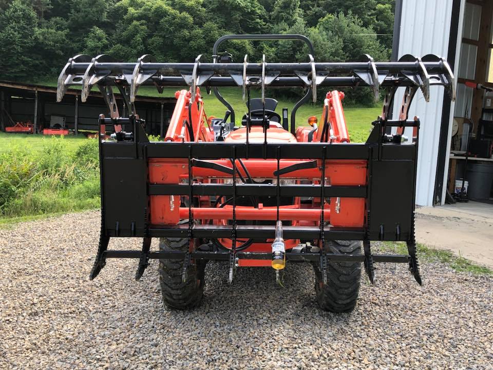

While I'm on the rake style, I'll show off the versatility.
Sure, any grapple should pick up a simple log. Wicked 55 rake style on a Case DX40.

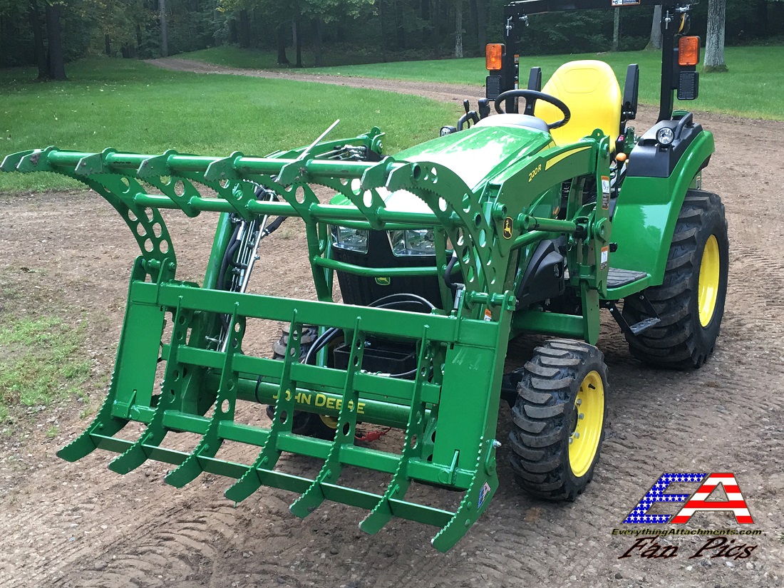

Not many will allow a subcompact to pick up a log like this subcompact John Deere 1025R with our Wicked 55.
Multiple logs have proven not to be a problem, as shown with Joe's Deere 2038R.
:eek:
Or with this Kioti CK35.

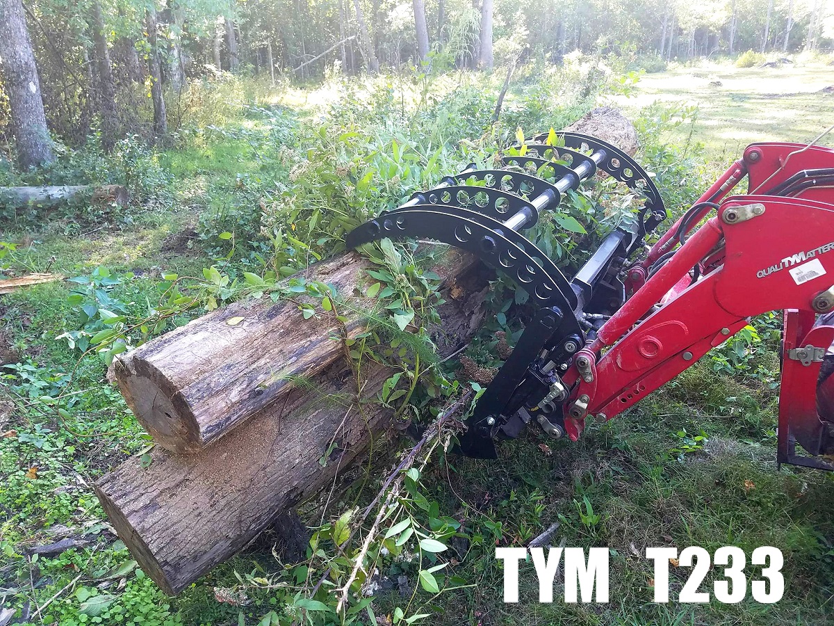

Or the TYM T233.

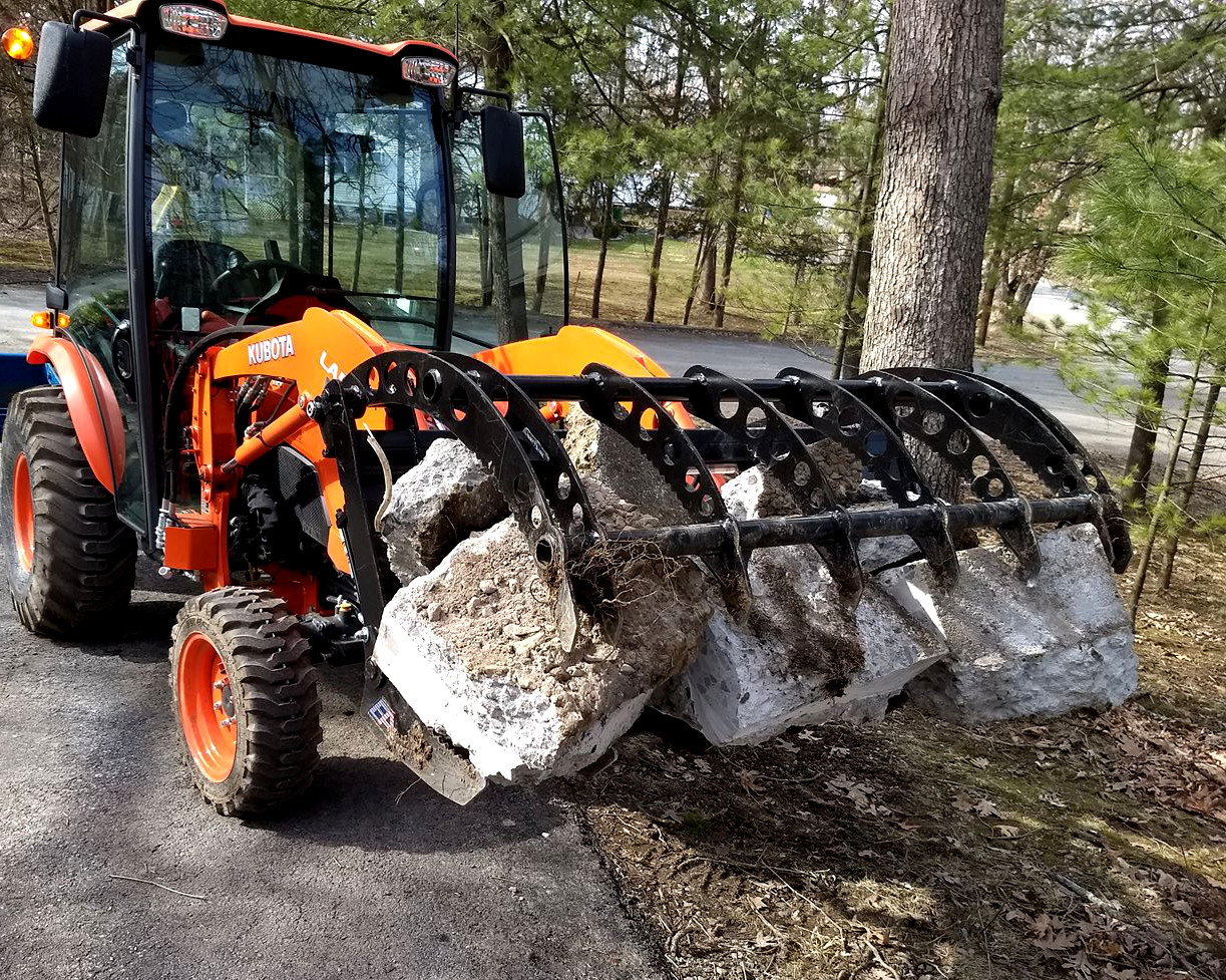

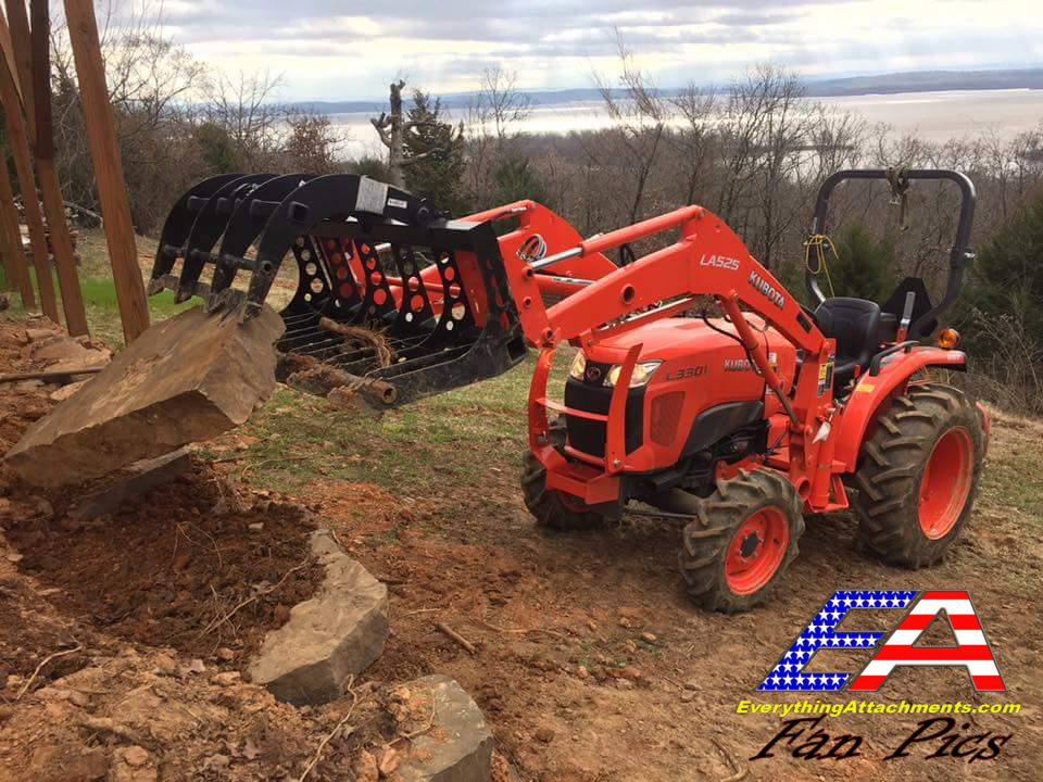

Large rocks? Check.
I didn't even realize it's ability to pick up multiple rocks, as this B2650 is showing off. Again, this is a B SERIES, guys!!
My customers have proven to me that the cradling ability of a long bottom grapple isn't totally necessary to pick up large objects. Here's another subcompact/small compact Mahindra MAX showing off a maximized lifting ability!

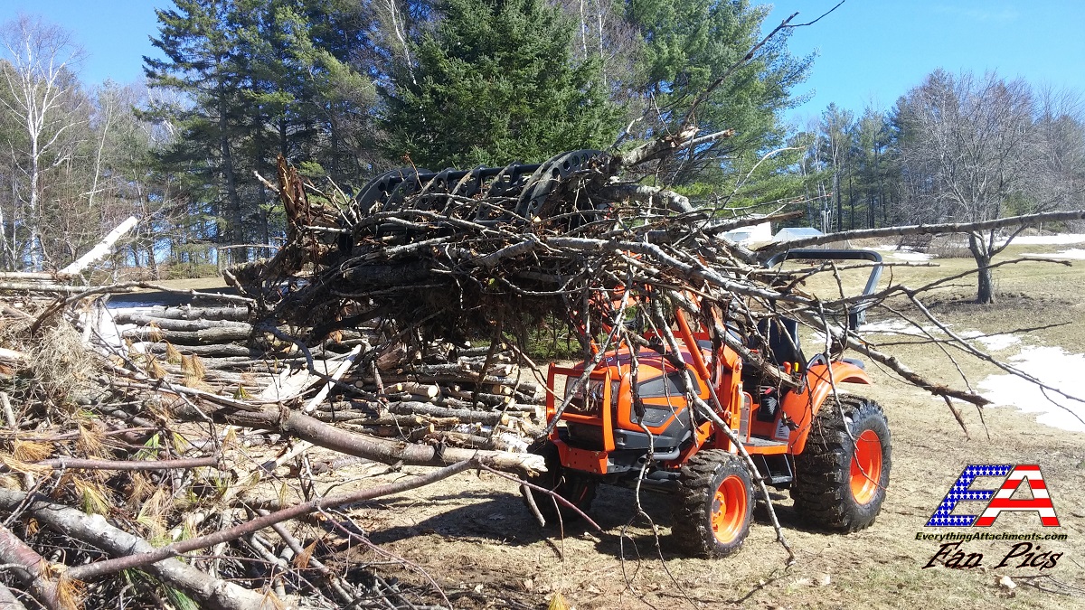

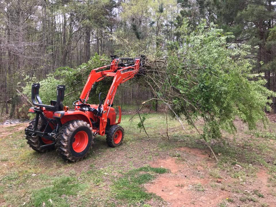

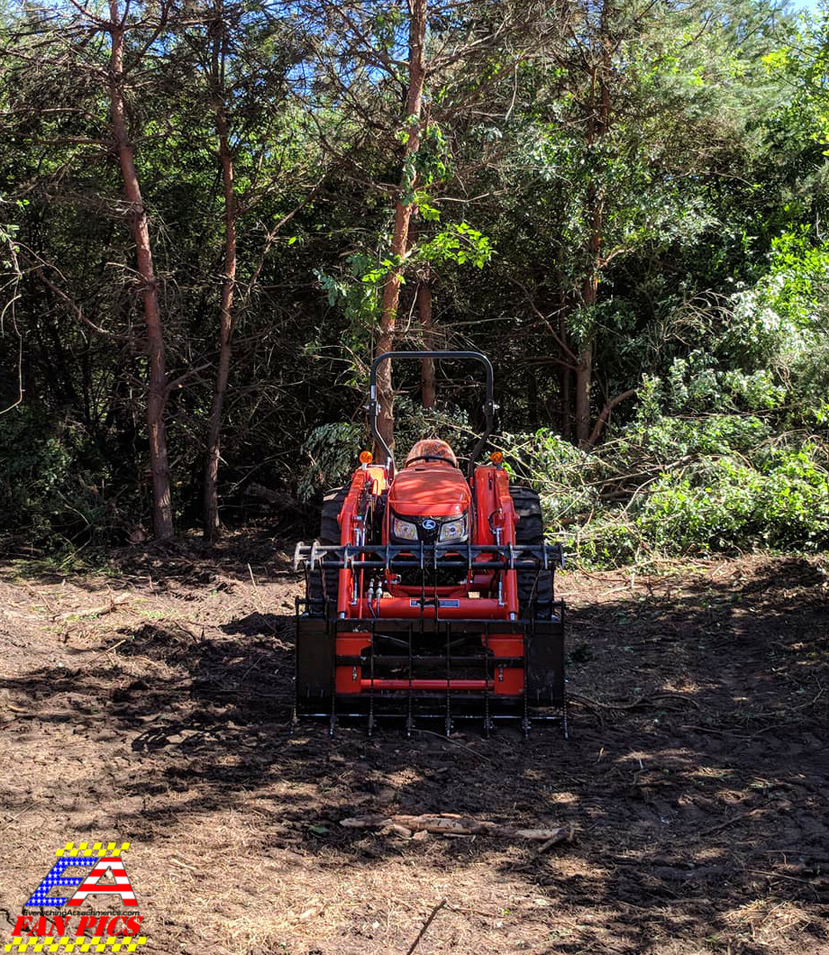

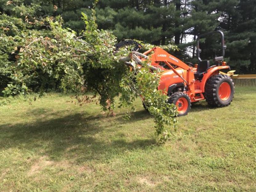

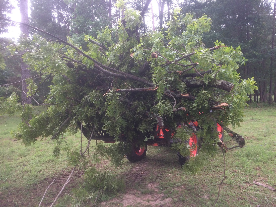

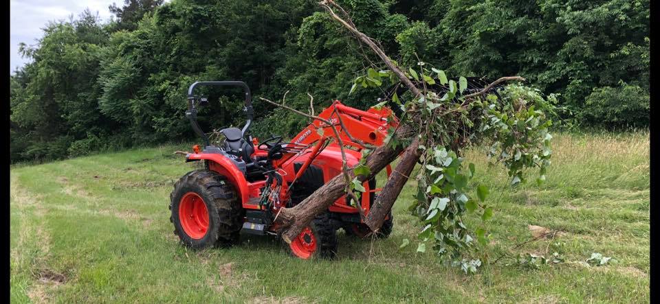

Finally...Brush? This Kubota L2501 says YES, Please.
Kioti CK35 agrees!
I tend to get a little carried away with pics, but, seriously, what other manufacturer/dealer on the Planet has access to such awesome depictions of their product??

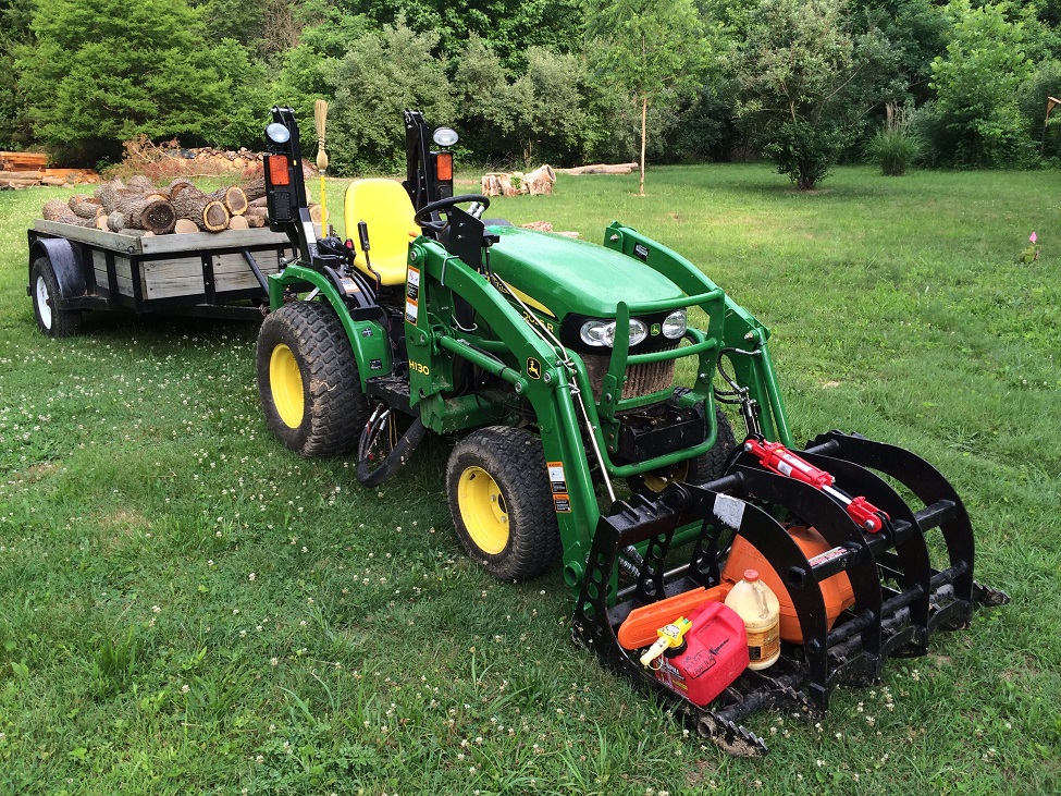

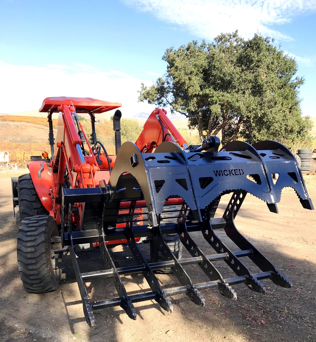

The Original Long Bottom Wicked Grapple IS capable of some things I can't see a rake style doing as efficiently...
John Deere 2520R transporting the chainsaw with a Wicked 50.
Kubota B2620 reaching further below grade to grab some pesky rubbish with the Wicked 50.
Kubota L3301 hoisting shingles and a ladder with a Wicked 50.
John Deere 2025R with neatly stacked firewood on the Wicked 50.

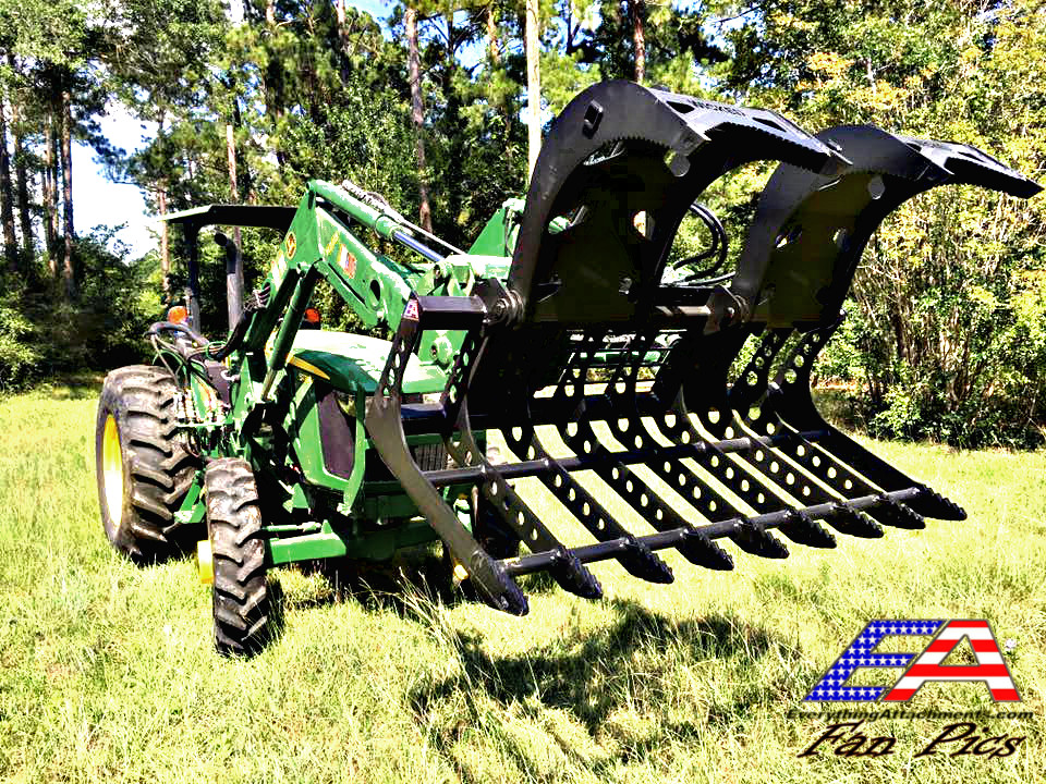

John Deere 3046R with a larger firewood collection on the 60" Single Lid Wicked.

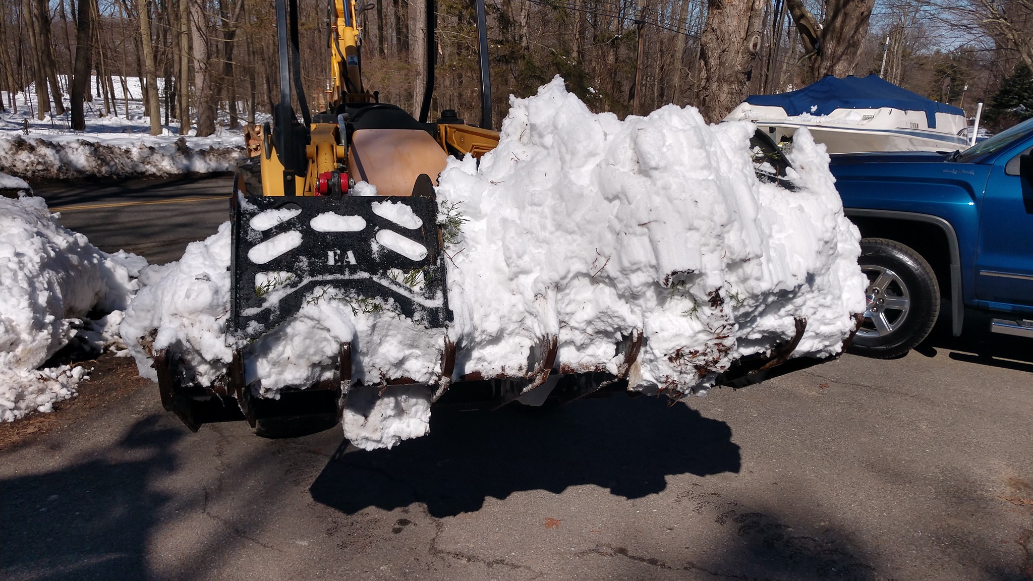

You can probably get a bigger bite of snow with one, as this Deere 110 has captured with a Dual Lid Wicked 60.

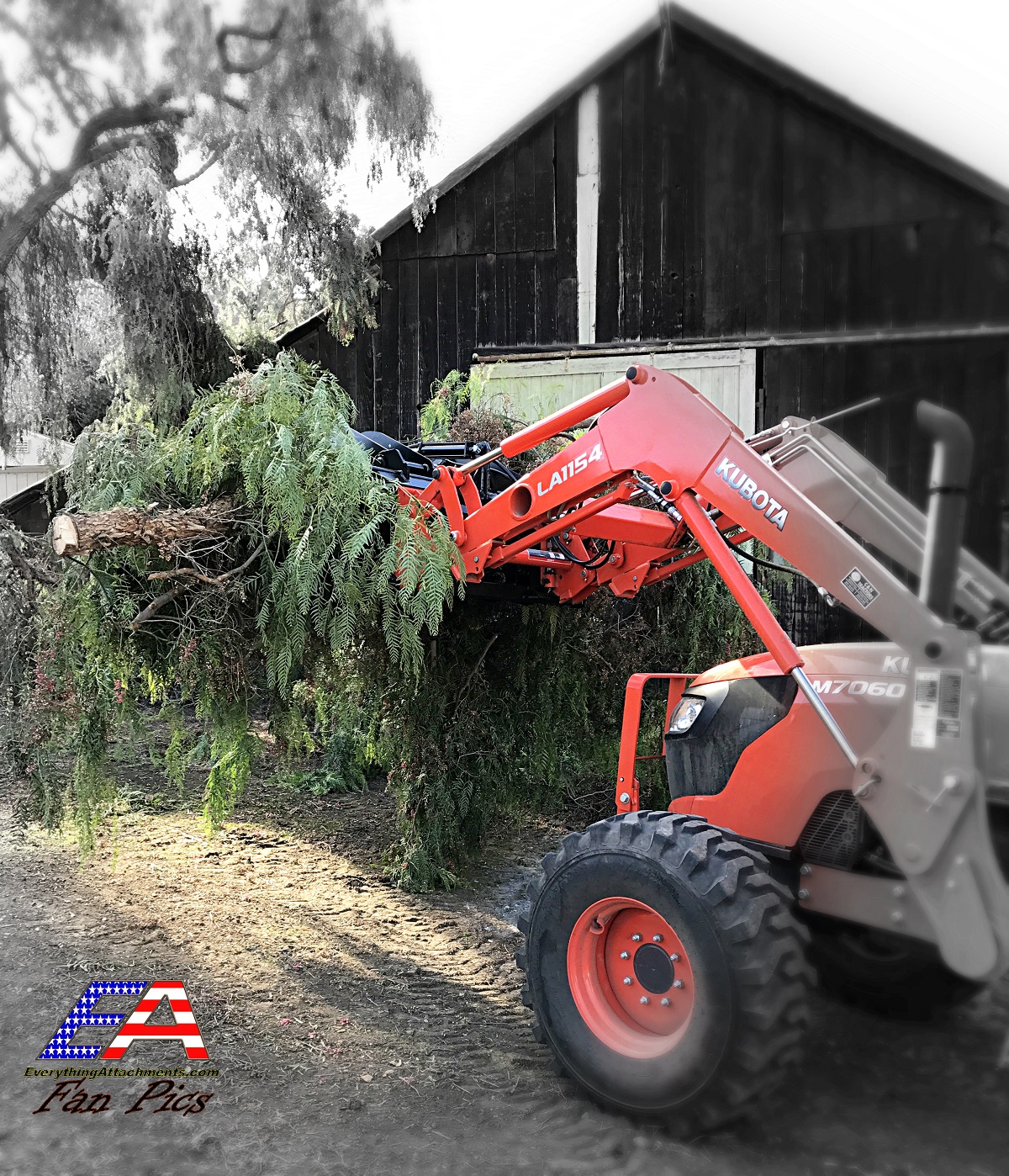

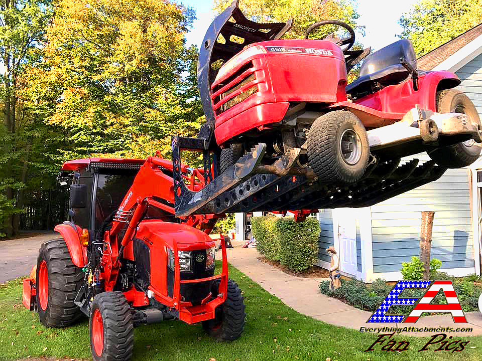

Kubota L6060 lawnmower transport with a 73" Dual Lid Wicked for large compact and utility tractors! :shocked:
Kubota M7060 showing off the tractor hiding, brush moving capacity advantage with a 73" Dual Lid Wicked for large compact and utility tractors!!

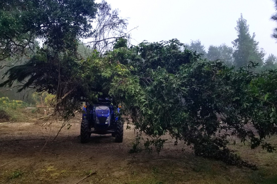

New Holland T4.75 doing the same!!!

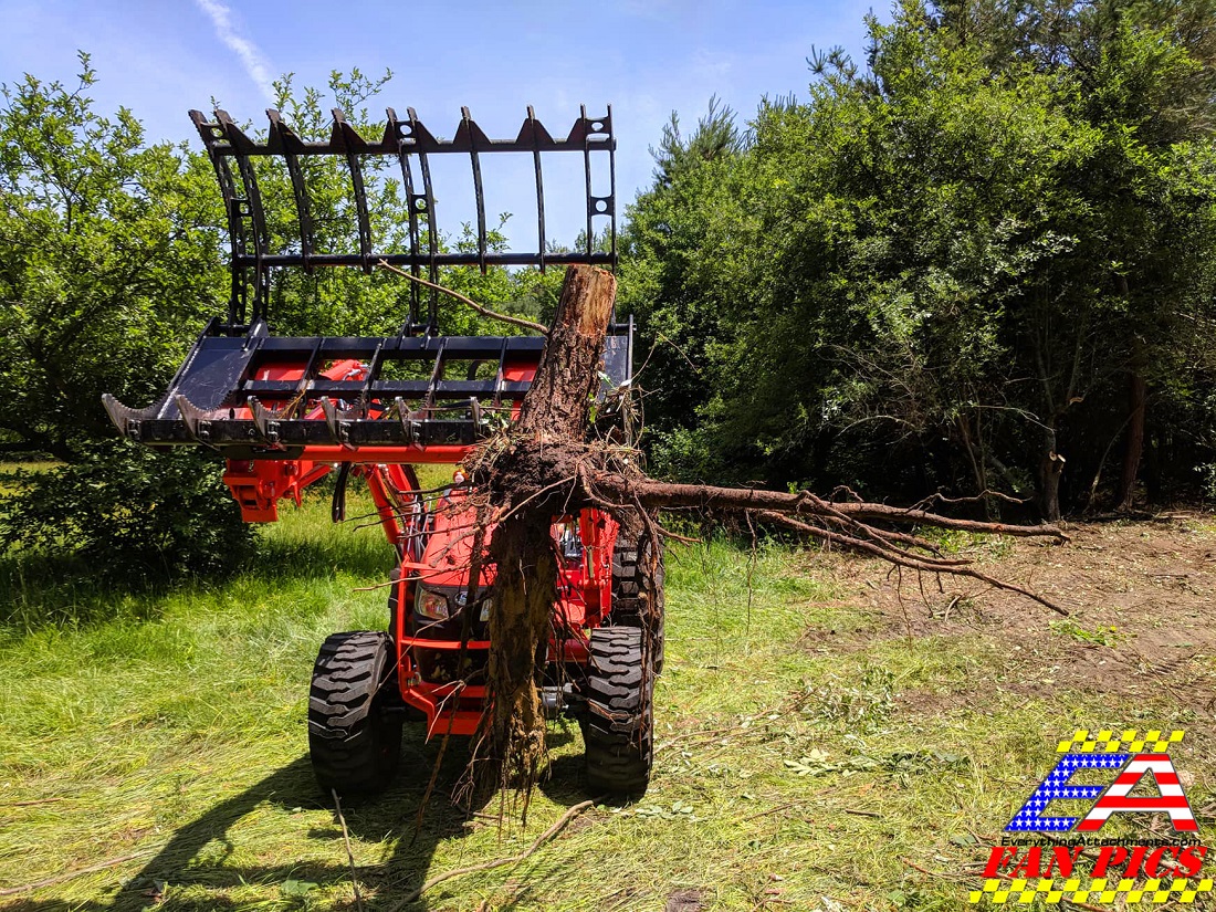

This 400 pound Wicked 60 rake style grapple is really showing off.
Ultra Strong. Incredibly Lightweight. Load is close. Amazing happens!
Here's what Richard, the MX5800 & Wicked owner from Michigan has to say about these pics:
"Didn't have anything better to do so I looked for the biggest stump I could find. Fragile this thing IS NOT!!! Thank you EA! Merica :united-states:
When I started to get off the tractor the first time (to take pics) it started to teeter forward. I had to regrip it & shake some of the dirt out! It's all of 1,500 pounds & the tree was cut down a week ago so the stump still has a lot of moisture in it."
This is 58 horsepower, but, like our L6060, the Kioti NX series, the Deere 4000 series..... They are STILL compact tractors!
All of this with only a landscape rake for ballast. :eek:
