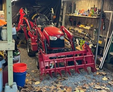

Since my Kioti is a little bigger and heavier (5500 lbs), I wondered if a grapple specifically designed for a sub-compact might not go the distance.
4500 with loader and backhoe?
Its not the weight of the whole machine that comes into question. It’s the ability of the loader itself. You can put a ssqa 84” skidsteer grapple on your kioti. How productive would it be for your needs? I have been looking at the Stinger compact grapple and they have a couple of nice features. As far as durable….

I have CTL and a grapple but I would not even to attempt to dig a stump out with it. You will certainly tear something up if you try. I have a stump bucket for the CTL and it will dig out stumps but it still is rough going. I also have a 25hp compact tractor and wouldn't try to dig out stumps with it. A grapple on your tractor is a great tool and will save a lot of work for you. but it will not dig out stumps.
There are some 3pt attachments that will help digging out roots. They look similar to a sub-soiler with a long shank but, with a sharpened edge. You have a lot of money invested in your tractor, trying to use the wrong tool for the job will only cost you money.
Best of luck! RB
   / Wicked 55 root rake grapple on a 25HP compact? #27
I have a VERY HD Land Pride grapple on my Kubota M6040. I DO NOT use it to rip out stumps. It's very simple. The grapple is not designed to rip out stumps. The FEL on my M6040 is not designed to take this type of loading.
It's best that you learn the limitations of your implements. OR have bottomless pockets.

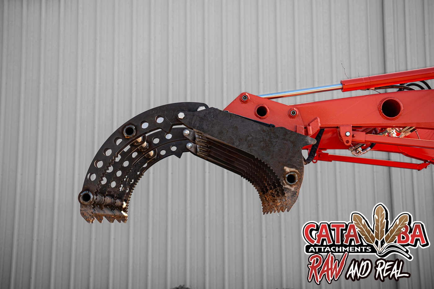

Catawba attachments has a wicked 55 clone that is maybe 50 lb heavier. Same "free shipping" deal, $2600.
Good: they have a few in stock.
Bad: as soon as I post this, they will sell those and be backordered for 4 months by the time I get my $3k back on my CC.
:cry: :ROFLMAO:
They are 8 miles from EA. Speculation: EA NOS or seconds/rejects? Is Ted C is working with them?
Catawba 55 Rake Grapple

Hey Darryl,
I saw this post and figured I would chime in to clear everything up! We are definitely no way related to EA other than location. Lets just say, that EA name does not have the best reputation locally and I am sure you can guess why. We have ramped up to be sure we stay up to date on keeping up with orders and keeping stock availible!
I believe you ended up snagging one so hopefully you are putting it to work and enjoying the purchase!
