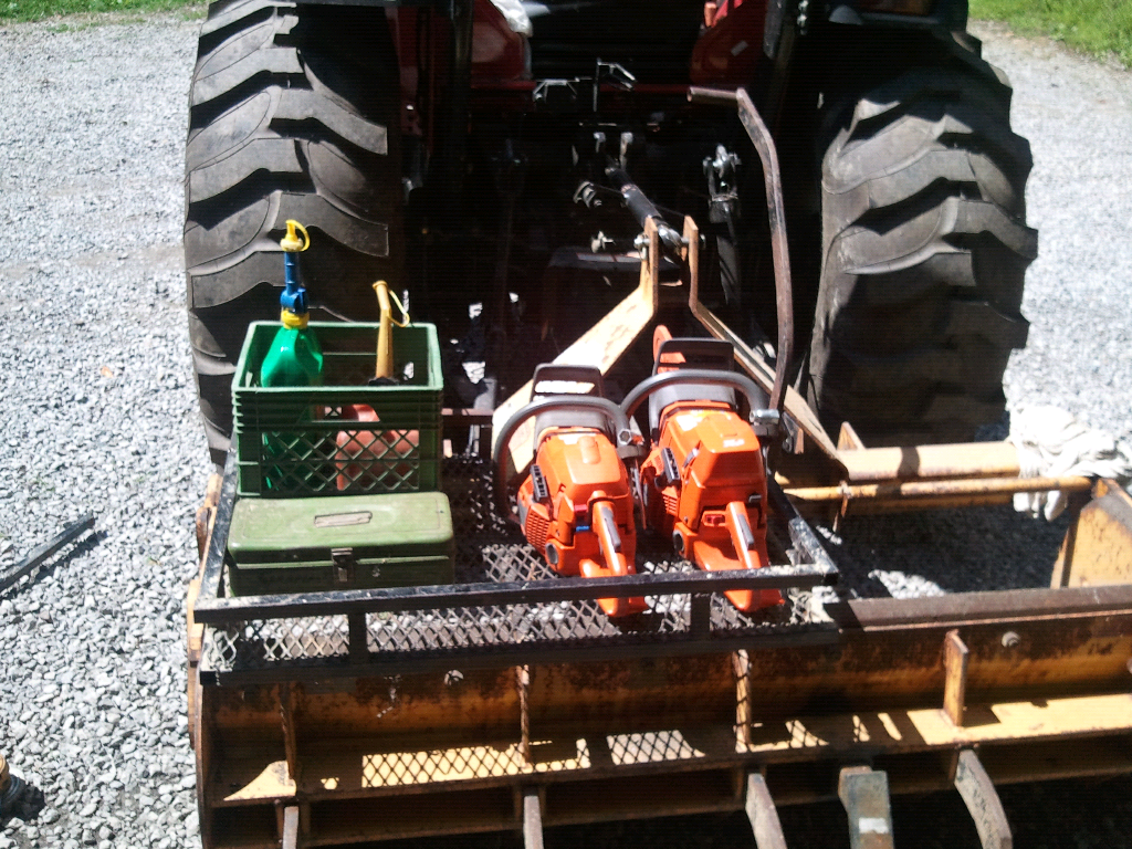

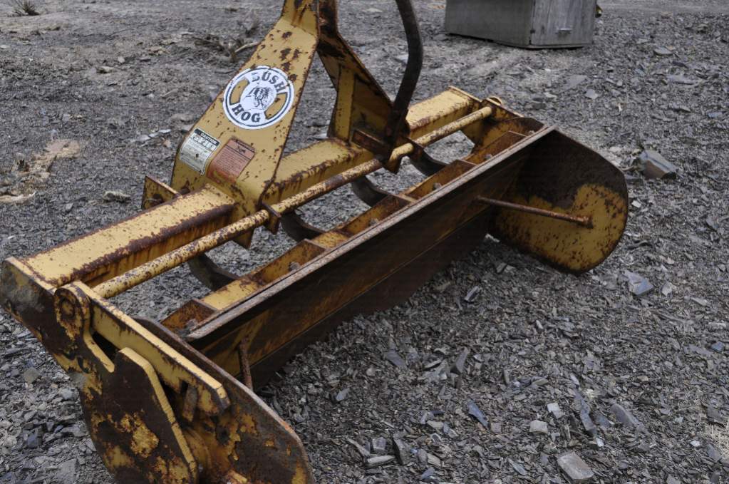

Most of the time dealers don't mind putting the 'little stuff' online. I found one at one of my local dealers that I was going to get if my 110 hadn't came with a box blade. I'll attach some photos of it, I never inquired about a price. I took the pics probably a month and a half ago, but I was there two weeks ago and it was still there. They are an old JD dealer that got bought out by a chain. Still a very large dealership, but only sell used. Prices are usually veru good. The Box Blade is actually "Nolan's" branded, which is the name of the dealership. (M Nolan Farms now if you want to look them up)
Martian - looks interesting! Wonder who makes Nolan.....maybe Befco?
I do like the color.....:laughing:
They didn't have it listed on their TH site. I just sent them an email....thanks for the tip!!
