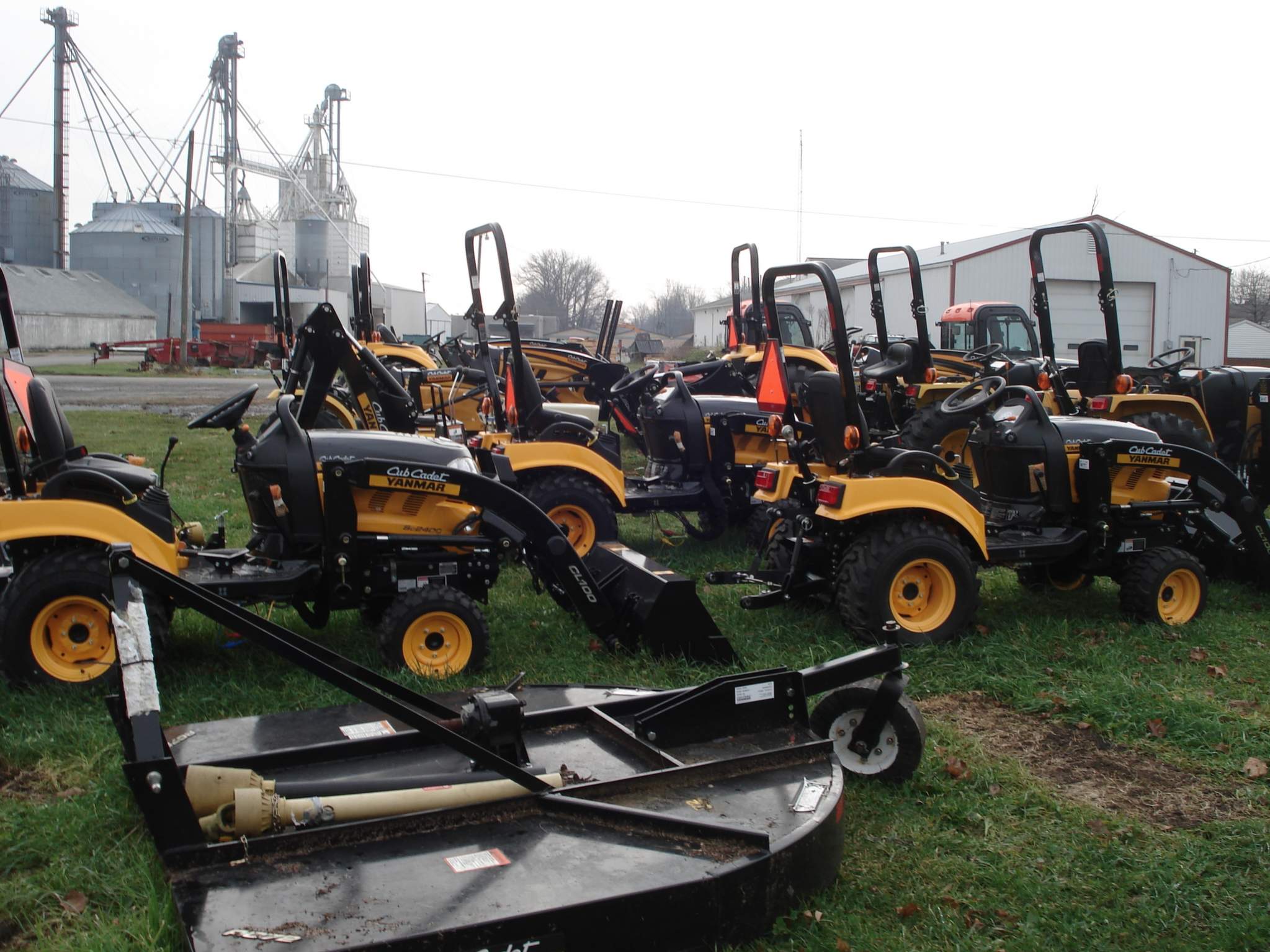

Seems like a good list to shop from. I did also purchase a 72" rotary mower with my new tractor, which Yanmar gets from Befco. Picture attached as per TBN rules. The one thing my dealer told me about Befco is their prices are very high, fortunately I got this new mower for a VERY reduced price....I'll tell you if you ask but am embarassed to say it now....:laughing:
