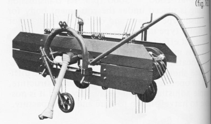

Have been watching this thread with interest. Been many yrs since I had a small custom haying operation. My experience is dated but may be of help anyway.
For a mower I used a Heston PT7, a sickle bar design mower conditioner. The new MF/Heston sickle bar model look similar. Takes a lot less power for these over one of the rotary models that are common today. The mower came with 2 sprockets for adj the reel speed. With the higher reel speed I could mow at about 5 mph. Tractor and reel speed have to be matched to max speed and min power needs. Too fast or too slow ground speed for the reel would make BIG impact on needed power and qlty of cut. My MF65D had more than enough power for this mower. Had a 2nd sickle I kept with new sickle sections. Don't think I had to use more than 2 sets of sections a yr. Stub guards were a must to keep from having the sickle get plugged up at times. In this area 1st cutting is always a crap shoot weather wise and could find myself cutting anything including clover (as tall and heavy stemed as alfalfa) which was common in this area. A mower conditioner was a must.
For rakes, on 1st cutting and either alfalfa or clover, a conventional side delivery rake was disaster as they would rope the cutting and make drying almost impossible. I had 2 rakes, a 2 row, 4 rotor tedder and a "conventional" rake made by Madds-Amby, which was a design that swept the hay straight sideways without twisting. It could also serve as a tedder if the side forks were left off (see pic for a sim design). Most of the time the tedder never had to come off the trailer. With the Madds design I've taken hay that had been rained on and was flat as a board. Made a single pass and had windrows standing 2-3 ft high.
For a baler, I had a new JD sq baler with the hyd chute squeeze to help maintain consistent bail weight. Sq bales are still king in this area. Didn't care for the JD baler and had lots of problems. When working well, it could push a lot of hay out the back.
1st cutting was typ a 4 day affair to get the cutting dry enough to bale. My std service was cut, turned the rows mid-day on 3rd day and baled on 4th day after morning dew had dried off. If weather didn't cooperate, more effort and time was needed. I also had a moisture meter to help with judging dryness. If the weather gods weren't cooperating I also had a sprayer on the baler I could spray the hay and mixture prevent spoilage from baling in otherwise too wet of a condition (think the stuff was called Hay Saver). First customer I had to use the spray on took some to the local fair and walked away with a blue ribbon. Someone asked about how much can you bale in a day, one day I bailed 40T spread between 3 customers. That was with an older baler, wire, and it was giving me fits on the first field. With the New JD baler I was spiting out a 50# bail about every 10-12 strokes (80 strokes/min @ rate pto speed) on a decent yielding 1st cutting. Typ yields around here are about 4T acre.
One more thing, I always took a weather radio with me, let the customer listen to the forecast and let them make the decision whether to cut or not. I did try and limit the amount of hay being down so I felt good about being able to get it bailed if the weather started turning for the worse.
Hope there was some useful info in my ramblings.
