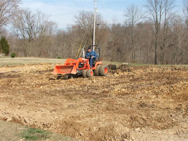

My wheels wouldn't adjust out wide enough so I fixed 'em.
