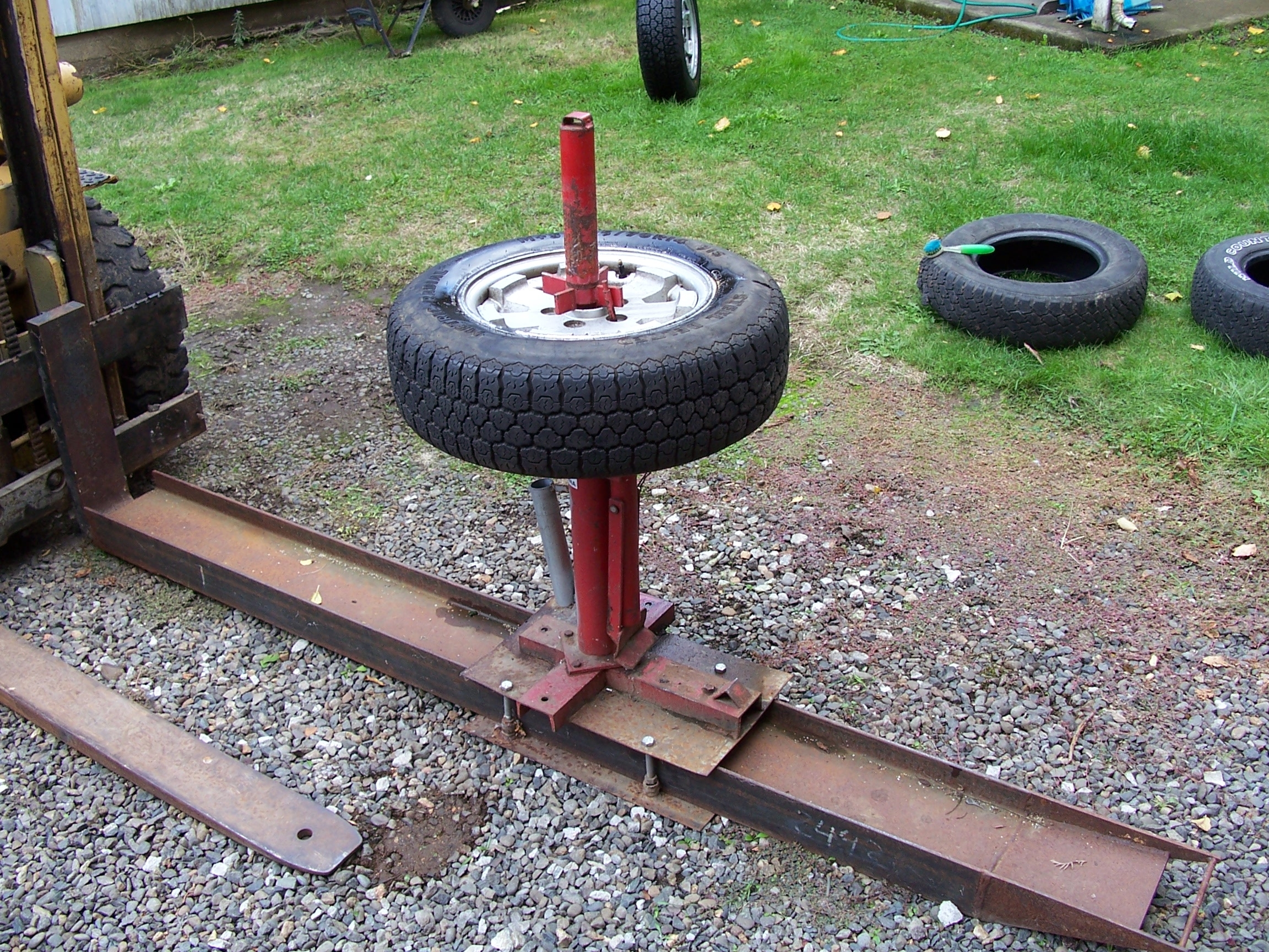

A permanent mount where you can get all around it would eat up too much floor space, so I made a quick slide on base for one of my fork extensions. Doesn't take long to set up, is solid enough to use easily and tucks away in little space when not in use, which of course is most of the time.
View attachment 3839603View attachment 3839603
I did that with mine at first, then put in some concrete anchors. Just find them, blow them out when ready to use it.
