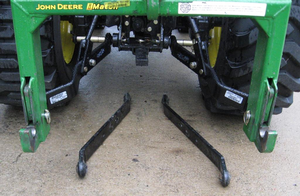

I haven't done a lot of research on the speeco but there is a possibility that the hitch is the issue and not the implements. I think the only hitch I've read that doesn't need modified is the landpride and deer.
From my reading about these, it isn't typically the QH, it's the older implements, because except for the very earliest of the HF QH's, they meet the QH standard specification measurements.
Mine was bought new in 2011 and typical of the the newer ones, it fit all the QH spec sheet measurements.
However, all my implements were older, even the ballast box we got new with our 2011 B2320, and they all needed modification.
Having done them though, I love the ease it has given me in exchanging my implements, and it was less work than all the other options available for making 3-point attachments easy to exchange.

Another poster mentioned mods that you might want to make. A couple of years ago I made the mod that one of our members came up with to replace the bolt holding the adjustable top hook with a pin that is flush with the outer walls of its bracket. Prevents interference that the head and nut on the factory-supplied bolt can cause with some implements. See pic:

JRobyn, the great thread Downsizingnow48 linked to above by KennyG has good pics of what I'm referring to.
Rather than cut down two hitch pins (which I didn't have on hand), I just made pins by trimming down the two bolts that came with the hitch. Trim them so the ends are flush with the outside walls of the bracket. Then drill one small hole in each pin, at the unthreaded shank end, about 3/16" from the end, for a small hair-pin clip. Assuming you have the hair-pins clips on hand, that may save you a trip to the store. The stock bolts have held up fine for me in two years of heavy use.
On both of my HF QHs there was enough clearance between the top hook and the inside wall of the bracket so that I didn't need to grind the side of the hook. As you can see from the pics, you only need one hair-pin clip for each pin. I also didn't cut a screwdriver slot in the pins as Kenny did. I've found it's easy to just push on the clips to position them out of the way as necessary.

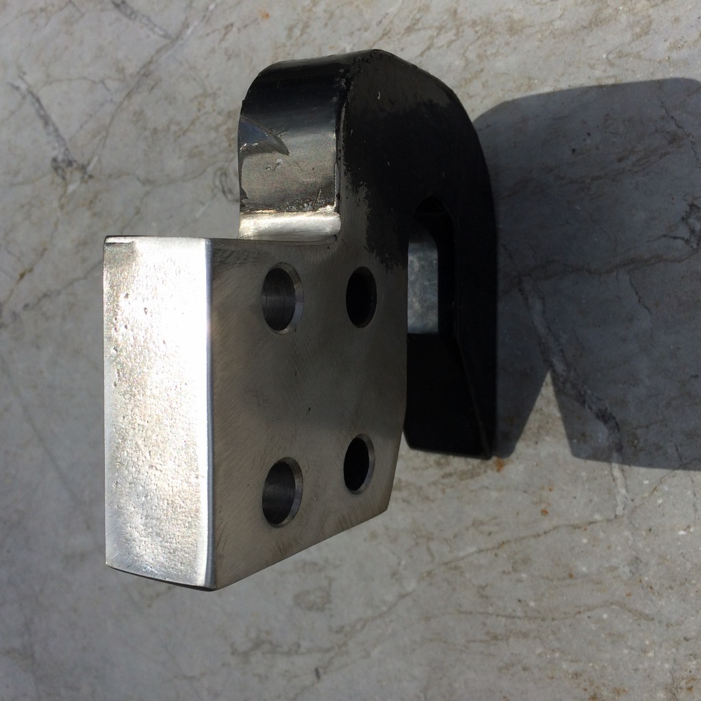

I'm surprised one of the small tractor accessory companies hasn't made a proper sized replacement hook (sticks farther back) for the HF quick hitch.

I wound up having my hook extended. Cost was roughly $60 including a piece of solid bar stock, welding, and then machining down the edges to match the existing hook and drilling new holes. Too much $, but turned out very nice and works perfectly. My extension was maybe just slightly more than 1".
I've done that to 2 of mine & one I got for a friend. DIY with much uglier welds & finish, but very functional. Replace the bolts with pins & you can quickly adjust it as needed (need to drop it down for the flex link on my rotary cutter to not pop out).
