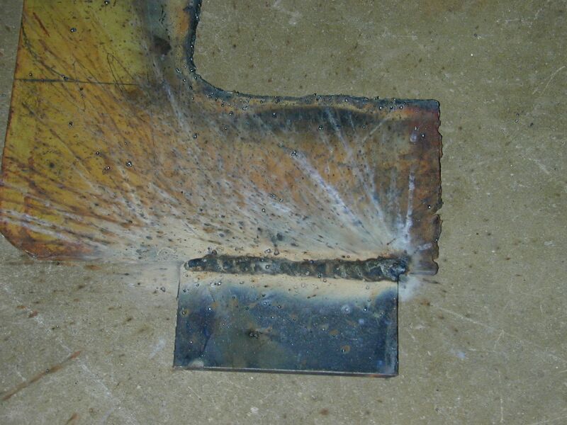

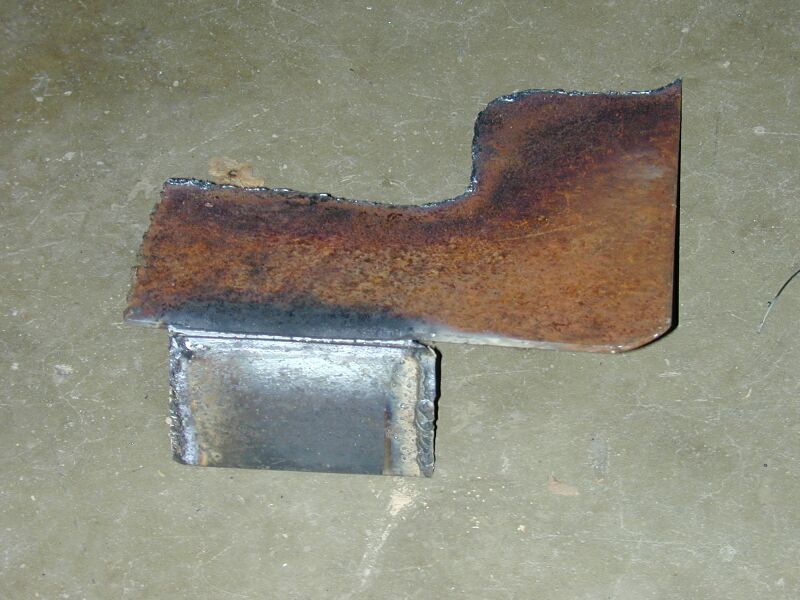

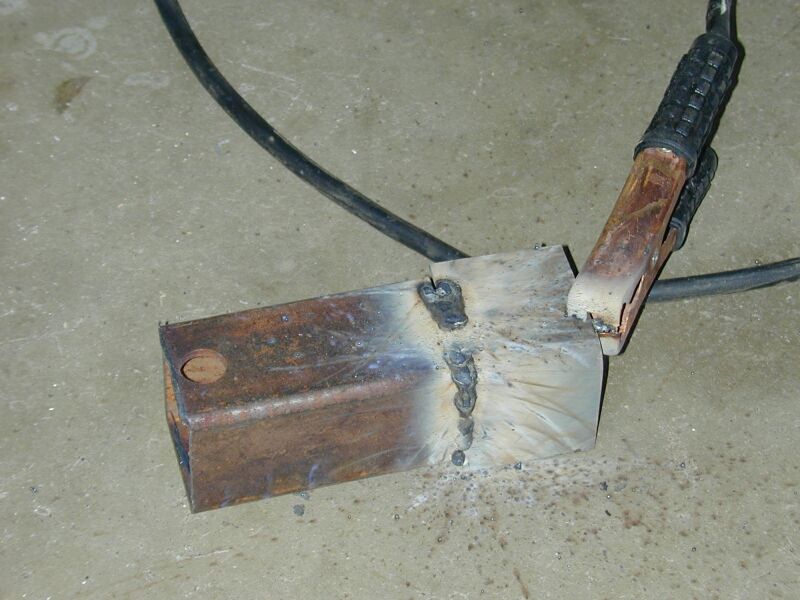

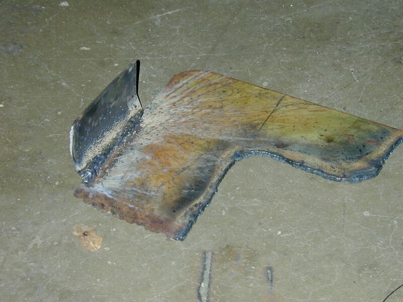

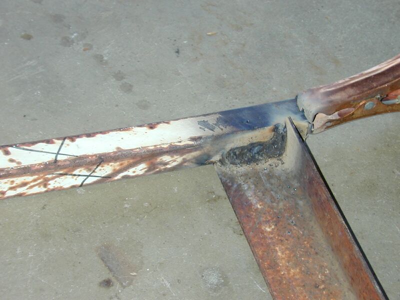

HomeBrew2 said:
Your disclaimer really only tells me that you don't know how to weld. Not sure what it was supposed to convey. I only wear sandals cuz I'm sick and tired of bleeding on my carpet because of stepping on the goathead stickers.
Cheers!
okay, okay, okay, joke taken Whenever I weld in sandals, the splatter gives me some nice roses on the top of my feet.
But seriously. that weld is representative of the quality of the HF product.
For the few hundred more over the course of 30 years, you could have a machine that produces clean, penetrating welds that you can depend on for a total cost of about $10 a year.
what you have there can easily be done with a tombstone and stick and KNOW that it will last but still look as bad. 60XX rod may look like crap but it penetrates. With the HF machine I would not trust it.
If the harrow comes apart no big deal but I have welded on my jeep and if that comes apart it is a big deal and someone could get hurt. Those welds are not welcome there.
If you are really that proud of the work, I would suggest you post that pic on the Hobart forum and get their input.
Well, it's obvious now, I'm just not going to be able to learn a single thing from you. Thanks for your effort though :)

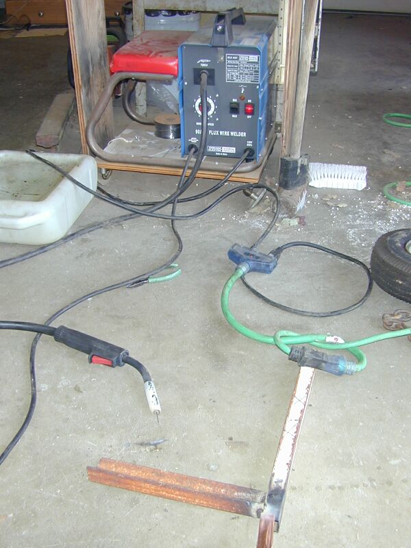

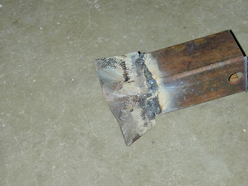

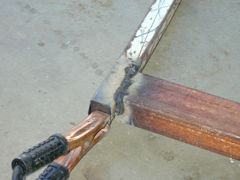

rjgogo said:
so again post the weld pics on the Hobart site..

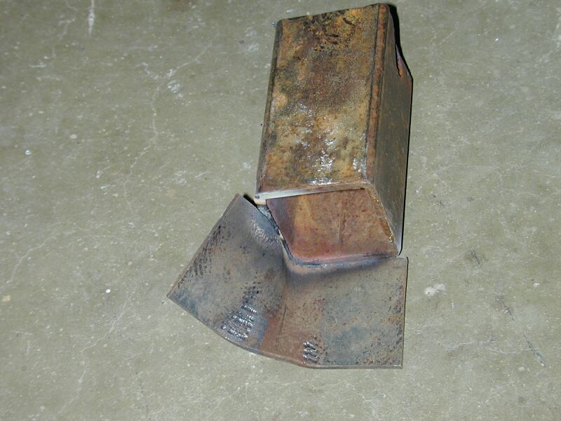

So, yet again, my only purpose for posting was to show, as you confirmed, the glue gun can produce welds comensurate with it's mfg and apparence of 6011 rod on an AC tombstone. This was to balance California's unfortunate luck with his unit, which sadly only produced birdie doodoo and, to balance comments made by folks that seemed to have no actual experience with the machine. The reason for describing my physical and mental condition as well as the poor condition of the material, was to demonstrate that it took no real skill to get the anticipated results from such a machine. I also believe that I showed from my destructive tests, that the machine produces adequate penetration from a single sided weld to not just "fall apart" as was eluded to in another post, and furthermore was stronger than my expectation. The original poster wanted to know if buying the machine was a waste of money. From actual documented experience with the subject machine, I believe it to be worth the money that I paid for it. As you seem to be so obsessed with the Hobart site, my pix are not copyrighted, so feel free to post them and kindly replay any comments back to this thread for all to read so continuity can be maintained.
Cheers!

Okay, The weld quality is in standing with the quality of the machine. but you and I both know the HF weldor is a POS. there are various levels of bad.
I have used a like machine, with equally crappy results. I have first hand experience.
It may look like 6011 but it aint.
As for welding on ****, you will get ****. Prep is one of the most important aspects of a good weld.
Again for a newbie, the extra couple of hundred dollars spent on a good unit will be more the paid off in results, that is if and that is a big if, they take the time to learn how to weld. And dont try to weld a bunch of rusted crap.

[FONT=Arial said:
HomeBrew2]Ok, how 'bout this, I'll pretend the welds I make to get my stuff fixed so I can actually get out of the freaking shop and get some real field work done are "good for me". You can lament about my POS unit and it's poor results and my bad habits while you admire your high-dollar unit and expert skills and flawless welds. I say to the original poster that the unit works well for me with my published examples, and you say it's a POS while providing no real examples with a comparable unit. Does that seem fair?
[/font]
Every Picture tells a story.
AC or AC/DC stick would be a better choice if funds are scarce. That is where I started. I probably have more time on a tombstone then a mig.
Also my unit was not high dollar, Wish I had the 250 amp miller, but alas I can not afford nor justify that purchase. I have posted pics of my welds in this thread, so there are published examples. If you want detail please let me know, I do not portend to be an expert.
This forum seems to be about giving good advise to folks trying to learn. I am very thankful to have found it as I have learned a lot here. I have searched topics and really made myself more knowledgeable and solved some problems.
My issue with this thread and your pushing the HF welder is of great concern. Frankly, for the kind of welding that is necessary here, there are two or three choices. An AC or AC/DC stick unit or a mig. If you want to go cheap, An AC/DC unit will work just fine and it rocks, and it is cheap and it penetrates. It may be difficult to start but once you get going you know you have a solid weld.
Mig is much different. You can weld a very pretty line, and that is all it is. It can fall apart if you don't know what you are doing. Mig is as good as stick with a good operator and a good quality machine and Great preparation.
My concern here is that an inexperienced person will read this, buy the HF Mig set up, not know crap about welding, try to fasten some stuff together and it will fall apart with catastrophic results. Possibly injuring someone.
The HF welders may work well with sheet metal and in the hands of an experienced welder may be passable. But for a newbie they are most likely crap. There is a reason professional shops don’t use the HF machines. If you can find a pro shop that uses HF machines to do the work I would be impressed and may change my tune. Your pictures of your welds do not sway me. Frankly, they scare me. Reminds me of when I was in high school. Don’t mean to insult, really, but I don’t want an inexperienced person thinking that those are okay.
I withdraw myself from this thread from here on. I made a resolution some time ago to not engauge anyone from the 'Fraidy Cat Club aka Safety Police. I am sure you have saved many lives and/or limbs with your posts and you should be commended for that. Carry on.

HomeBrew,
Thank you so much for posting pics of the HF unit and the type of welds it can produce. This is an old thread, but it was useful and your post was the most useful in terms of answering the questions I had.
I'm no expert welder, but I think those welds are decent and I would be happy with them.
I wanted to buy either the Model 94056 (the one you have) or the 98871 version. The later version has a duty cycle of 25-40 and comes with some sort of face mask and a slag tool. At the last minute I decided to go with the 220V mig they had on sale for $199. The HF floor guy went to the back
to find it but couldn't so I decided to get the 110v model 94056 since it has a higher amperage than the 110v 98871 (80-104.3AMPs vs 55-90AMPS).
Reg price: $149.99. Sale price: $109.99. 25% coupon for news years only tool the price down to $82. 10 bucks more than you paid, but I'm happy.
My next welder will be a Miller Econotig or a syncrowave machine. But this HF welder will hold me over till then. I also bought a spool of .030 wire just in case the included one sucks (too greasy).
