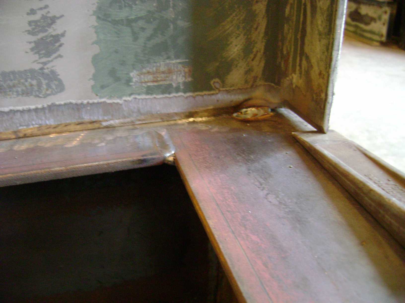

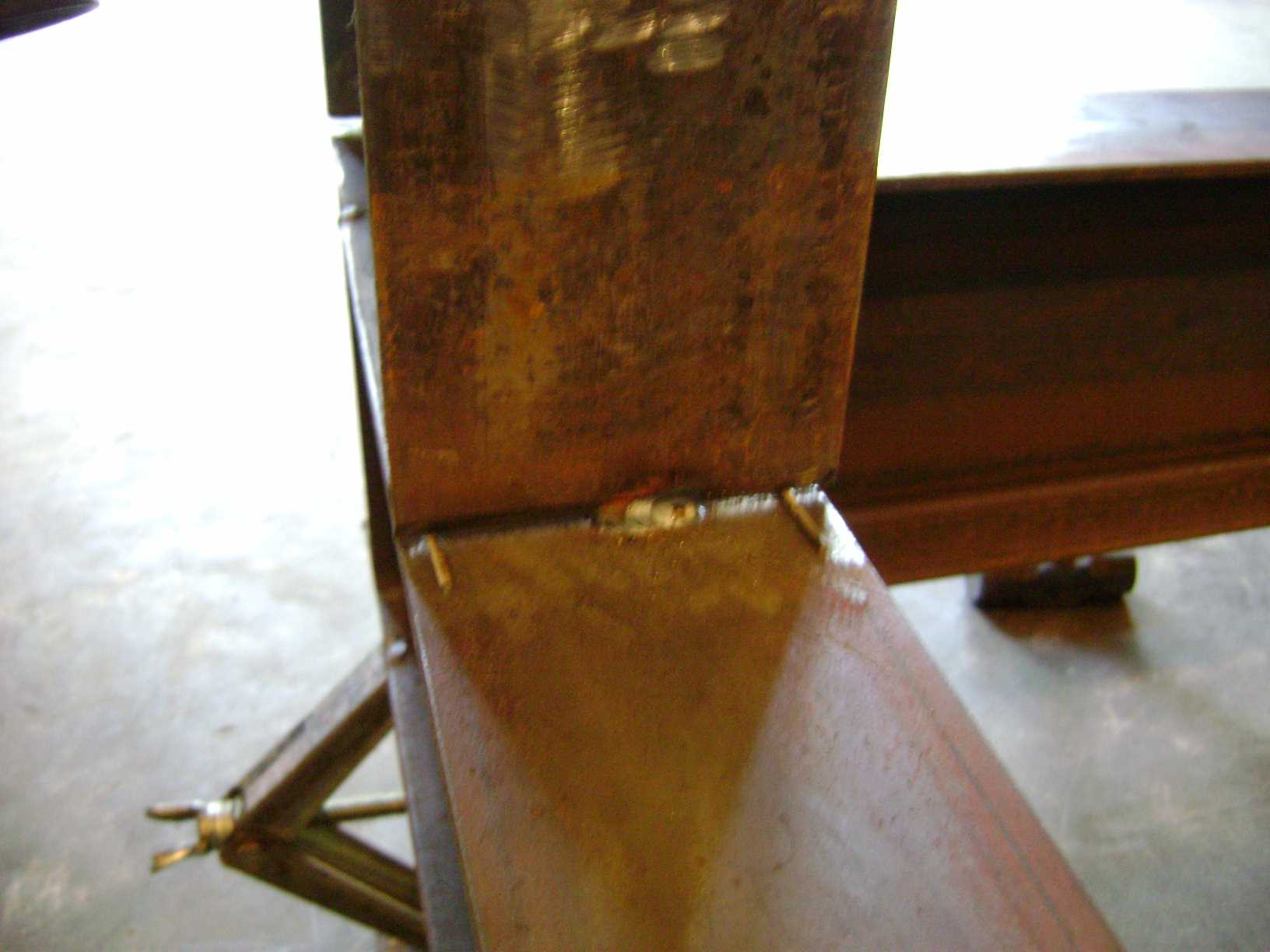

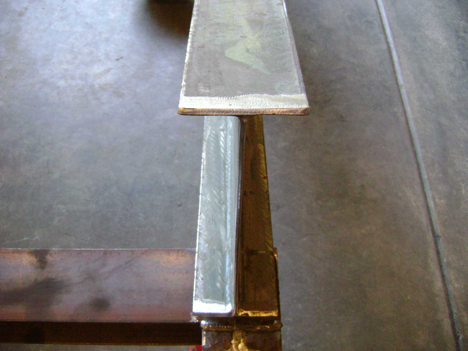

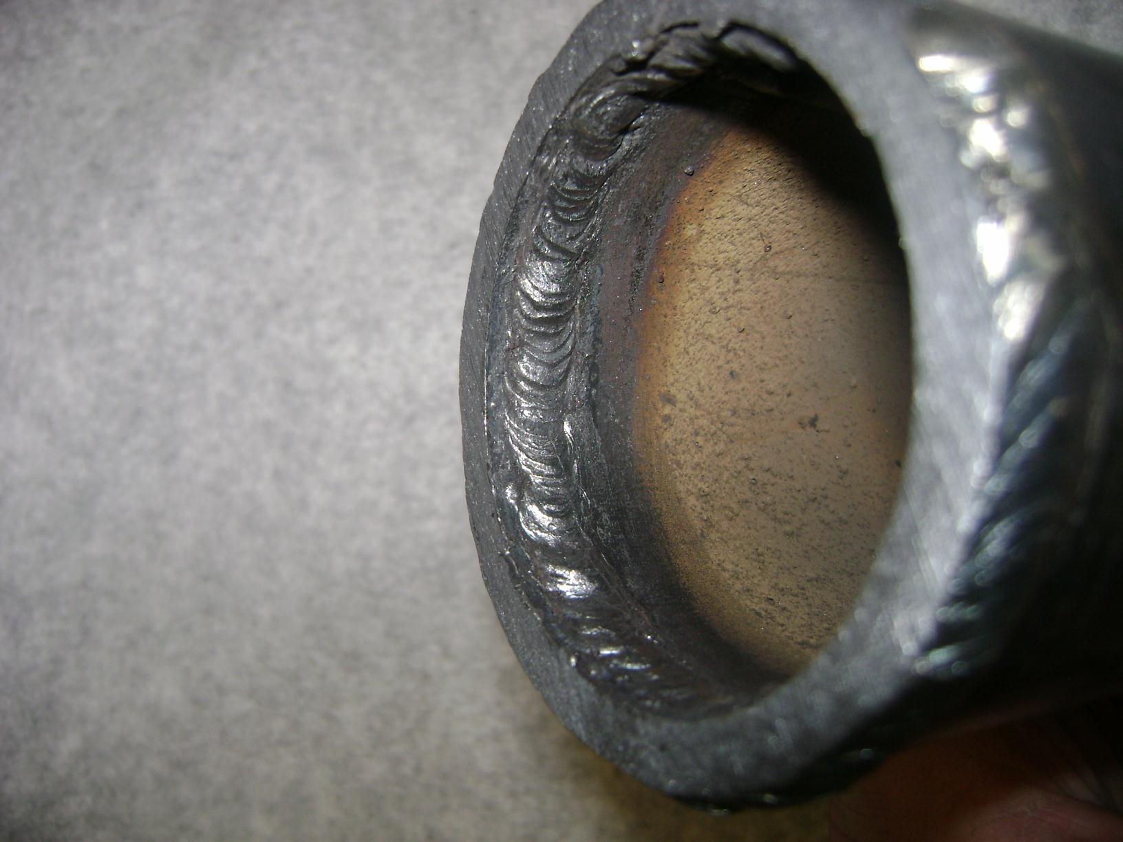

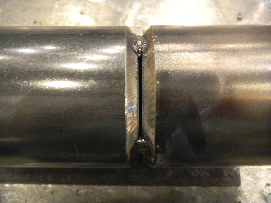

Carl, if I read your post correctly in comparison to the photos, are you recommending that I lift the hooks up slightly from the surface I'm going to weld them to? If so, what do recommend, 1/16th or so?
You don't have to, it is just a suggestion. It just insures that you get 100 + % penetration. It is a form of open root welding.
Oh I forgot, if you decide to gap the hooks. 1/16" is plenty, or even just use the same wire you will be using to weld the hooks on with. .035"?
Yup, .035 with CO2/Argon mix gas.

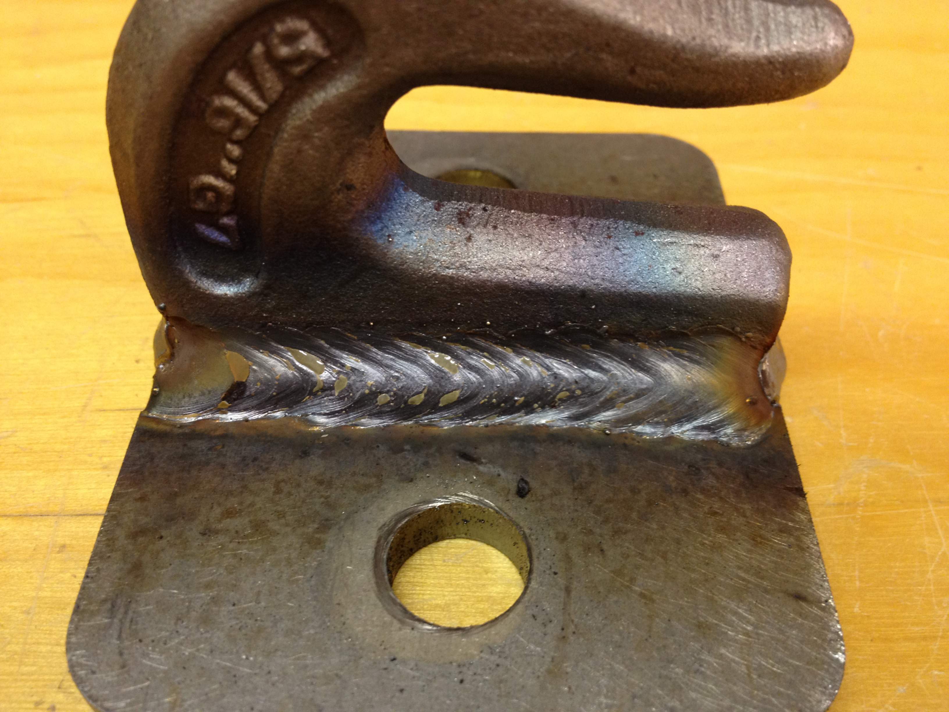

/ Grind the bevel off weldable hooks? #35

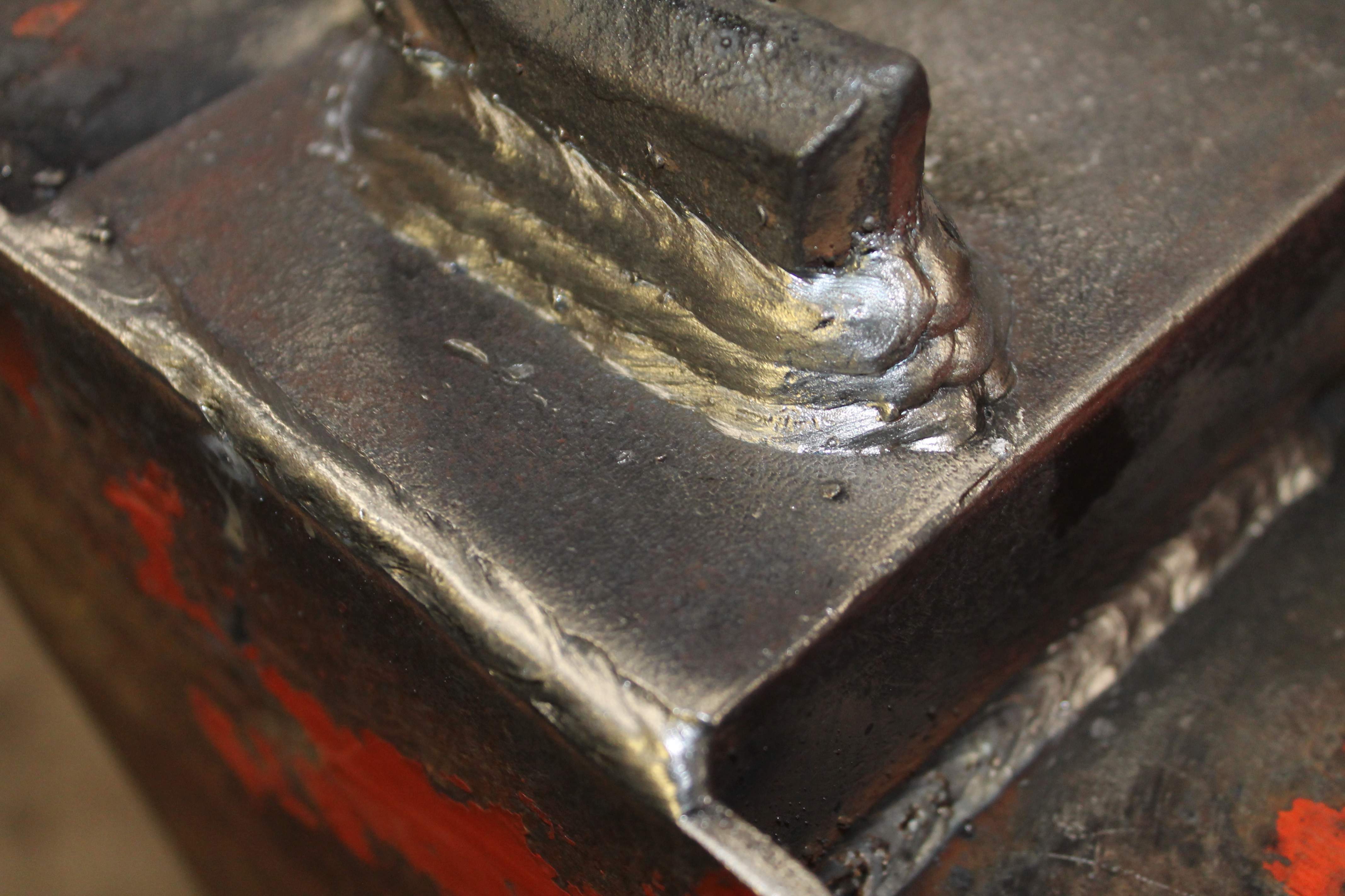

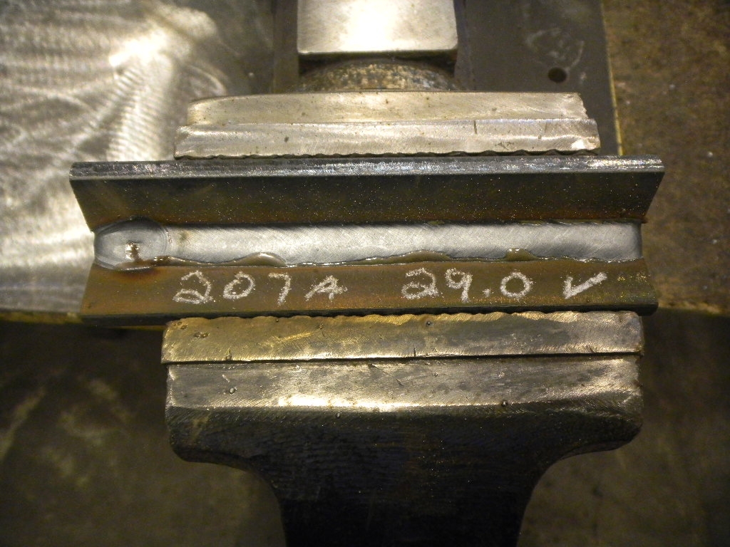

Here is one of mine:
Miller 210, Lincoln L56 .035" wire, 75/25 gas.
Don't forget to tip the hook slightly away from the first side you tack-the heat will pull it straight, then weld the opposite side.

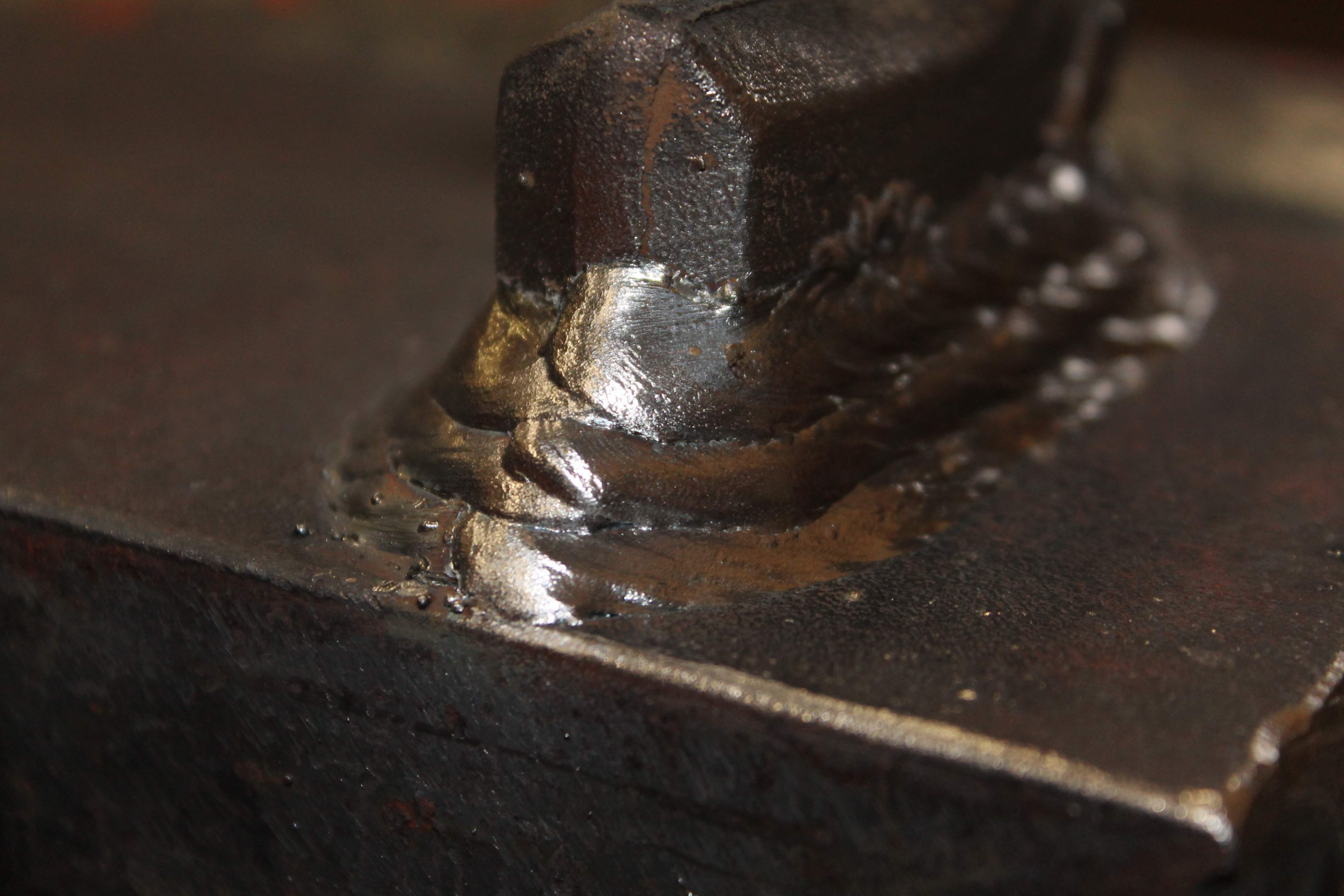

Here is one of mine.... Stick rules:cool2:
/ Grind the bevel off weldable hooks? #38
Good looking bead, Bro...
Thanks Roy, just my little chicom welder you see there at 125 amps some 1/8 inch US Forge 7018 .
This is on my Kioti, when I looked at the bead, the thought that went through my head was that my bead on the hook looked better than the MIG weld on the the little plate that the Korean guy did.
