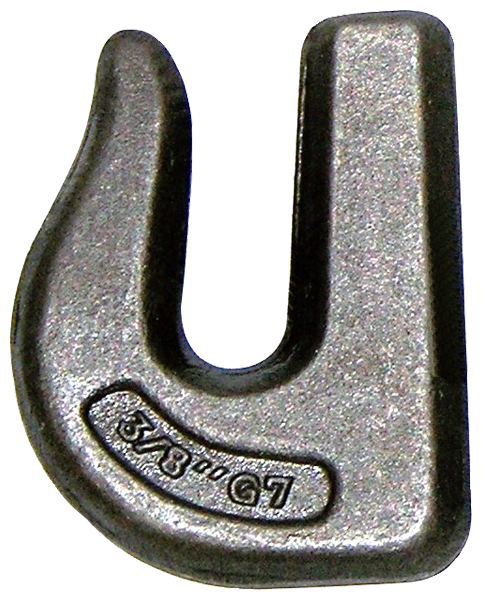

I've bought some weldable grab hooks for my FEL that I'm going to weld on to a piece of angle steel on top of the loader bucket. They are the same configuration as the photo below. I'm going to weld them on using a MIG welder and I have a question before I start. Should I grind the bevel off the back side so they sit flat on the steel or leave the bevel and build up the welds in the bevel?
/ Grind the bevel off weldable hooks? #2
Build it up. Make sure you get a good root pass.
/ Grind the bevel off weldable hooks? #3
I wouldn't MIG them but that's me. If you are very experienced then maybe. The problem is the weld and hook likely will occasionally be used in critical situations.
Grinding the mill scale off of the bevel to bright metal is strongly advised. Same for the parent metal...especially for MIG. The bevel is there so the weld will approach 100% (at least better than a fillet weld would be).

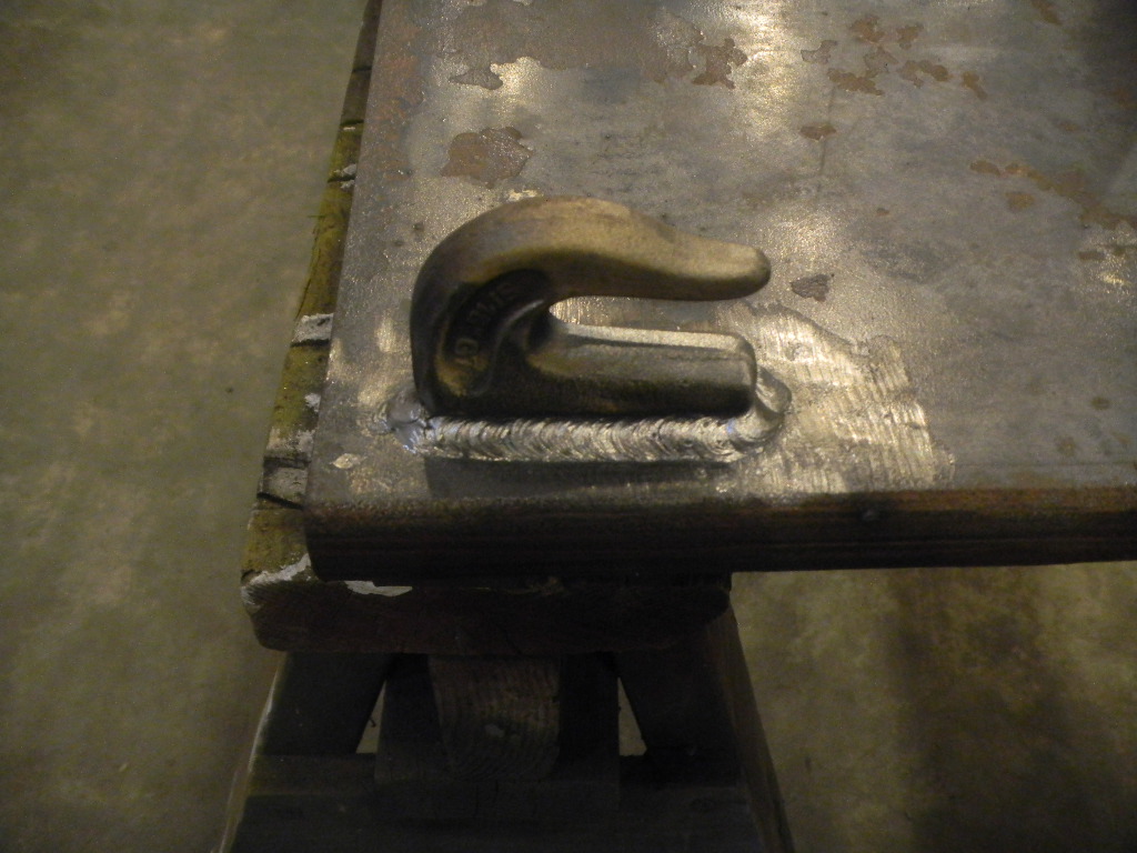

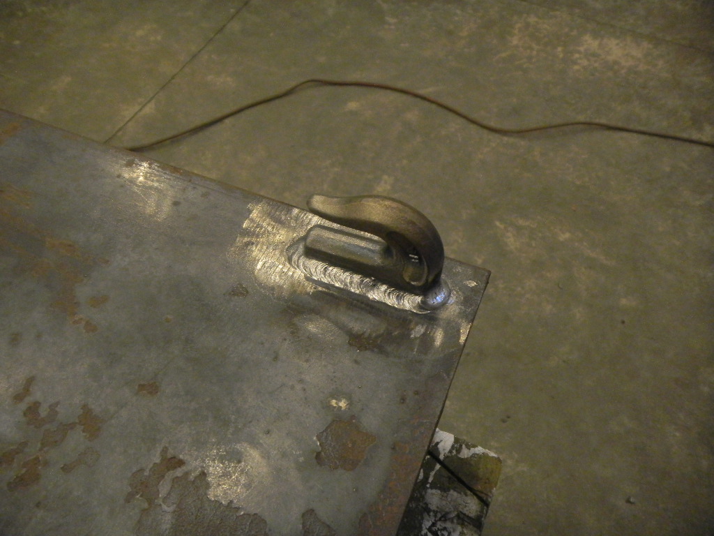

/ Grind the bevel off weldable hooks? #4
I just put the same type of hook on my chain link fence spooler, there is not much bevel, fill it up.;)

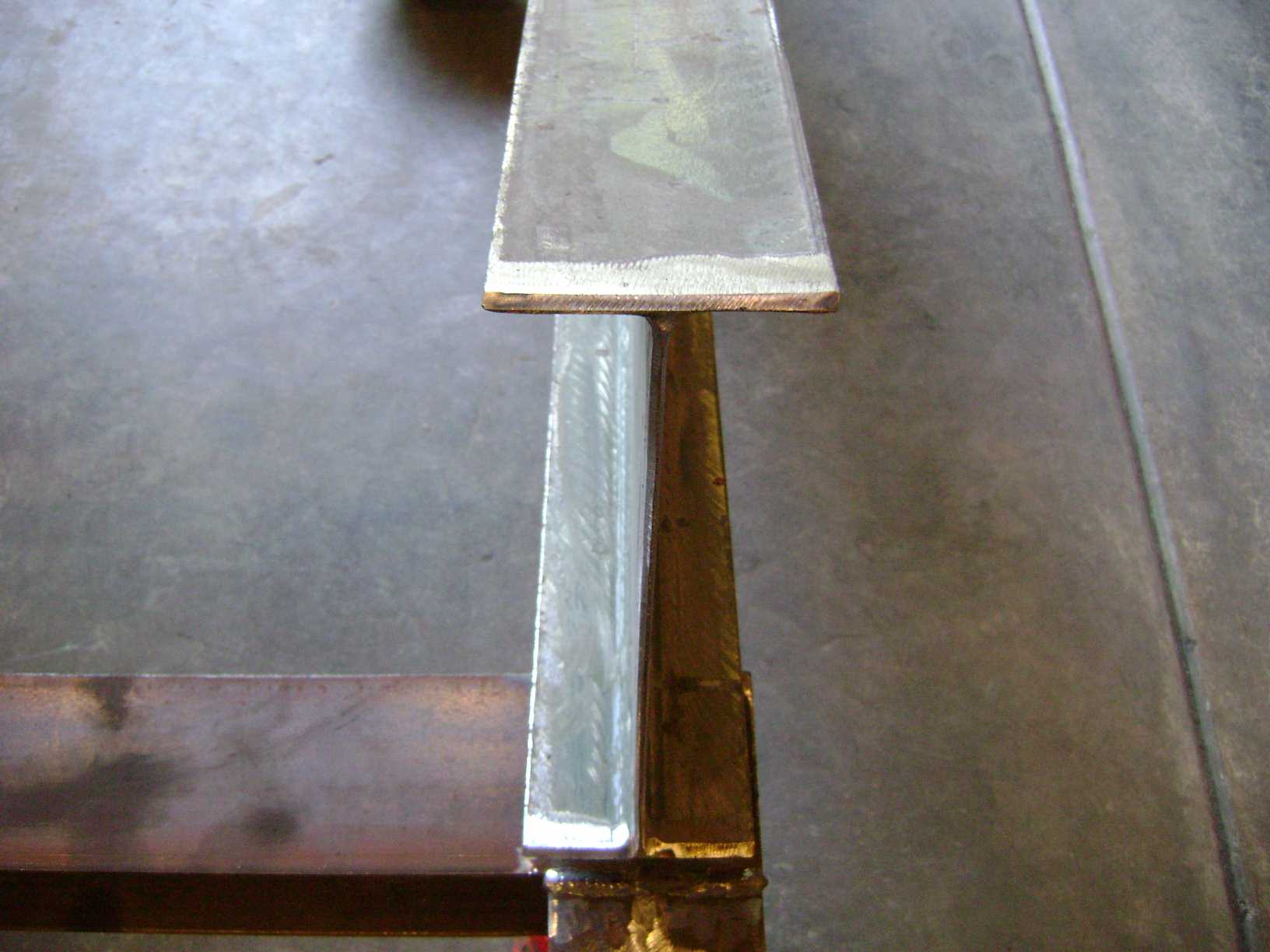

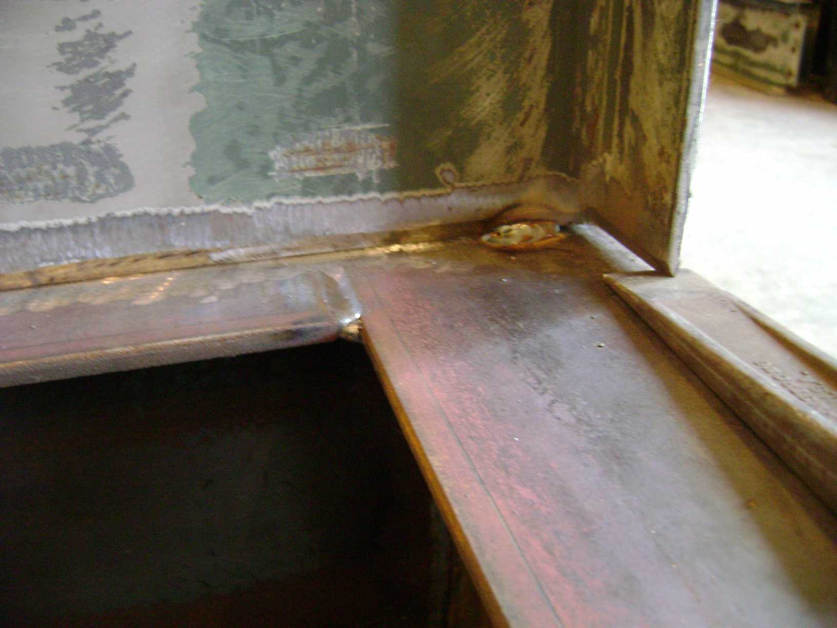

One thing to think about. If you really want to put these hooks on correctly? Is space them up a little. When I built my gooseneck adapter for my trailer. I beveled the vertical beams, but also spaced them up a little.

Thanks all. The bevels stay. Carl, if I read your post correctly in comparison to the photos, are you recommending that I lift the hooks up slightly from the surface I'm going to weld them to? If so, what do recommend, 1/16th or so?

I'm not going to answer for Carl...but I will recommend you concentrate the heat on the hooks until the puddle forms. Those are solid forgings and you do want to ensure you get good fusion in both the hook and the lighter gage metal of the bucket.
