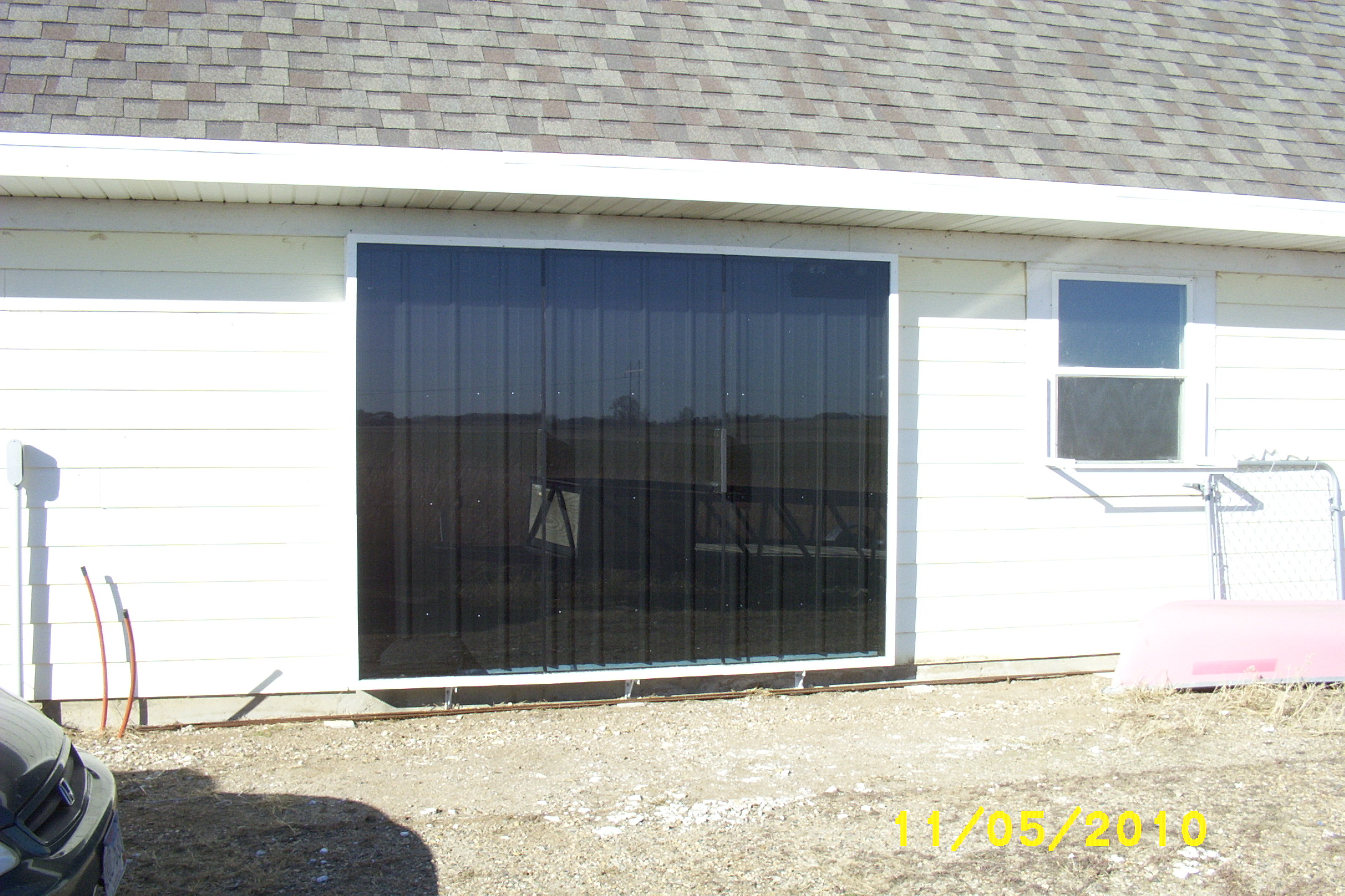

I installed a solar panel (air) on my 26' x 40' garage a few years ago using some salvaged parts I had laying around. It blows 100+ degree air into the garage when the sun is shining. Until you build them you don't realize how infrequent that may be.
Do u mean u r getting less from your solar system than u expected? R u dissatisfied with your choice?

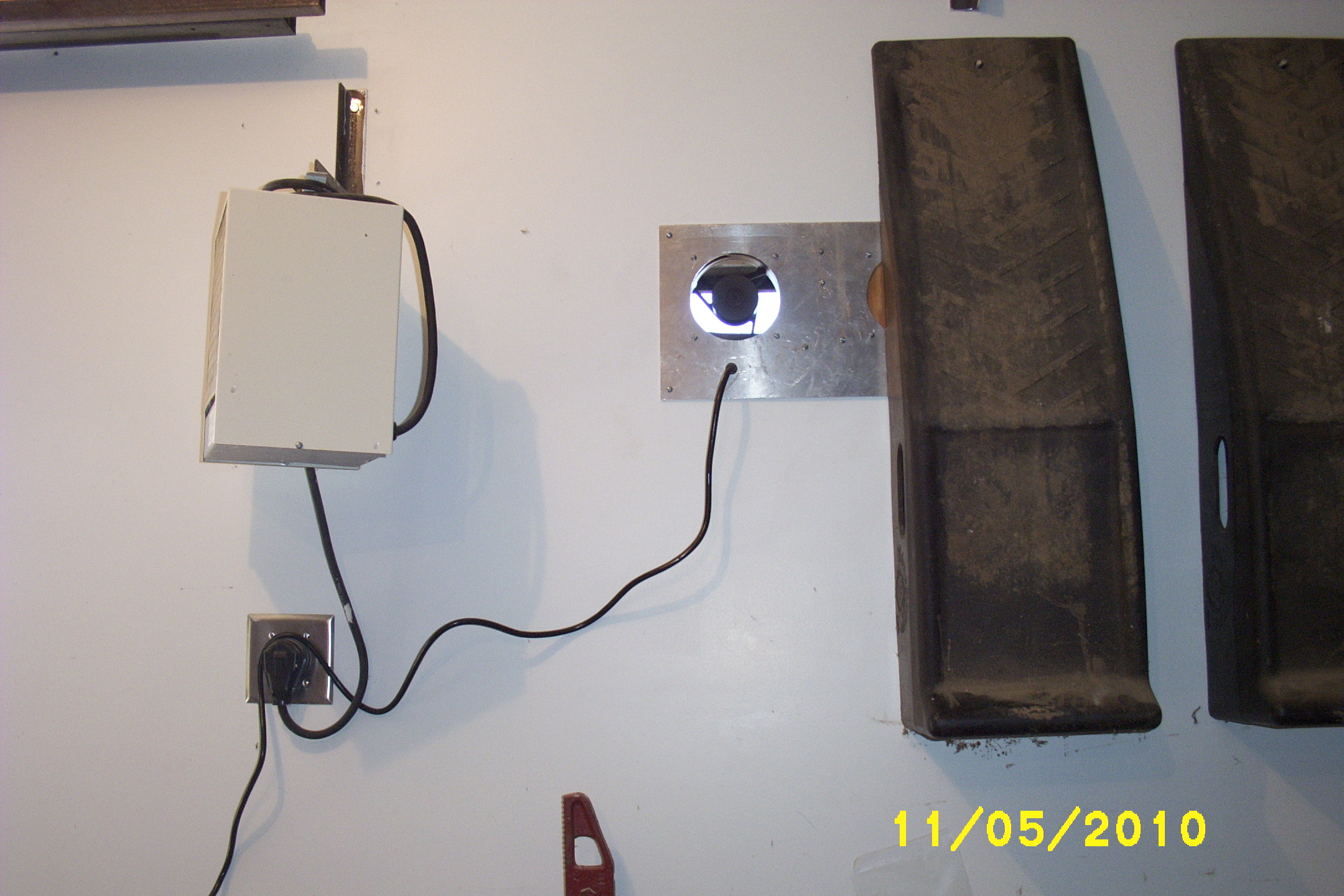

I consider every btu gained as a plus since I had very few dollars invested. I use 2 4800W electric heaters to keep my garage between 36-40 degrees during the winter. The solar panel when running prevents the electric heaters from coming on plus will usually gain 5 to 10 degrees temp that will slowly bleed off during the night. I track my electric usage but it is very hard to tell what $ benefit I am getting because every day has different weather. Without a doubt they are making a difference and considering I have maybe $200 invested...payback will be a short time. Below is a picture of the electric fan opening into the garage that is controlled by a 70 degree snap switch.
Oh yeah... $200 is well worth investing in any potential gain. Thankyou for clarifying.
