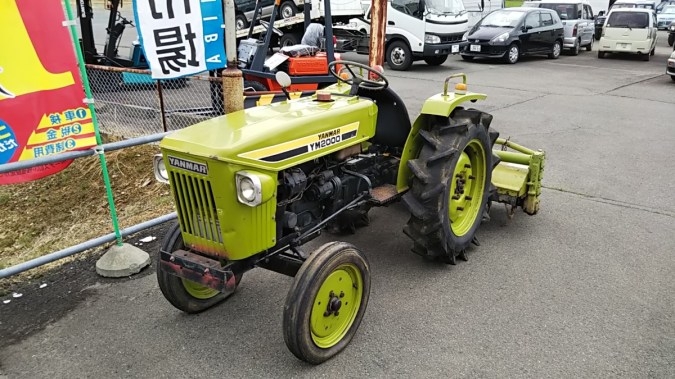

Lite Tree Frog Green,

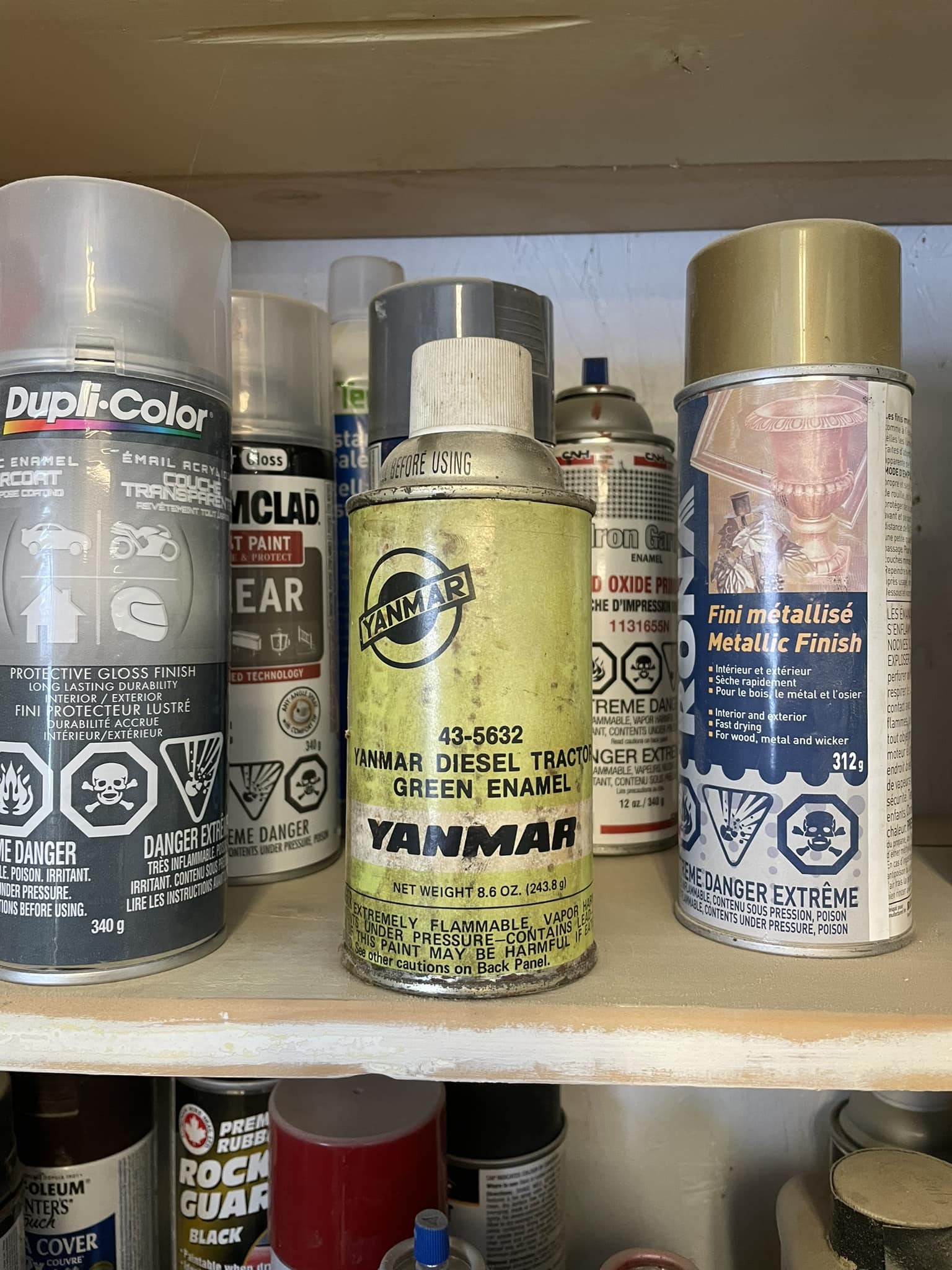

Dark Tree Frog Green,
