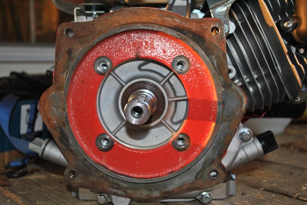

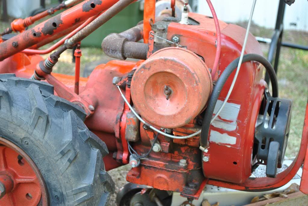

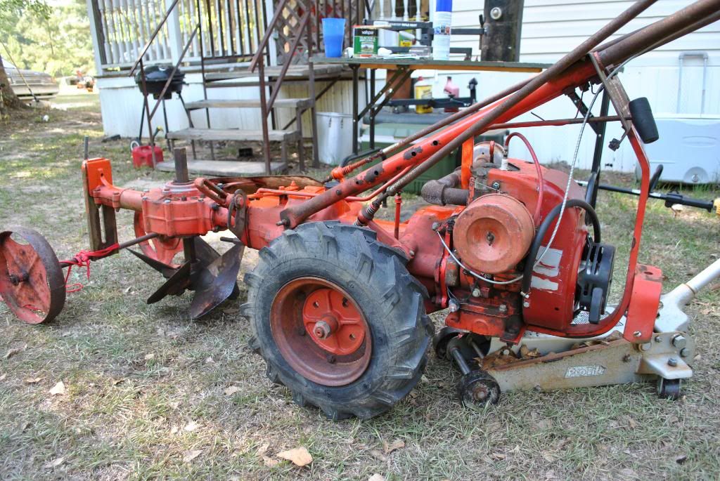

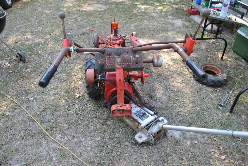

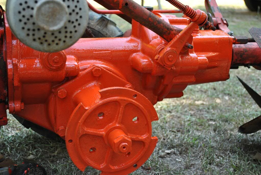

Well I finished up my 5200 this past week. I decided to repower it after not being able to get the old 8HP engine to crank up after sitting for over a year. Thanks to Bruce and others for their info. Started off kind of rough. This is during the tear down phase.

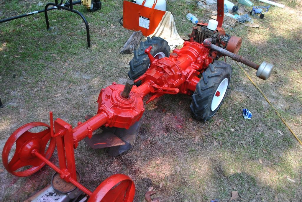

Here i started to repaint the tractor with Orange and then later decided to go Red

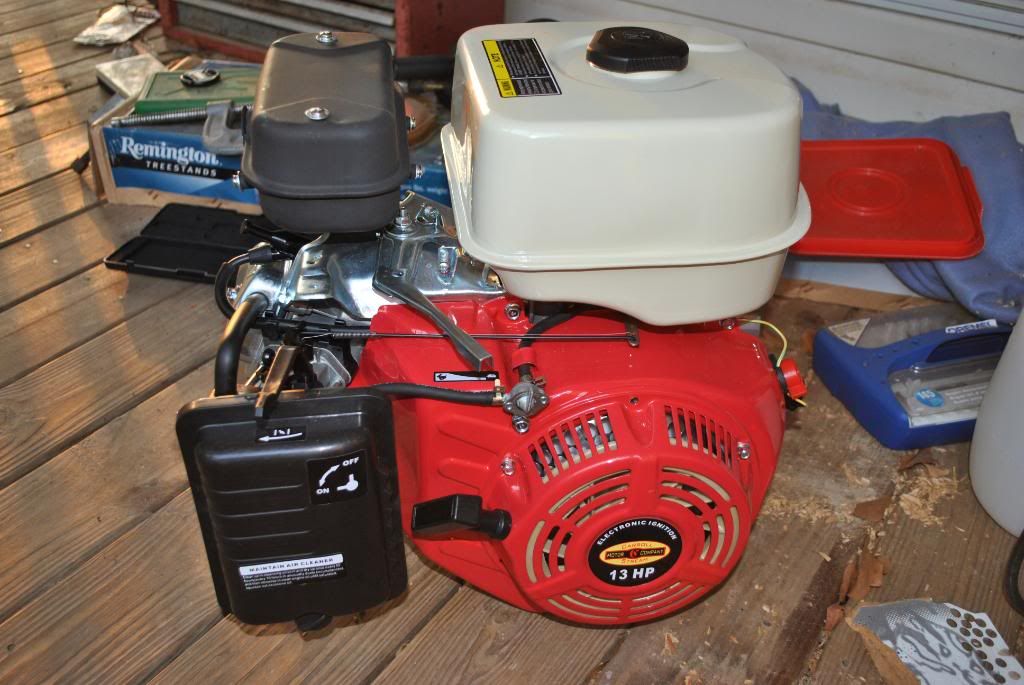

Here is the 13HP Carroll Stream Engine

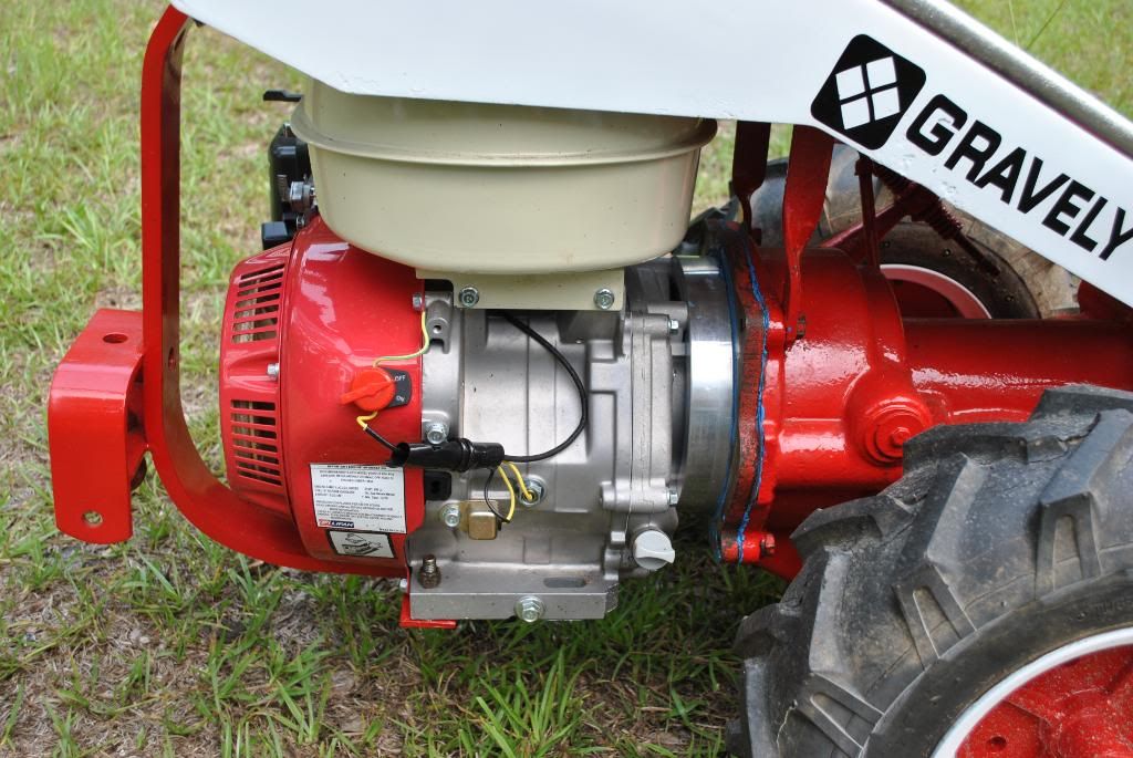

Here is the original 8HP adapter plate. I decided not to use this as it would have used 5/16-24 bolts to mount the engine and I wanted to use the 3/8-16 bolts instead to support the weight. Found a plate at Gravelyparts.com

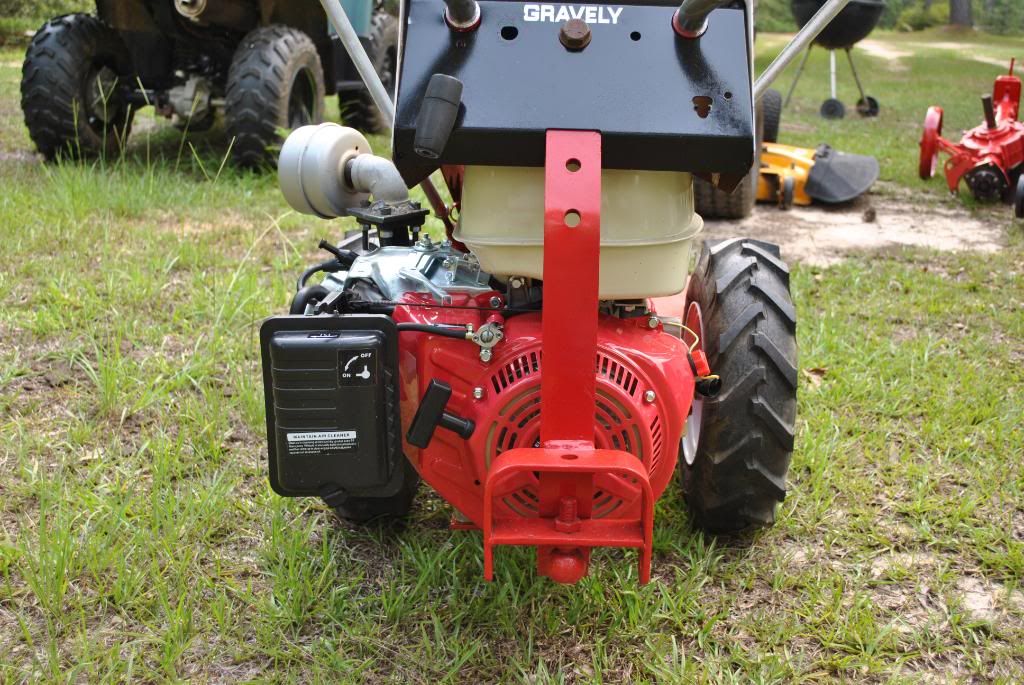

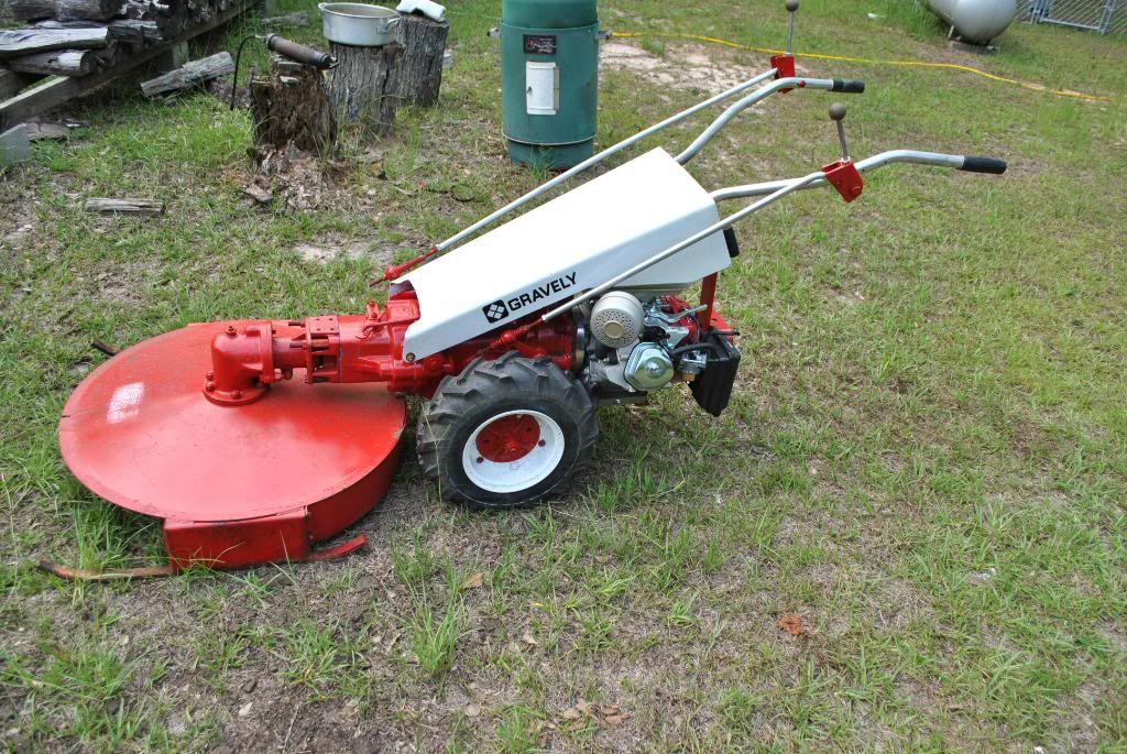

Here is the finished tractor.

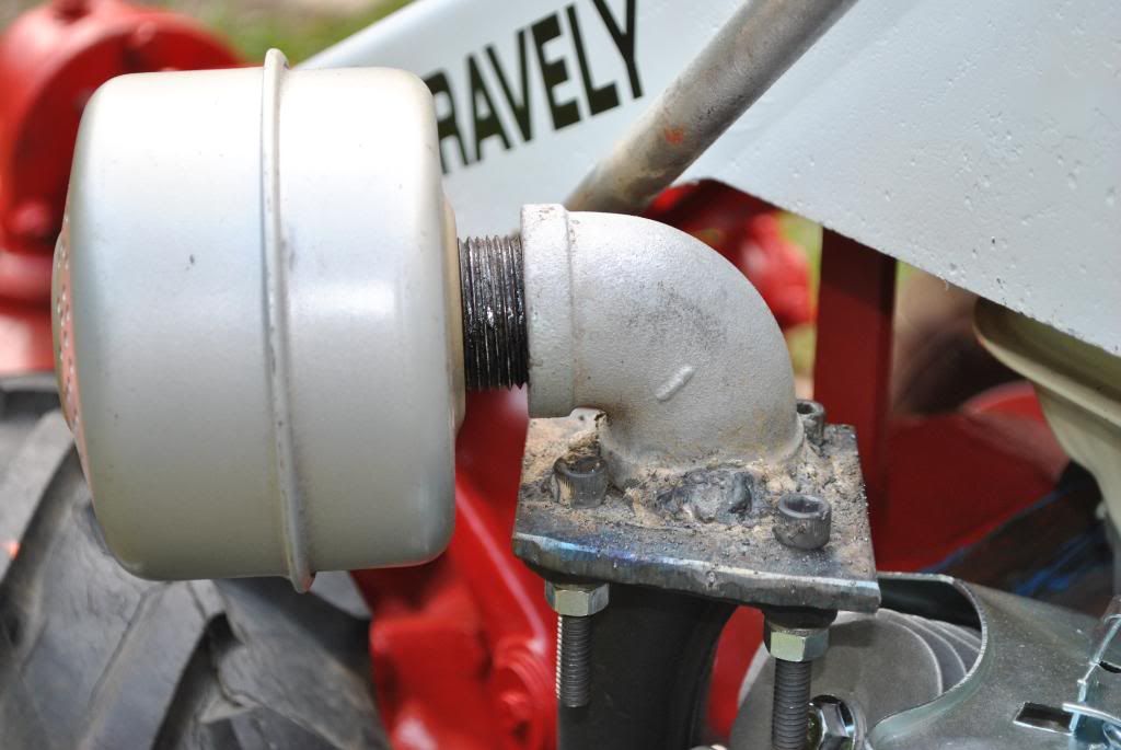

This is how I did the Muffler. Just a temp install till I figure out a better way that looks better.

Somebody posted a legacy link to the old Gravely website that's hard to find now. Can't remember where it is. I think it's somewhere in the Gravely or 2 wheel tractor forums. They had several pictures of muffler installations--many of which were larger mufflers that had been installed to quiet things down. Might as well put a quiet one on there since you've come this far.

Since you started with an 8 hp kohler, did you have to change out part of the gearing as well as the adaptor plate?

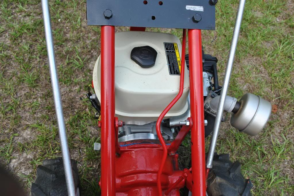

I order the Briggs Gear and Top Hat Bushing from Gravelyparts.com along with the gaskets. The gear is part number 08564700 and the top hat pilot bushing number is 08564800. You have to use these because the original crankshaft on the Kohler is 3/4" shaft and the new engine is 1". The pilot bushing is 3/4" and bolts thru the double gear into the end of the crankshaft. This will make the engine sit back about 1" away from the plate. This is where the new aluminum adapter from Bruce Guthrie comes in, he can be contacted at gravelymay@yahoo.com. It fills that gap. If you use the original plate the bolt holes will mount to the center engine pattern and will take 5/16-24 bolts. I would recommend finding a 9HP engine if you do that. I felt the 13hp would be too heavy on those smaller bolts so I found a 12hp engine plate since it uses the outer bolt pattern and the plate is thicker. It also uses the 3/8-16 bolts. I had to cut my bolts down to about 2-1/4" long so I didn't bottom out the mount bolt holes on the engine. 2" wouldn't have had enough threads.

I'm not sure if anyone else feels this way, but I've wondered if the location of the muffler even on the original Gravely was more of an afterthought and dare I say, not much of a muffler? It's almost like there isn't a good place for it, either. But there have been some neat muffler fabrication jobs on the Gravely conversions.
/ Gravely 5200 Re-Power
yeah I think the gravelys with the Kohlers were at the mercy of where the exhaust port was on the engine and had to deal with it. I kind of like the way I have it now as the muffler is pointed sort out and forward at a 45 degree angle so the noise is directed out and away from me when standing behind the machine at the controls. Help quiten it up to me. Can speak for anyone who might be to the side or in front of the machine. Guess they don't need to be there anyway.:laughing:

Nice paint job on the repower! Did you brush, rattle can, or use sprayer? Everyone has their preferred method. Just wondering what yours is.
#18
Some parts are brushed and some rattle cans. Hood was rattle can white. Transmission started as brush and then touched up with rattle can. Rotary plow and mower deck were brushed. Cheaper to buy the quarts of paint at Tractor Supply. You can then either brush or thin and use a spray gun if you have it. I didn't have the paint gun so I got a couple of cans of MF Red and a quart so I can spray later if I need too.

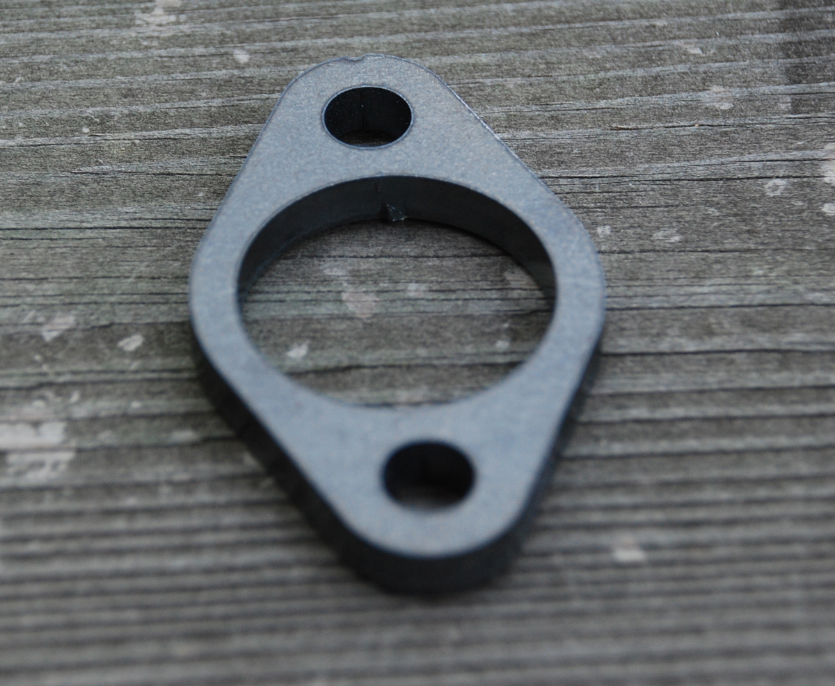

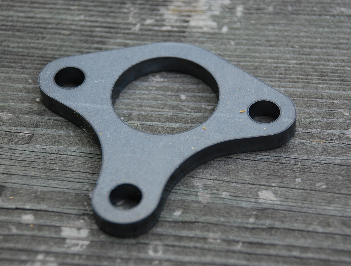

Hi Epoxyoyo
You may be interested in a couple pieces I had burned out.:thumbsup:
I can let them go for $5.00 each plus what ever shipping is:thumbsup:
Thanks Bruce G

  • 101 EXHAUST FLANGE HONDA.PDF
  • 100 EXHAUST FLANGE HONDA.PDF
#20
Looks good Bruce. I'll take 2 of each. What size pipe goes in the hole? Nevermind on the pipe size. Helps to look at the drawing :)
