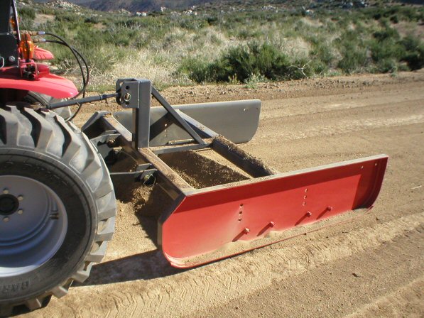

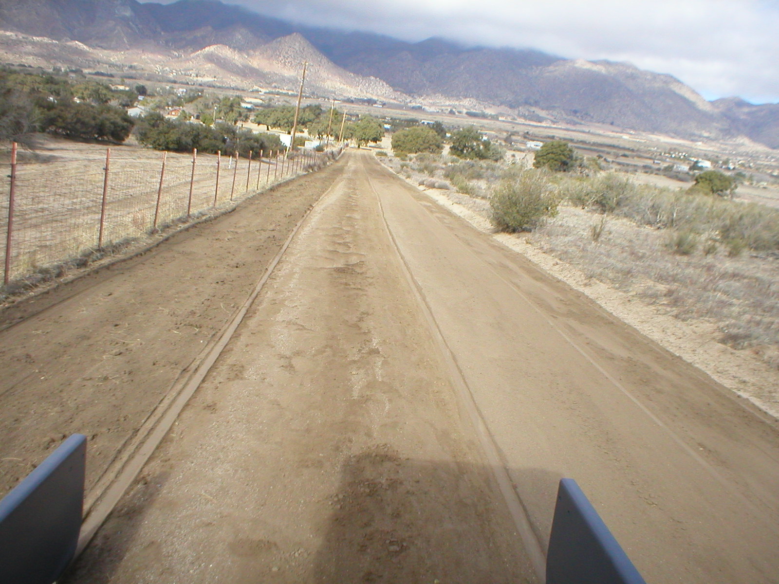

When using a land Plane (LPGS), time is what really makes the implement worth every cent. When performing general road grading maintenance, a LPGS does the job of a box blade, rear blade or landscape rake in less than half the time.
So whenever the road even seems like it could be better, go out and grade it with the LPGS. It's relatively fast and easy. No "good" reason to ever let the road get bad again.;)
I maintain 1 3/8 mile of road, the first 1/2 mile of that is shared with 4 neighbors. My roads are never "bad". :thumbsup:
