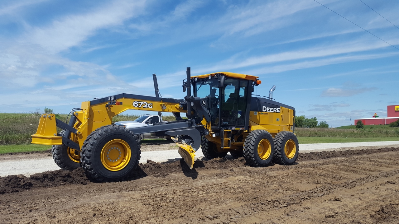

I'd have to replace the skid shoes on the land plane half a dozen times or more per grade if that were the case. Doing that with my subcompact would be like painting a battleship with a toothbrush.
Proper equipment is paramount in any undertaking. :D

So ...the county bought a new Deere.
Did the price determine Deere over Cat?
Somewhat. Cat only offered high tech joystick equipment that is expensive and unnecessary. Cat has figured that out after 12 years and in 2020 will offer their graders with standard rack controls. Sales loss has driven that.
