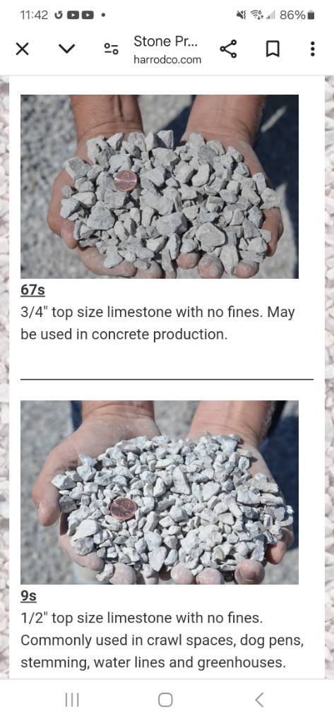

I had an area between buildings 25 x 65ft that over the years became sod when dry and mud when wet/winter. Needed to occasionally drive pneumatic tire forklifts thru there, and that was OK....when
dry. Not so good when wet. Finally decided it needed to be fixed, with near-zero clue of how to fix it.
I asked around on some of the 'dirt' forums. Most popular answer was 'concrete', which was not an option. One dude said 'you don't sound like an excavation contractor, get off this forum'. So nice.
Anyway, I scraped off the sod and decayed grass and dirt, got a slope away from the buildings, and
laid down fabric and about 4" of #2 crushed limestone. It looked so much better and water didn't puddle, so I felt lucky. When it was dry I drove one of the forklifts out on it and stopped. When I tried to move, even tho the stone was crushed not round bank run, the tires rolled the stones and they sunk down.
A sinking feeling for sure.
Searched around on the net some more, and wondered about 'fines' mentioned. Visited a couple gravel yards where they had sample piles, and stumbled upon the '3/4 and less with fines'. They call it 'Item 2' here in upstate NY. I kicked at the pile and wow did it seem solid! So I had 5 tons delivered to try it out, and to my amazement, just a 'dusting' of maybe 1" of that stuff, and everything tightened up! Drive the forklifts over it now with no issues. I ended up putting down about a 2" layer and tamping it in, letting the rain get on it, and after that the tires barely leave any impression. I call it 'miracle stone'. When you finally figure things out, it can be a good feeling.

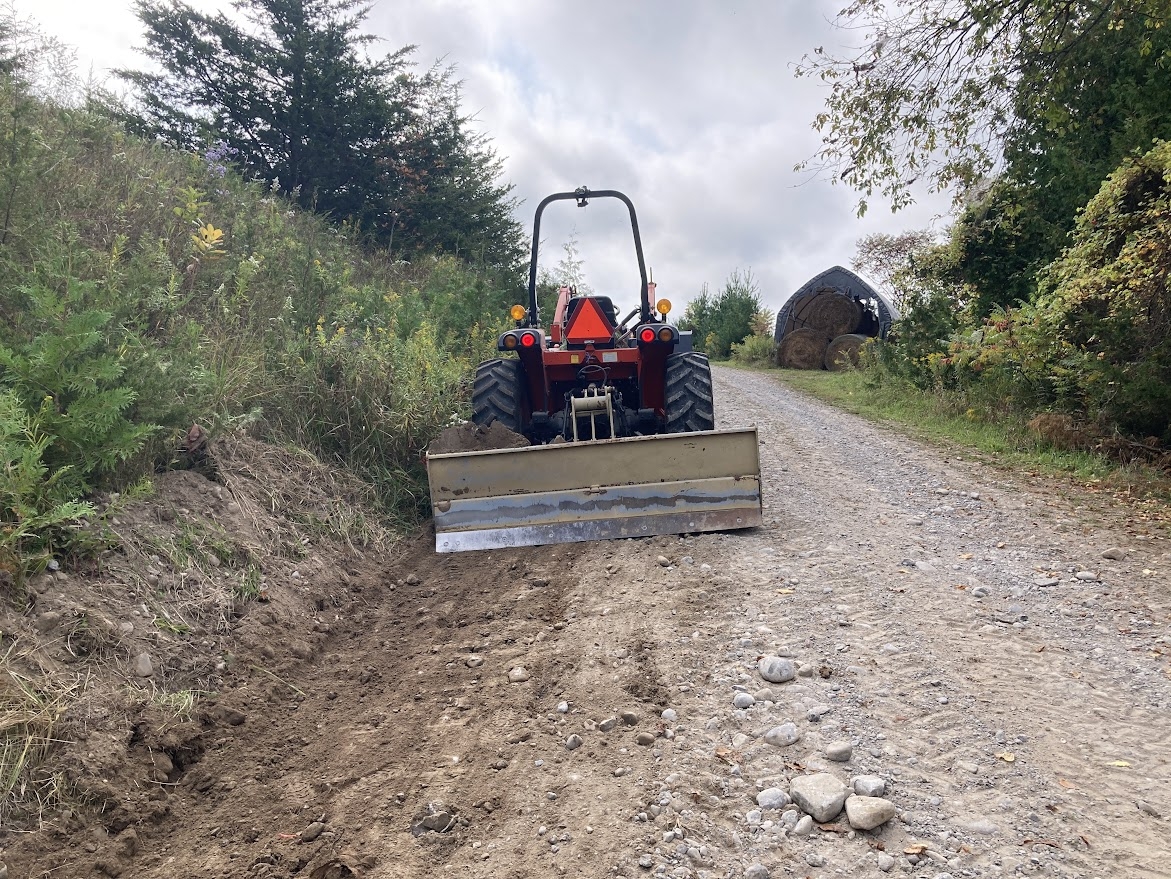

I have about 1/2 mile gravel road which takes a beating. I'm going to redo it with fabric and gravel, but I want to figure out a way to pack it as smoothly as possible, after I'm through with a land plane. A lot of the road is on a north facing hill, and it tends to wash out, even though I plan on raising and crowning it, I'd like to pack it in, as when I leave it loose, it is gone in 2-3 weeks.
Typically, I get my F350 out and drive up and down the driveway as many times as it takes to track in everything, but it always drives me crazy, as it seems like there should be a better alternative. I'm not going to buy a vibratory packer, although that would be what I'd actually like. I've looked at skid steer vibratory packers, but they are ridiculously expensive $15-20K. I've looked at tractor tow pneumatic 'Wobbly type - trailers' which would work VERY well... but new, they are same price and used... they are all in Canada, that I find, and by the time they are shipped to me, they are once again pushing the $$$ up to $12-15K and are 'well worn' by the looks of them.
Matt, from YT channel 'Diesel Creek' had a couple old Vibratory units, ran off a diesel motor but towed by a tractor or something. That would work... but I haven't been unable to find ANY at ANY price... so I know I'm looking in the wrong spot. I don't want a project. I want a packed road.
Thoughts? I'd like to get away from driving up and down my driveway if I can.

Yep. A road bed constructed with proper drainage and material with fines shouldn’t need repeated packing after the initial construction.

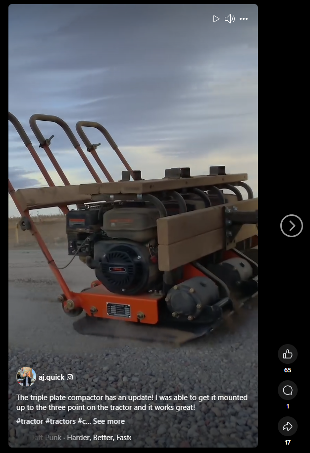

I can't seem to find it right now, but there is a Facebook group called "Homemade Attachments" (or something to that effect) and one of the recent posts was a guy who made a vibratory compactor attachment out of three small plate compactors that are fairly inexpensive compared to these large machines. He pulled the three small plate compactors behind his tractor and it seemed to do a fairly good job of compacting. If I find the post, I'll try to steal a pic and post it here.
another idea with filled tires

The clue is “tends to wash out”. If your driving surface washes out just about anything you do will be futile. Although crowning will help, the wash outs will continue until you start running that water under your driving surface. Every municipal road you have ever driven on has pipes diverting water under it. I was involved with a similar problem many years in a community with gravel roads. A civil engineer we hired brought it down to one sentence; “Stop using your roads and drainage ditches”. My hilly (steep) property had a 220 yard driveway that would wash out. Every year I had a tri-axle dump ¾” washed stone for me to spread. I got sick of that. I cut a ‘ditch’ (I’m sure there is a better word than ditch) on the uphill side and installed some 14” pipes running under my driveway. Nearly all the cost was my labor. I never had another washout. The US Forestry Service has an outstanding 94 page booklet, available on line, on how to create a road. They have processes and standards for everything from very high public usage (like in national Parks) to almost never used (like in ‘fire trails’ to get firefighters deep into forests) The document is called Guidelines for Road Maintenance Levels.
It is well worth your time and is a good way to spend a cold, rainy winter night.
The plate compactor's work OK, I've got an older one that I use on my projects. They move at their own pace, which is maybe 1 MPH. I'd think if you pulled one along behind anything, it wouldn't be in contact with the ground long enough to do much of anything. They're relatively light and depend on dwell time in a given area to do much compaction. I even hold mine back to let it dwell longer than it would if it traveled along as designed.

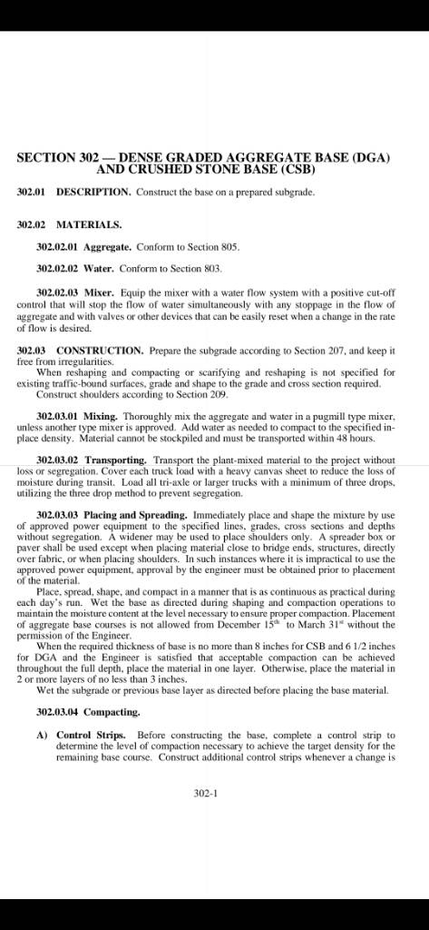

If you are using straight gravel, it will never stay packed and have to be repacked over and over again. What we use around here is a mix called road base gravel. It’s a mix of different sized gravel and crusher fines. The different sizes plus the fines lock the material together. I installed this on my road 6 years ago. It was packed initially and has stayed packed together pretty well. It’s almost like concrete. A few times a year I surface grade the road to pull some of the loose gravel from the ditch and shoulders back onto the road, but for the most part the road stays packed. Uniform sized gravel without fines will never stay packed and hard.
Exactly what is needed. Here in Pa it’s called Driving Surface Aggregate (DSA). Moister content needs to be fairly high. When crowned and properly compacted it will last a few years before needing maintenance.

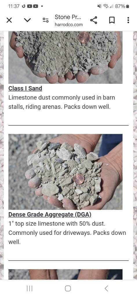

Have you considered "dense grade" at least that is what it is called in south cetral Kentucky. It is gravel mixed with a lot of stone dust. After it is leveled, etc. and it gets wet, it hardens. After I started using it, I stropped having gullys cut across my driveway when we had "gully washer" rains. My D/W is also about 500 feet long.
Plate compactors are for small areas, thin lifts and asphalt in small areas where a roller won’t fit or may leave marks due to its size and the contours of the area to be compacted.

I have 1/4 mile driveway and I wish I used fabric! Anyways I forget the number of the size of gravel I used but it was described as golf ball to baseball size gravel, the largest size the quarry suggested that wouldn’t pop a car tire. It holds in place really well.
   / Packing/sealing a gravel road after 'resurfacing' / land plane #58
It contains the shale also.
I've never told my compactor that, and wouldn't dare as I don't want to chance it working less effectively after it realizes it's not suited to the job at hand :geek:
