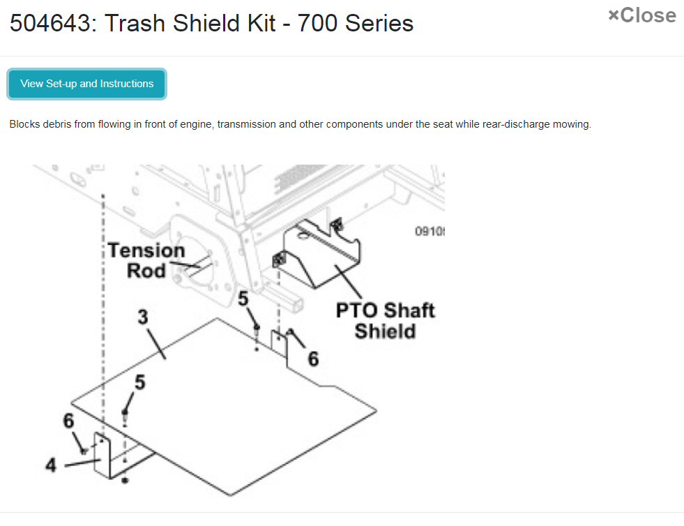

tractorworks, if you don't have this on your 725DT6 I recommend you order one from your Grasshopper Dealer (have them verify this is the correct one). This will help keep debris from making its way to to the radiator screen!
This is interesting. I can't find part number 504643 listed in GH parts diagrams. Is it a new accessory? I mow mostly lawn with my 700's, but also some rougher trails etc. I don't have a flail for them but still get a lot of trash on the radiator screens.
