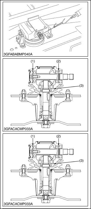

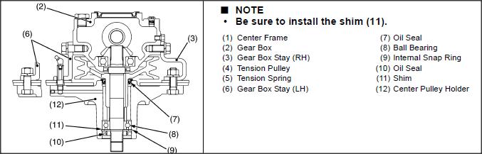

Here's two images showing the gearbox / center spindle design in detail.
Item 12 (What they call "Center Pulley Holder") is more or less the spindle housing and item 8 (Ball Bearing) also acts as a gearbox output shaft outer bearing.
I.E. The spindle shaft and the gearbox output shaft are one piece.
With this design they eliminated one or two pulleys and are able to drive three blades with quite a bit shorter V-belt. However, it does make the gearbox / center pulley "combo" more complicated.

Thanks for the drawings, that is very helpful to see how it's all assembled. I really should spend the money and buy a repair / parts manual for this machine!
