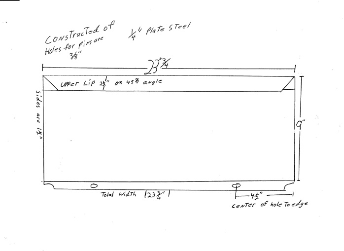

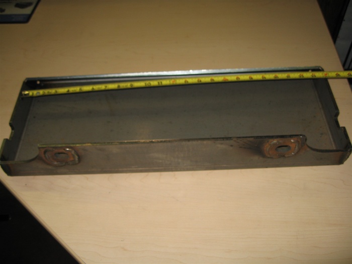

How are you going to attach it to your loader?
The attachment plate on a mini skid steer is only 23-3/4" wide:
Don't know the size of the Bobcat mini MT series:

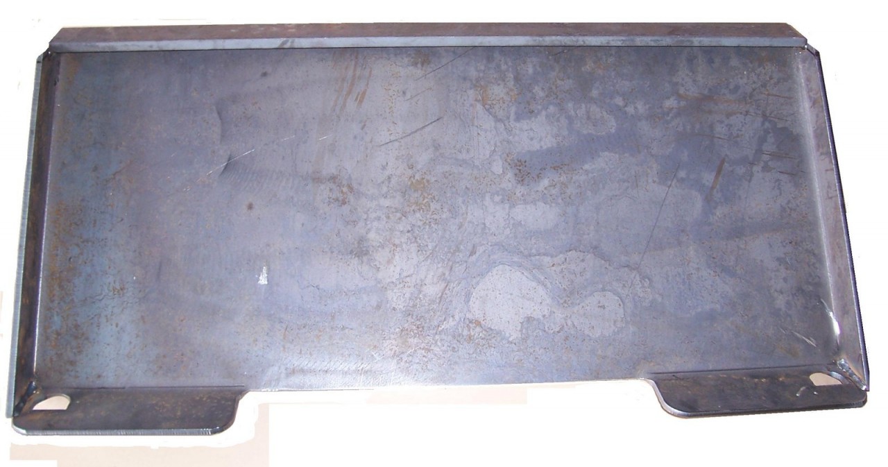

Yep, that is a different grapple than your first link to the mini skid steer one:
The eBay link is for a SSQA:
