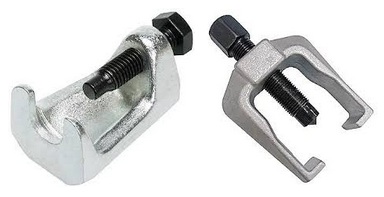

Buy one of these, or make something similar.
Article
FARM SHOW - Simple Tool Solves Hydraulic Pressure Problems
Patent
Patent US744846 - Hydraulic coupler pressure relief tool - Google Patents
I would start by trying a modified tie rod end puller.
