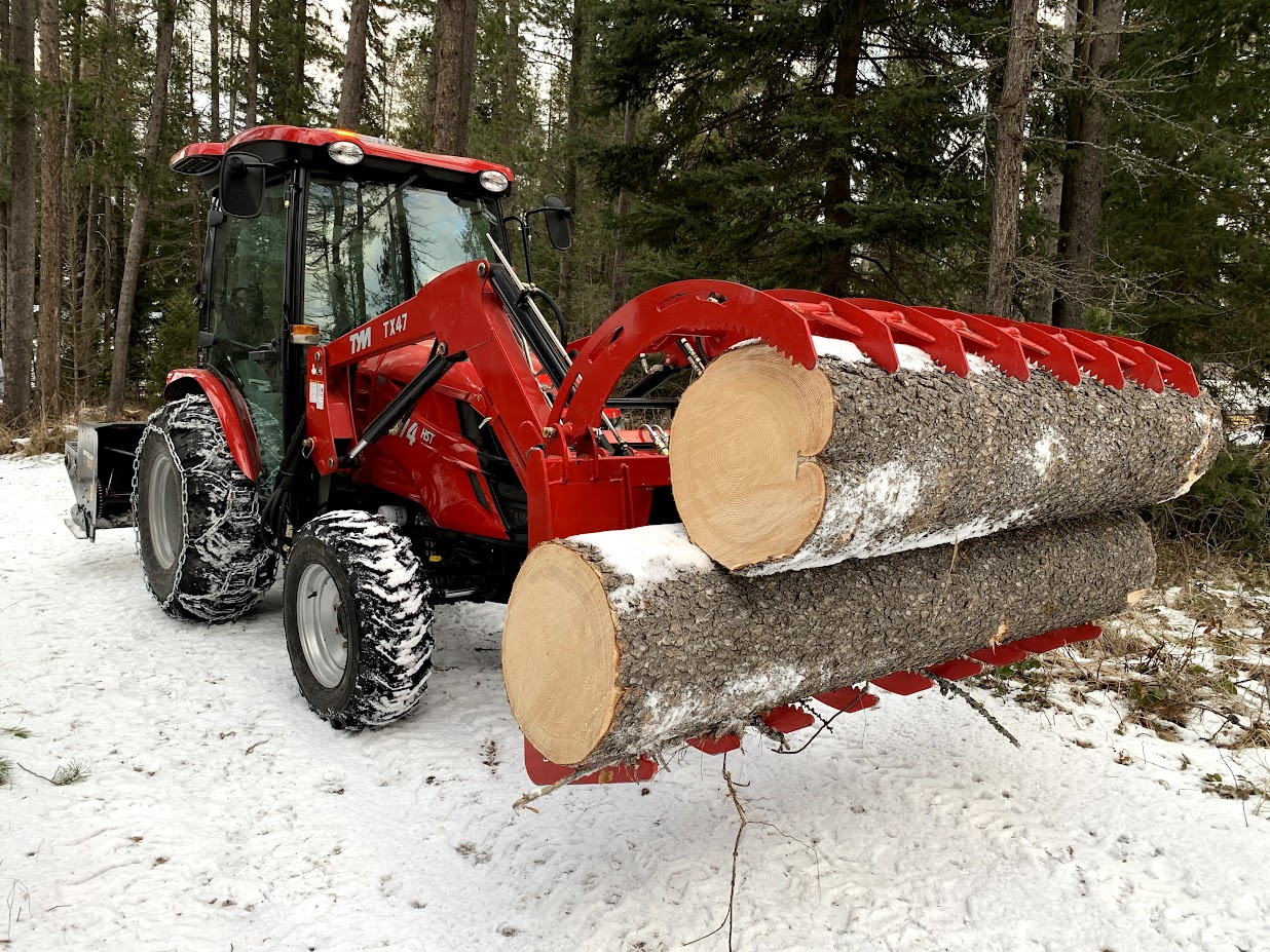

I tried a cheap - $1800 -grapple & it folded like tinfoil picking up RR timbers; so I took it apart and just use if for a rock rake/bucket
Then I bought and waited 14weeks- for my EA Wicked Root grapple 60" Dual lids & this sucker is sturdy and highly capable....Certainly worth the wait. W Antifreeze&water in the rear tires, it lifted a 30'x24" cedar to the burn pile, and is great for downing & moving trees in the woods up to 12"+.
I would suggest going with the width of your tractor or one size narrower for mobility in tighter spaces....Would not recommend going any wider than your tractor- totally unnecessary

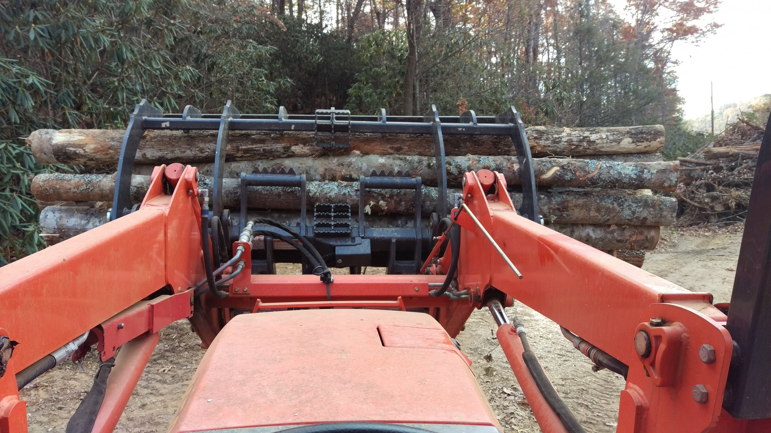

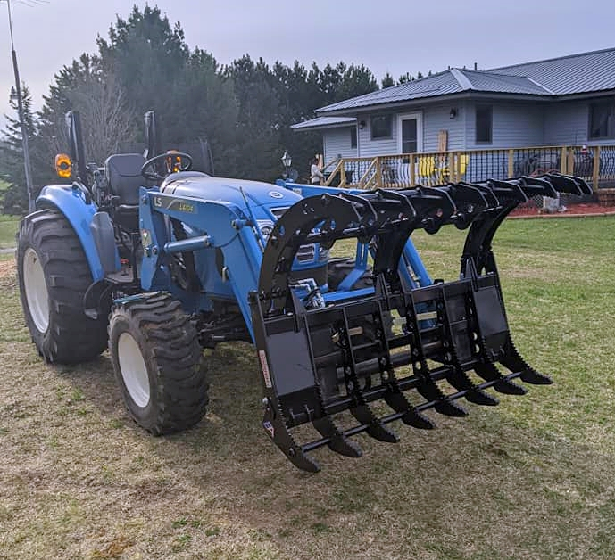

I've been looking to get a grapple (which isn't easy with the backorder situation) for my LS MT3 tractor and have been pondering the pros and cons of the width I should buy. I'm looking at getting a rake grapple and have mostly looked at grapples between 60-72". My tractor front tire track width is 72". I'm also trying to keep the weight of the grapple down so I can actually lift more. I'm thinking a 66" would work OK. Is there some advantage on going wider?

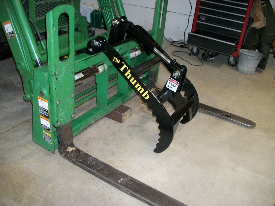

I wanted a narrow grapple to go over my forks to secure logs and brush against the forks. Very happy with "The Thumb" and all it can do. My thinking, is much better to grapple (grab) in the center for better balance of the load on the FEL.
Also is light weight, and I can move it around by hand when I pull the pins to remove it, or mount it. Plenty robust for my 430 FEL and JD 4300 tractor.

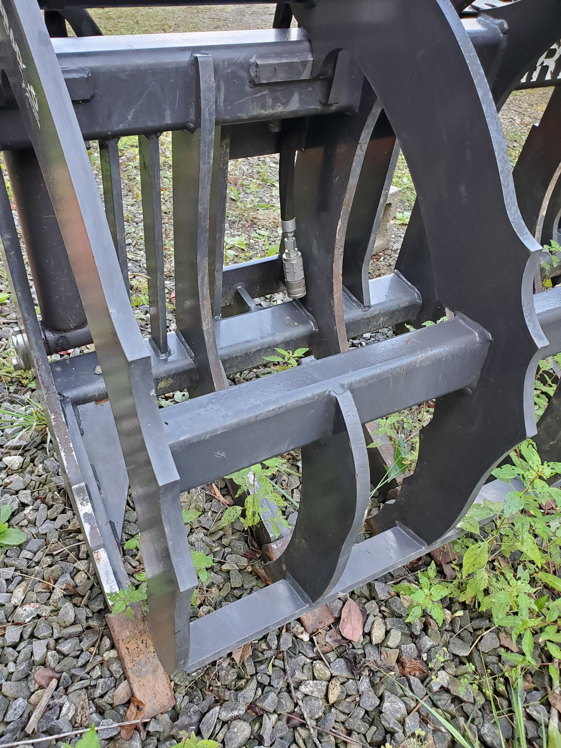

/ Grapple width #33
It is not lighter; it is stronger and considerably more capable;
Saving a few pounds on equipment that will not perform as you need is wasteful and will be disappointing, as it will not be able to do what you bought it to do.
Do you use deWalt quality or Harbor Freight; do you trust Duramax or a kia.....you have to choose. Different quality & $$ levels have short and long term benefits.

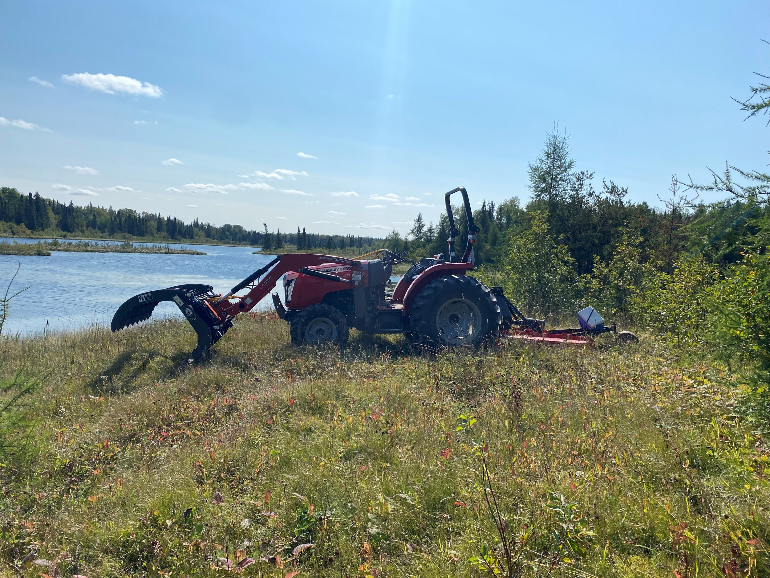

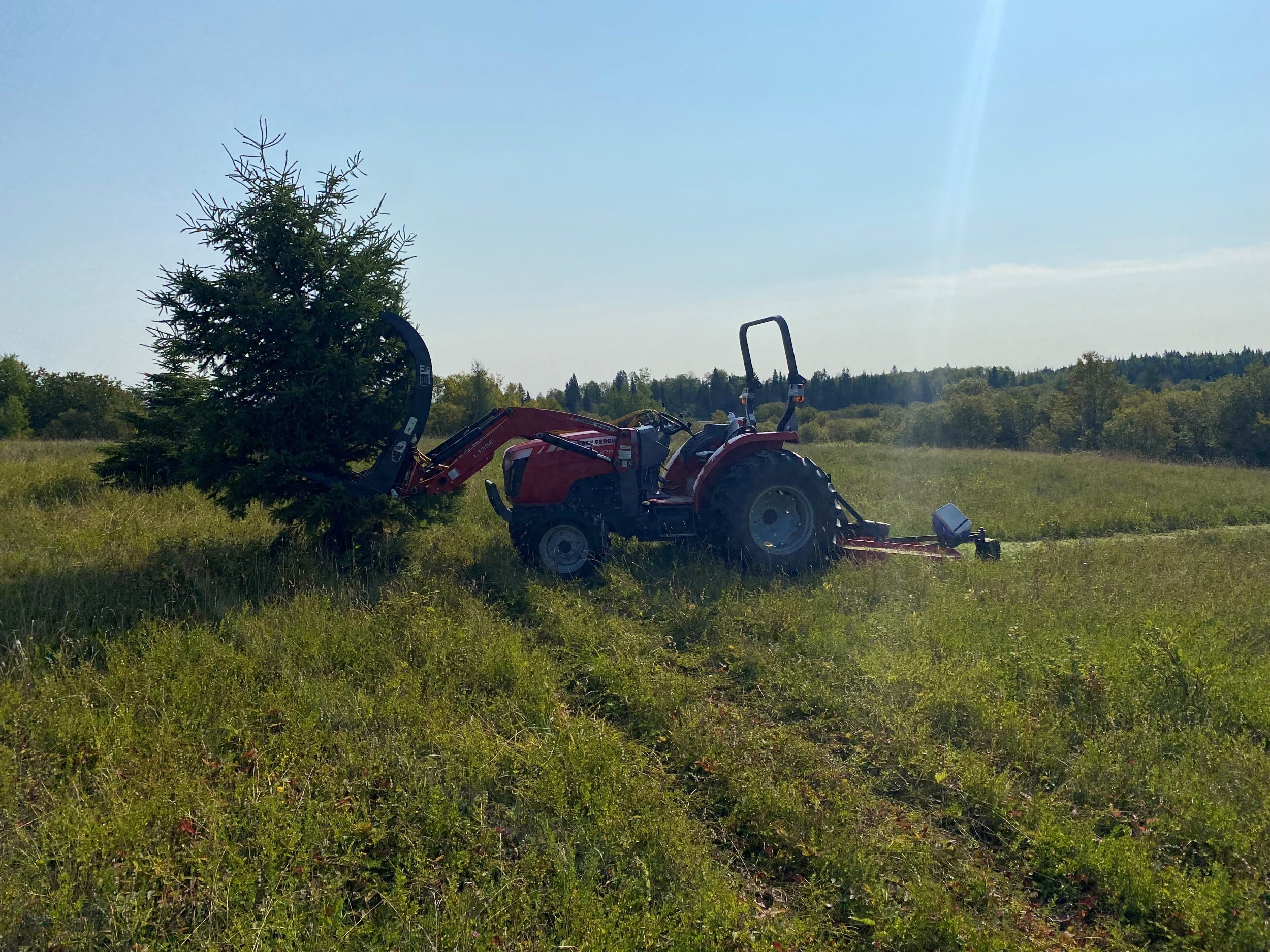

There is a huge advantage to going wide. I use my 72" wide to grab brush and it wouldn't be the same if it were only 60 or 66" wide.
/ Grapple width #35
The width is needed for maximum grapple brush width effectiveness.
Brush is so light that if it weren't awkward I'd prefer a 96 or 104" wide grapple.
That same grapple in that picture has picked up a 40' telephone pole with ease and also a 20' x 20" diameter solid oak log that was heavy enough to tip over the tractor if I wasn't very careful.
That's a land pride grapple. Made of ar400 and I have bent several tines, even the 1/2" end tine. Not sure how I did that. It is about 400-450lbs.
