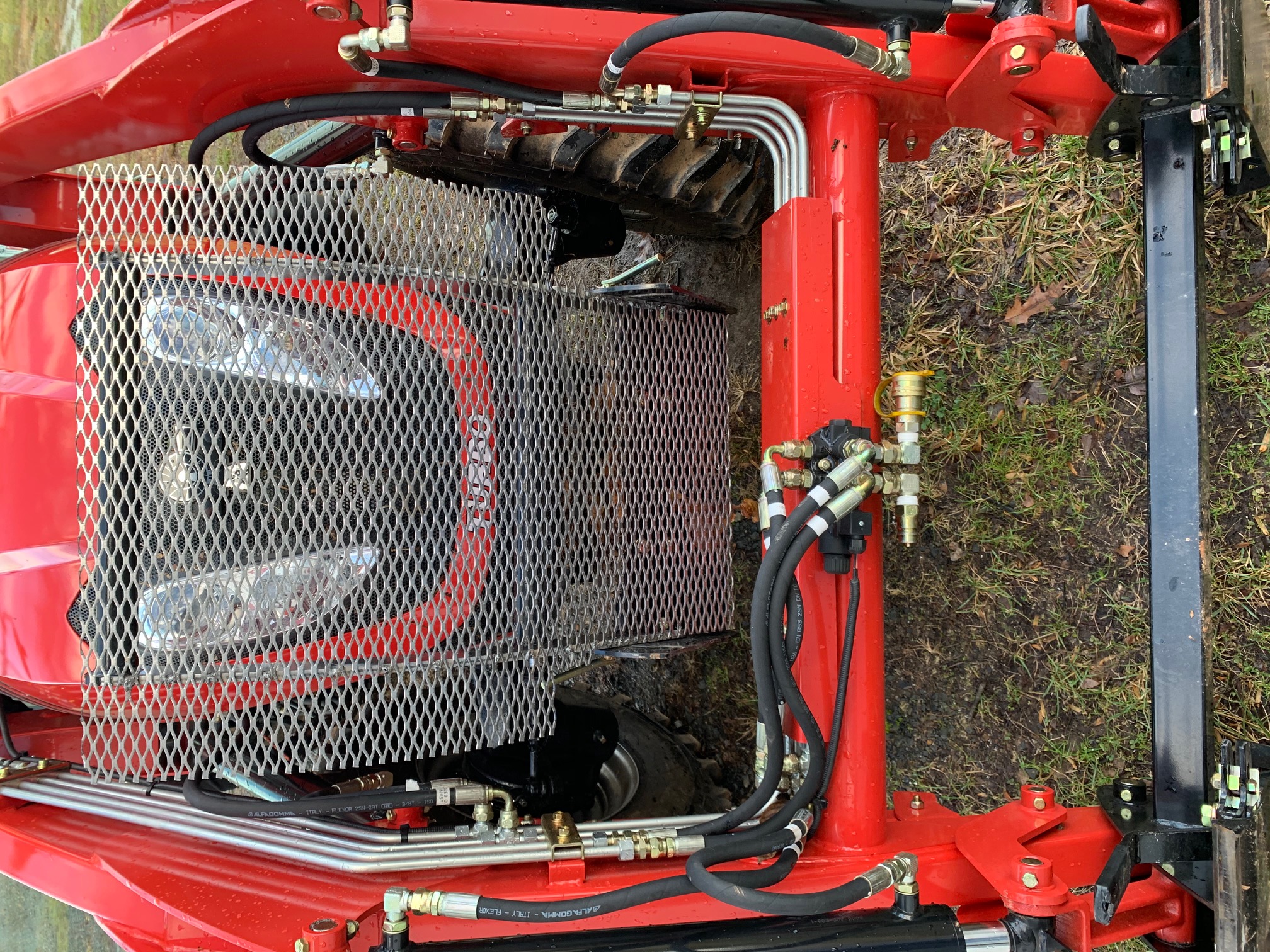

Better frame that expanded metal in with some angle before it cuts somebody to shreds.
/ Grapple question #26
That guard/shield really looks sharp! Would you share some dimensions so I can build something similar? My RK 55 purchase is still a ways off, but I'm trying to plan ahead. Which grapple did you get, I think I missed it in the threads? Thanks very much.
