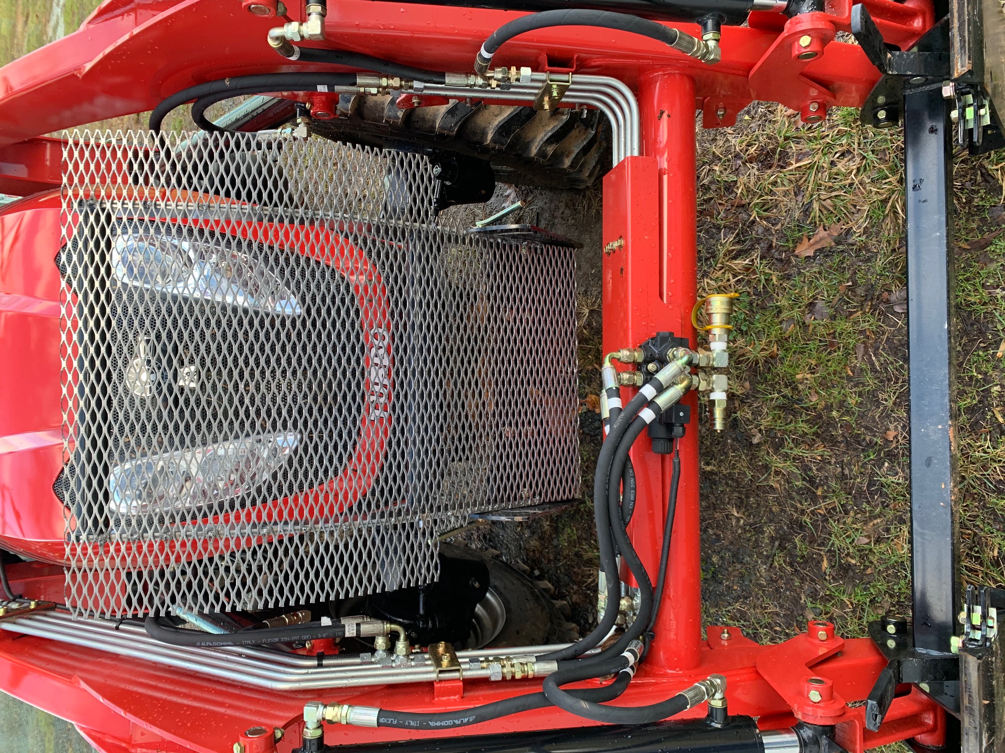

BTW - BEFORE you start using this grapple consider doing something like this to your OEM grill guard. Any old stick, stob or branch can raise real havoc with your grill, radiator or battery.
Ok: done! (still need to "pretty it up", but it will work for now...)
/ Grapple question #15
Never thought about mounting the diverter valve there. That came out pretty neat.
Better frame that expanded metal in with some angle before it cuts somebody to shreds.

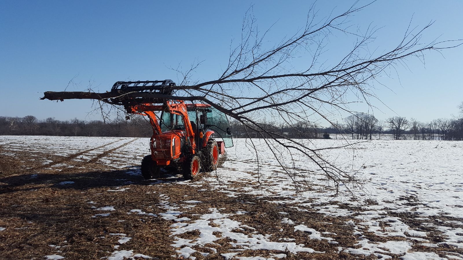

I have been using my 55" Wicked Grapple. Here are some pictures of what it has accomplished:
As we have been cleaning brush, we have found long forgotten equipment and I have used the grapple to dig them out and move them to the found equipment pile so we can sort through what is worth keeping and what is heading to the scrap yard. I don't have pictures of it, but I used the grapple to take down an old hog house and move all the scrap wood to the burn pile.

Thanks for all the replies and pics. I'll definitely go with a lighter weight grapple. I too like the lower tooth design on the wicked grapple. TractorGuy, the mounting position of the third function valve in the pic is the stock position that RK mounts the valve. At least on the RK55 and 37......Don
/ Grapple question #19
Was looking closer and was confused by the connections. The valve I put on my JD looks identical but the normally open path is straight through. RK must have a special version to get the NO ports on top.
