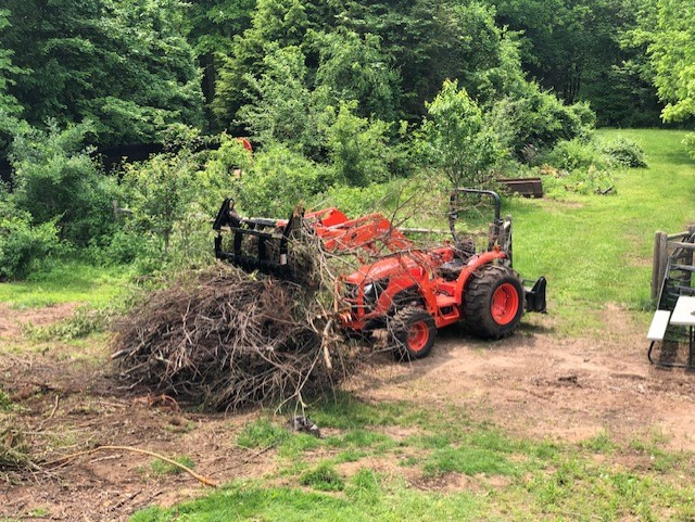

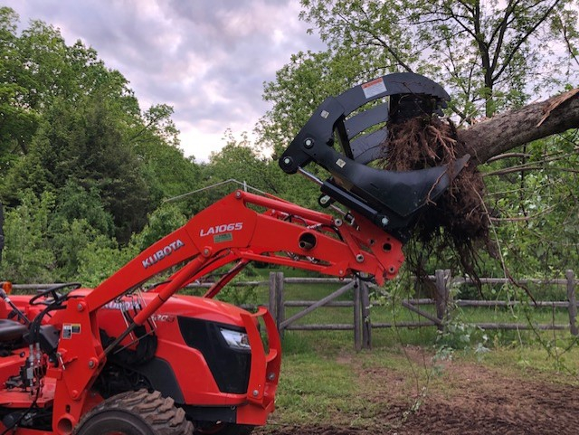

I have a LandPride 1572 on my MX5200 and it works fine both for grabbling brush, digging rocks & light stumping (up to about 6") the clam shell is stronger for digging as the lever arms are much shorter

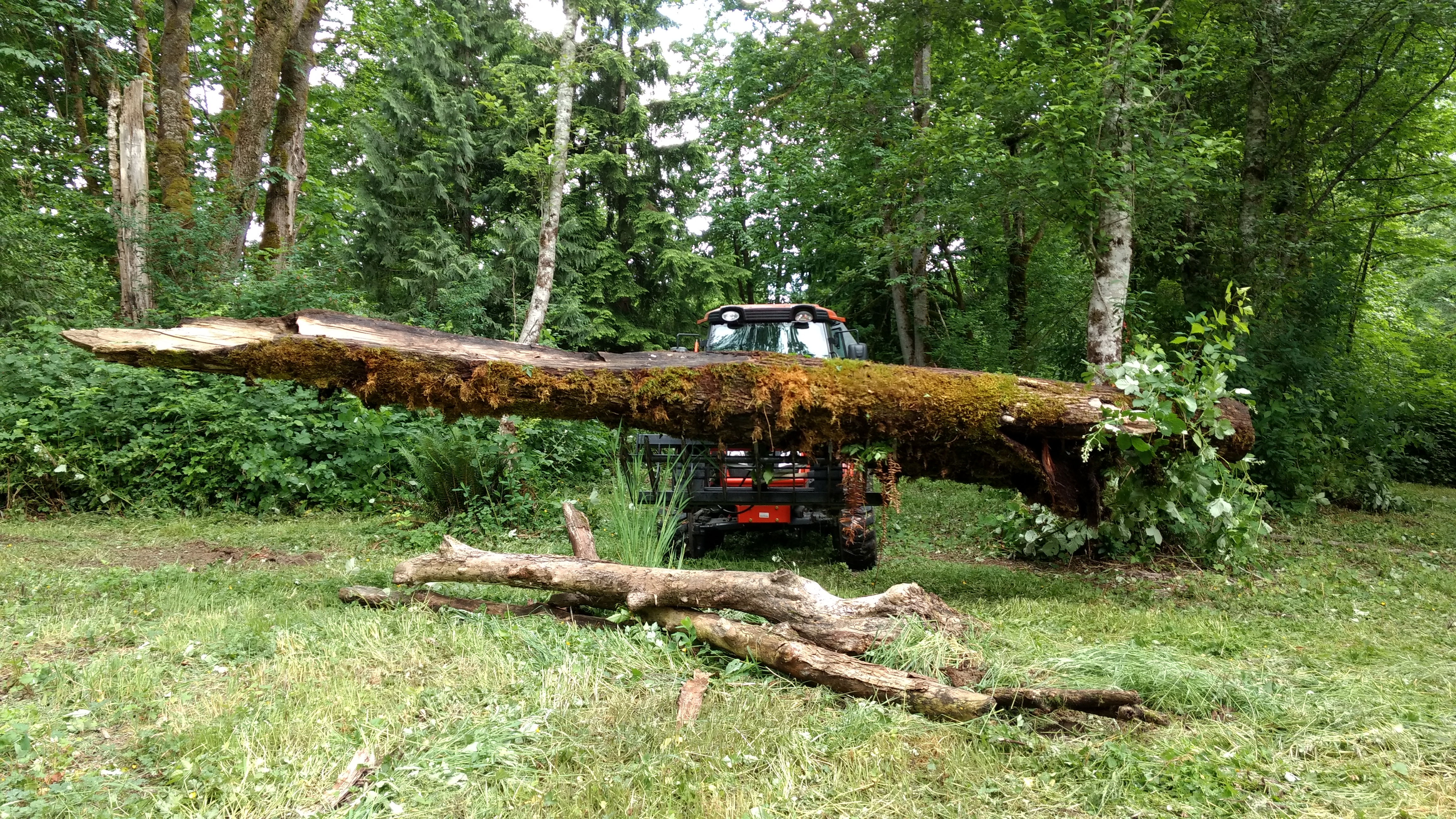

I don't do much in the way of rocks. Lots of branches, AND, tree trunks (IMO, wide works better in such instances):
