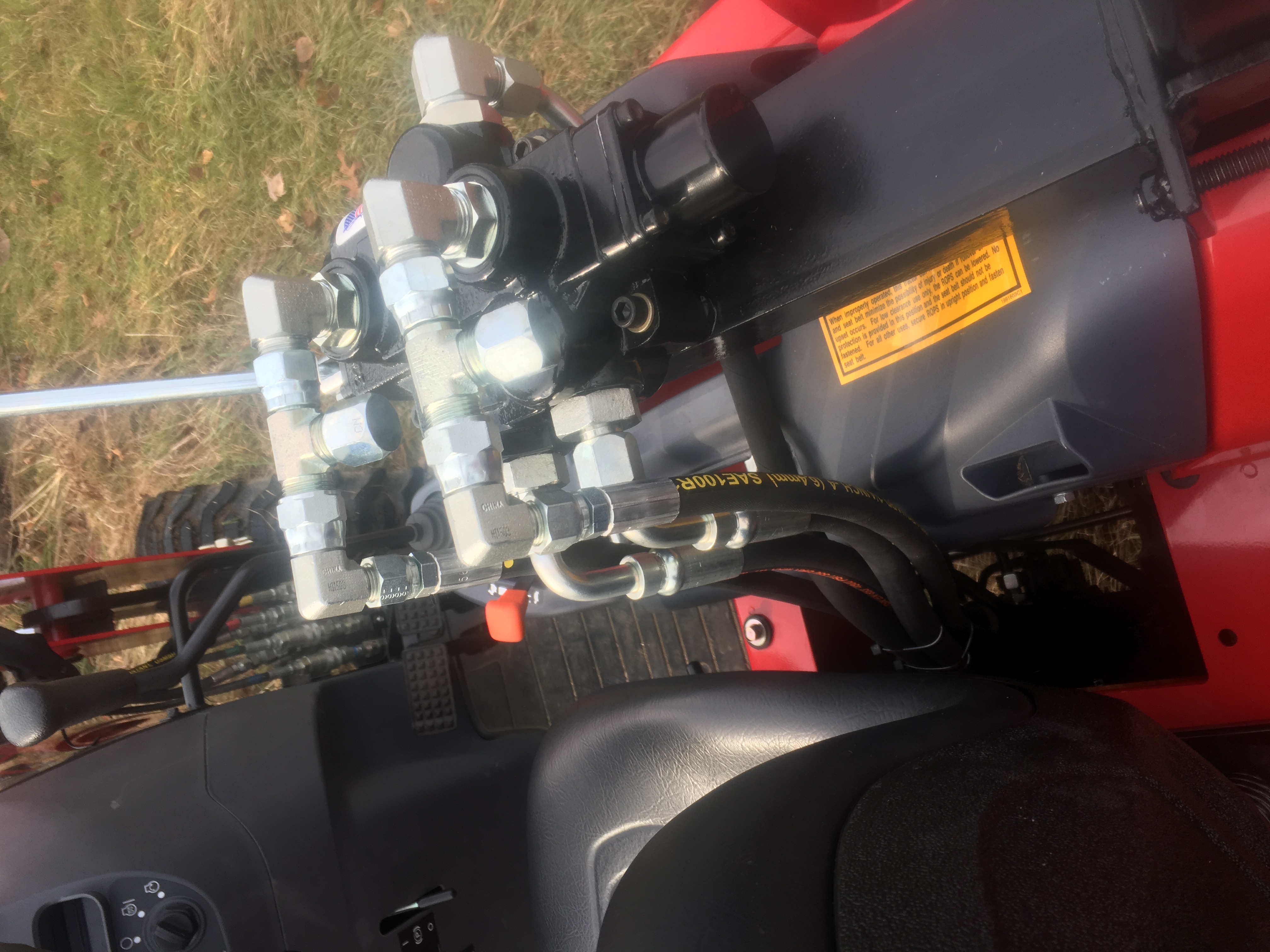

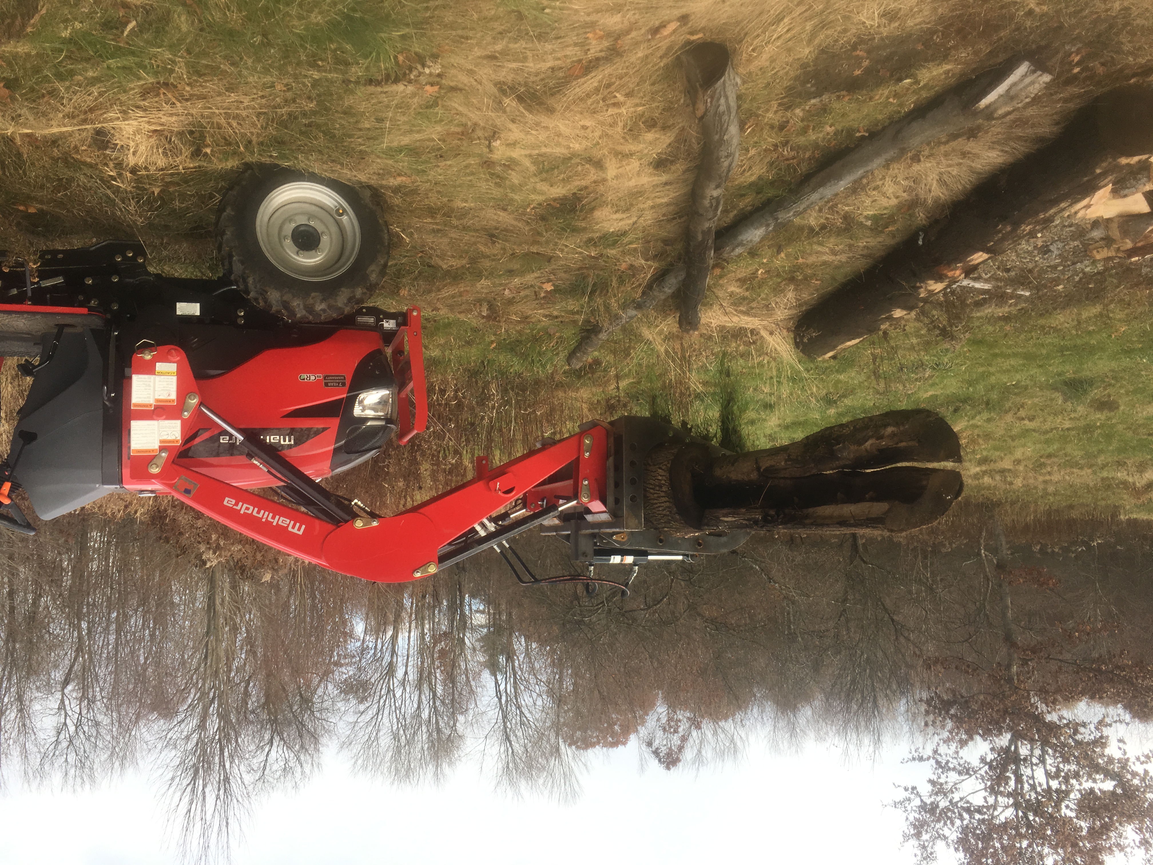

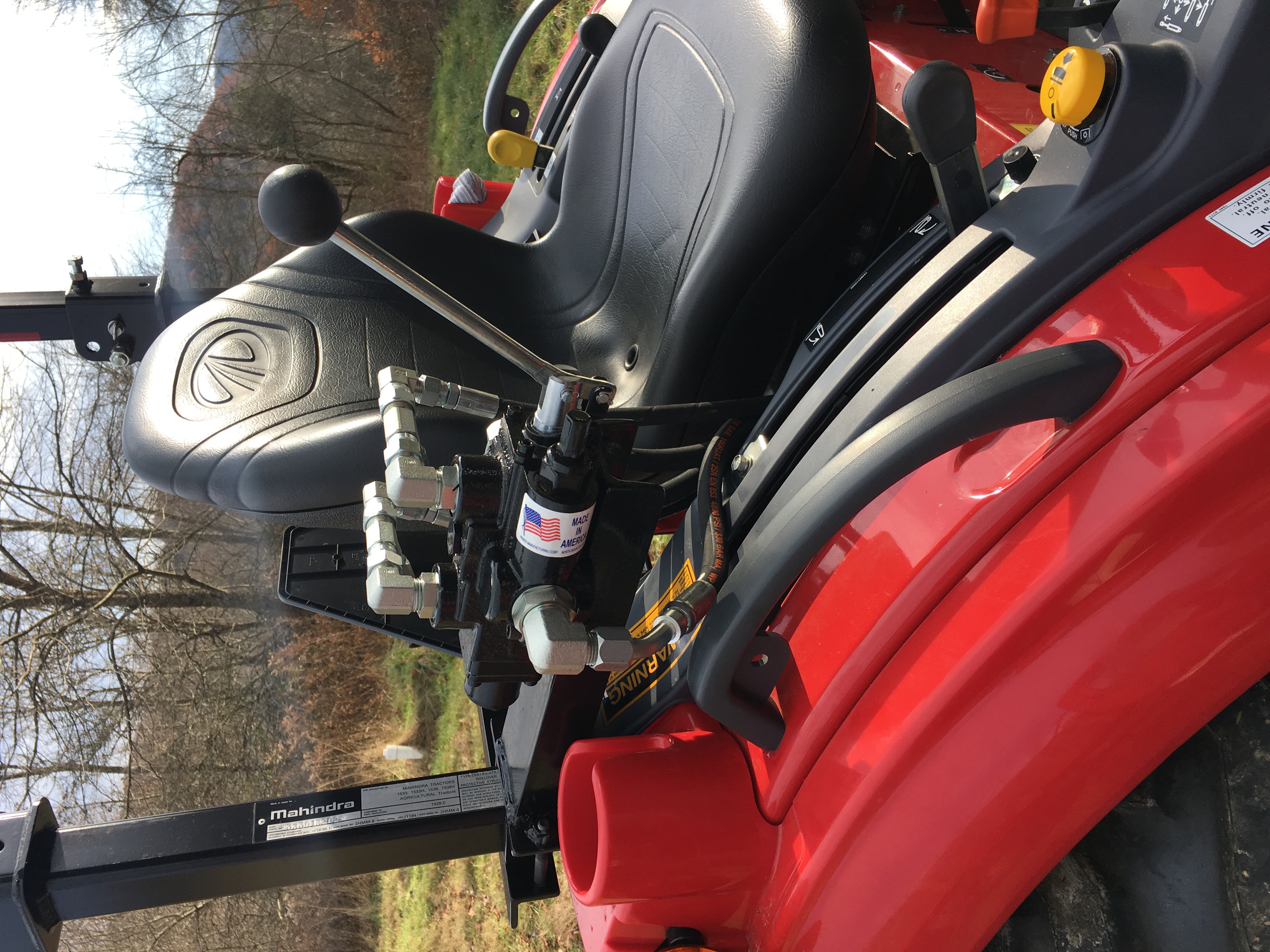

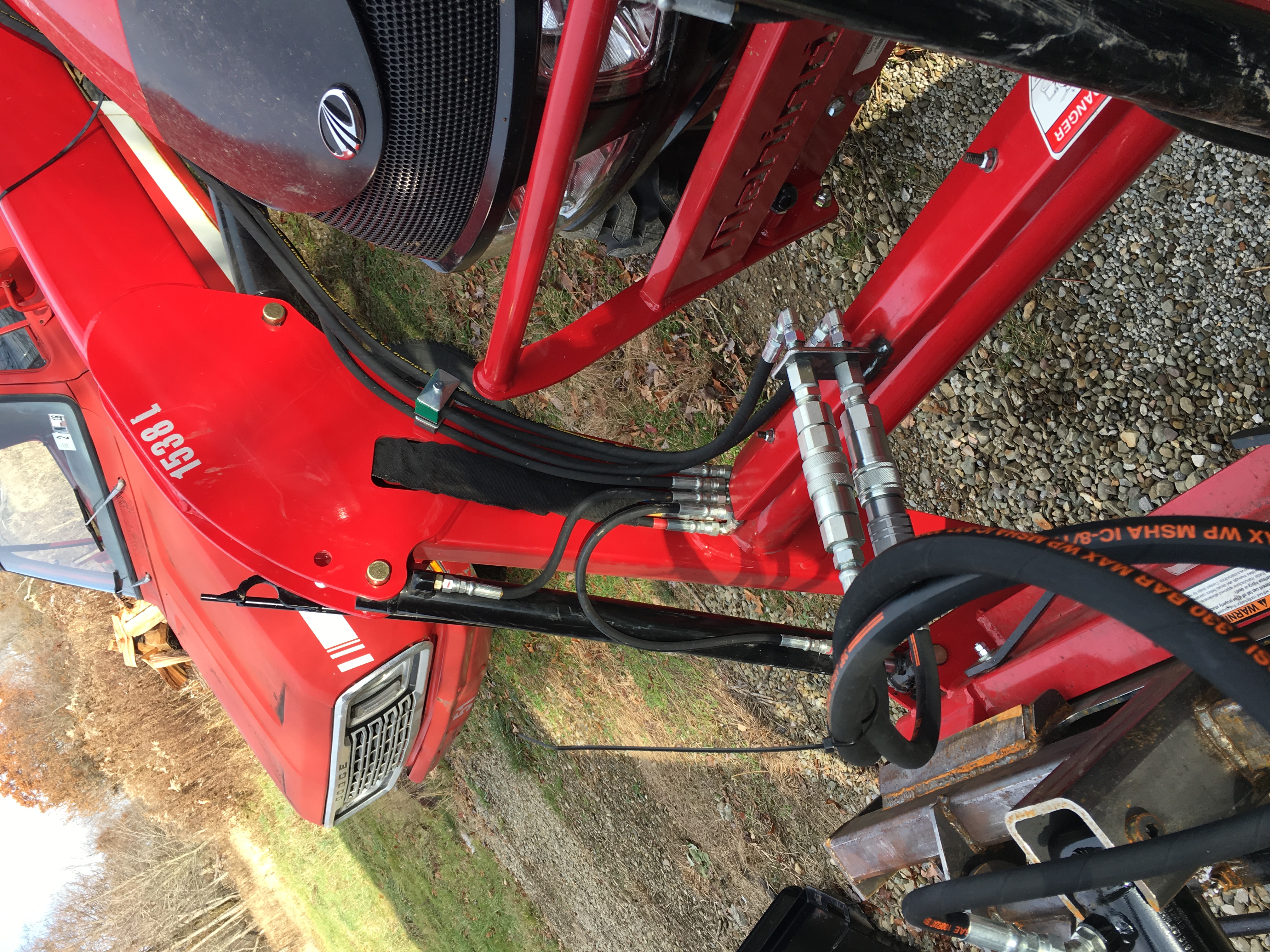

IMG_1413.JPGIMG_1414.JPGIMG_1417.JPGIMG_1420.JPGWell I finally finished the hydraulics on the tractor and got to spend the day moving logs. Pretty happy overall with how it turned out. Have to touch up the paint where I welded the quick connect bracket to on the front of the loader. I attached a few pics showing my remote valve and plumbing setup as well as one with a good sized log clamped up.
/ Grapple project
#26
Thanks. Overall I did save some money over buying factory made grapple and building my own remote setup compared to dealer installed. But money aside it was a good project and took longer than I’d have liked but that’s primarily because tractor is located 40 miles away and I only have weekends to work on it. Now it’s time to cut a bunch of firewood !
If anyone wants more info on the hydraulic hookup just let me know and I’ll be happy to share.
