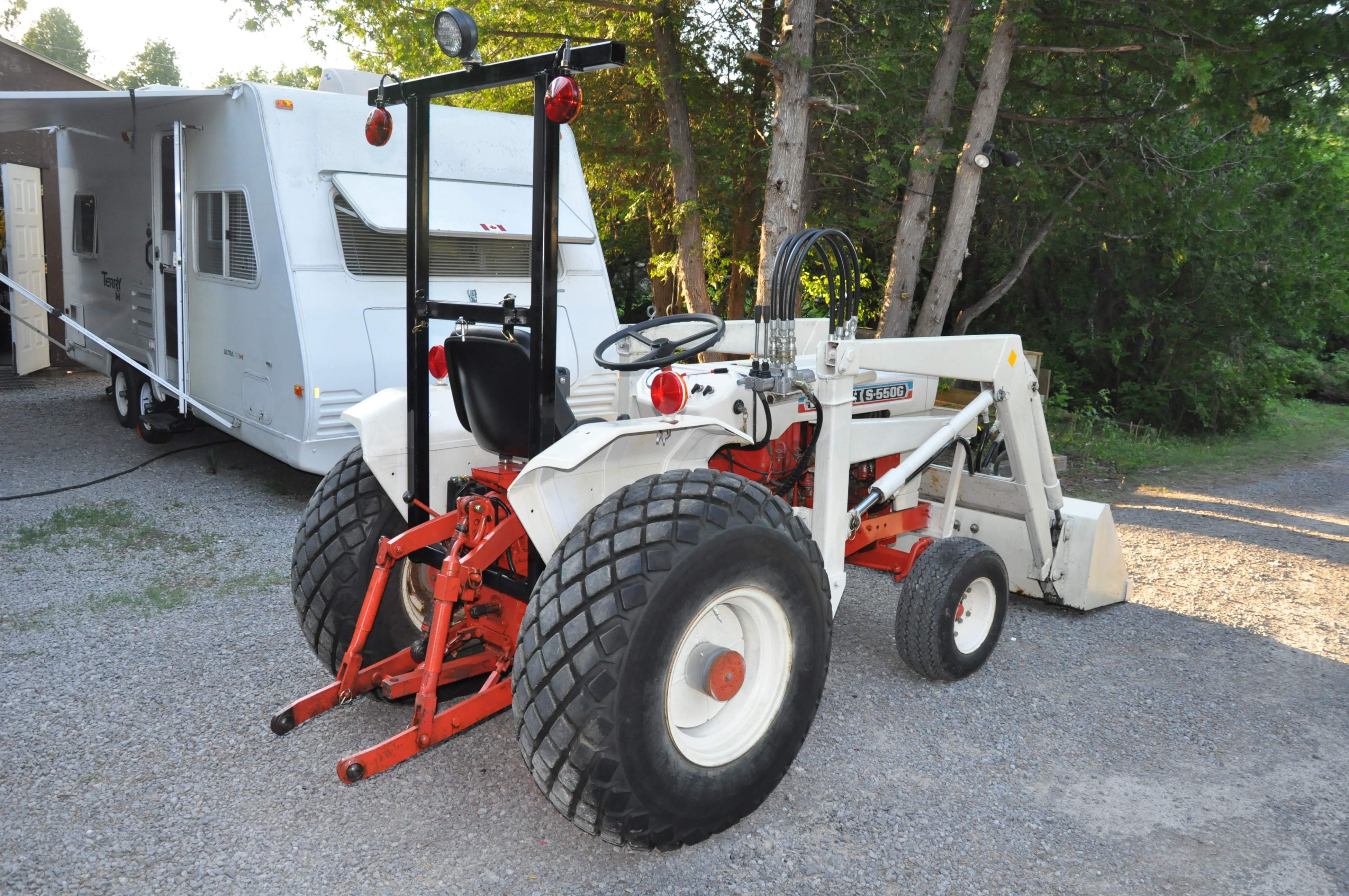

/ Semi-DIY ROPS #24

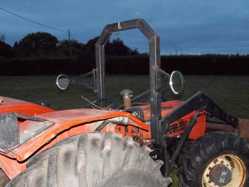

I made my own ROPS, and integrated it with the FEL.
Because the FEL frame is already there, and (after some modification) extremely strong.
Because the tractor is 4 tons, and I can't do all the clever engineering, I just made the ROPS very strong too. It's 90x90mm (3-1/2") thick wall steel tube. It pivots on the 30mm (1-1/4") FEL pins, and is locked upright with 25mm (1") rods.
Oh yeah, after many breakages of store bought ones, I made the mirrors too. They can fold in either direction and are made from 1/4" thick steel pipe caps.

That is GENIUS, that rops is so strong you could build a small house on top.
By the way, you also now have an option to send some thinner pipe or tubing to the back horizontally to make a Baja type cage for a roof top keep the rain and sun out and also suspend fabric on sides as needed to cut back on the beating sun or side rain.
/ Semi-DIY ROPS #28
Thanks; it does pivot down (forward), to get into the shed where I usually park it.
It's a bit heavy to lift by hand, I usually raise it with the FEL (the rops sits on top of the FEL arms when it's down). When the FEL is fully lowered, the rops rests on the front of the engine cover.

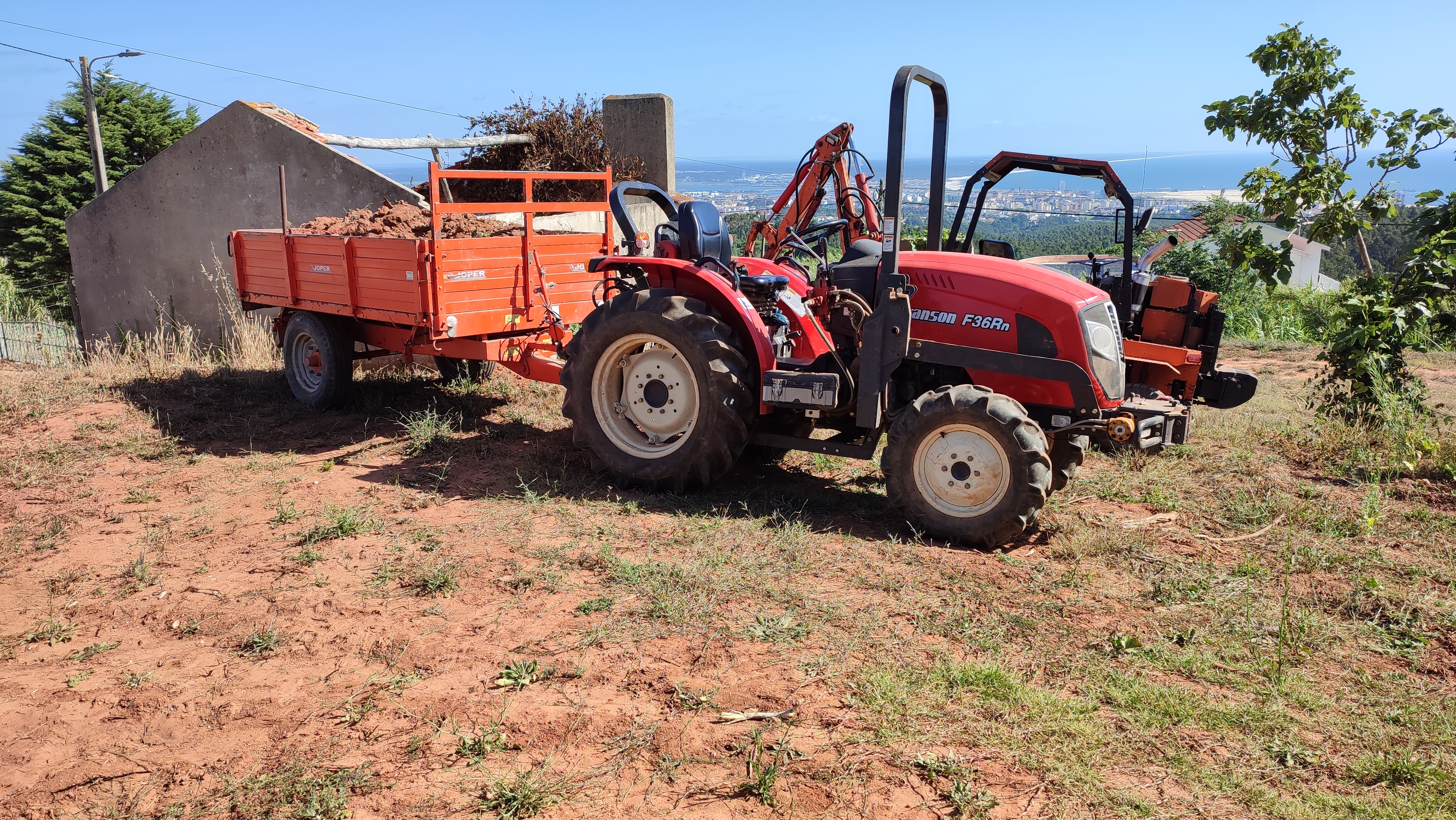

Definitely a fan of the mid mounted ROPS. Really useful to work under trees. Wouldn't want a tractor with rear mounted anymore.
Due to an European directive where the ROPS have to be easy to raise and lower, the newer tractors (2018 and on) even have gas springs on the ROPS to help raising the ROPS. You can pretty much do it with the tip of your finger. Wouldn't mind having that at all.
View attachment 5071939 View attachment 5072294
How will that prevent the driver from being squashed in a roll-over since loaded rear tires make the back of the tractor heaviest?
The mid mounter ROPS work in conjunction with a smaller/shorter ROPS in the back (see red line in picture). In case of a full roll over, it will more or less create a cage that protects the operator. Will the operator get a bit tight to the steering wheel? Sure but will still protect him.
