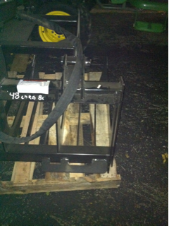

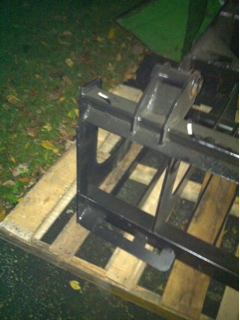

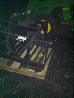

I used the grapple extensively this weekend. I am still working on my technique but I now know why these things are so popular! What I got done was amazing! Again thank you to all who helped me out with this. Gator made everything right on my end so I have nothing to complain about.
One note about the wr long valve (which works great with the grapple) is that mine came with hydraulic connectors one size smaller than those that came with the grapple- so when ordering one or the other you probably want to check that out first.
Figure I would include some pictures...
