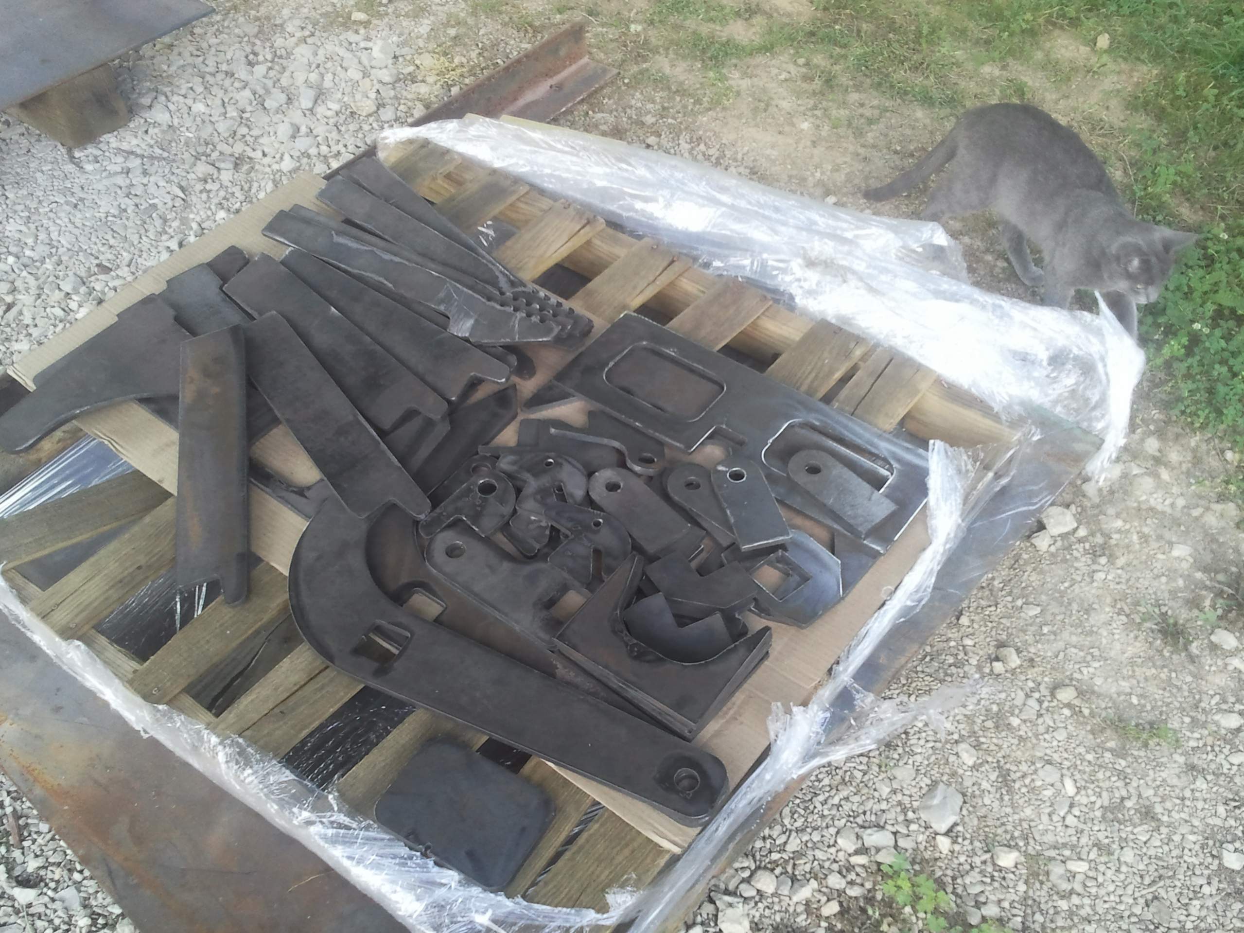

As far as expenses are concerned I have about $416 in the cut metal. It took almost a whole 4x8 sheet of 3/8 mild steel.
The cylinder and fittings to the quick connect were about $150.
The bolts nuts and washers were about $30
I have used about 7lb of welding rod and half a knotted wire wheel as well as a grinding wheel and die grinder stone so that's about $15
The steel tubing was $80
The paint and primer was $18
John deere quick tachometer parts were $78
So my total cost not counting labor was $737
I probably spent $50 in fuel to get everything together and I've got about 30 hours in it. If I were doing this commercially I could cut my costs by about $50. Even with a better welding setup with jigs and everything it would still take a day to build so I don't think anyone could cover their costs by selling this for less than $900. That doesn't count overhead either so a better number would be closer to $1100.

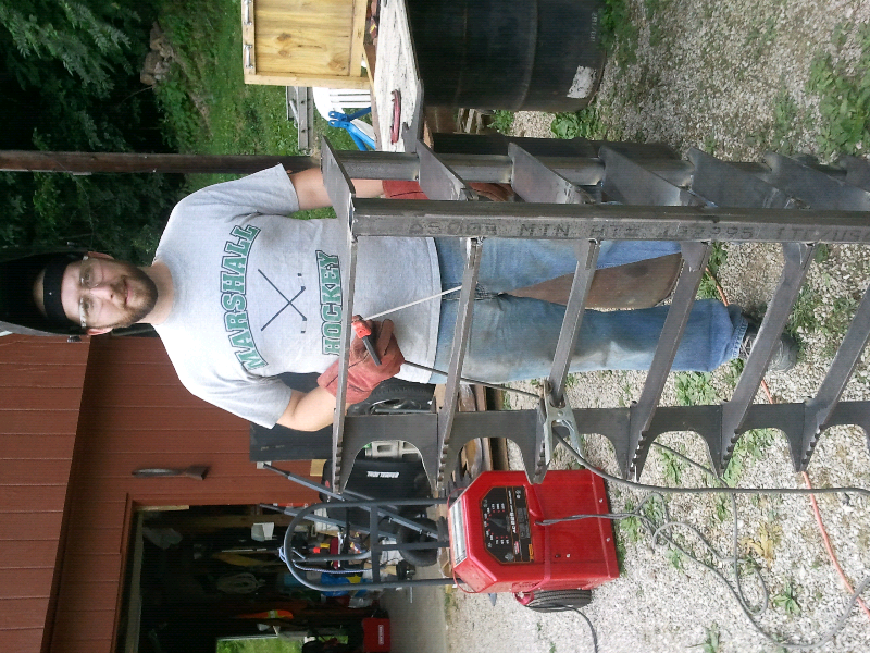

I'm using a Lincoln ac only buzz box. I wish I had dc capability. 220v 50a
This is the only picture I have of it.

There is a lot of good talk about buzz boxes in the Welding forum. I'm shopping for a welder right now, but I'll have to wait a month or so until my new grapple is paid for. It's nice to look back at your work and know you built it. You should be proud. Nice job!

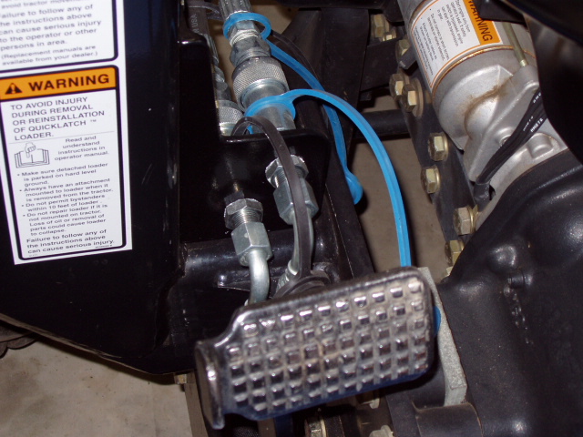

Are you changing the hose ends to 3/8 (#6 JIC) female swivels?
If so, I would use 2404-06-06 QC to hoses, grapple cylinder , 2501-06-06 hoses to grapple cylinder.
2706LN-06-06 Bulkhead fittings with a bracket similar to picture two in post #28 for tractor side QCs to hoses.
Six fewer fittings to do the same thing. Part numbers are from D.H.H.

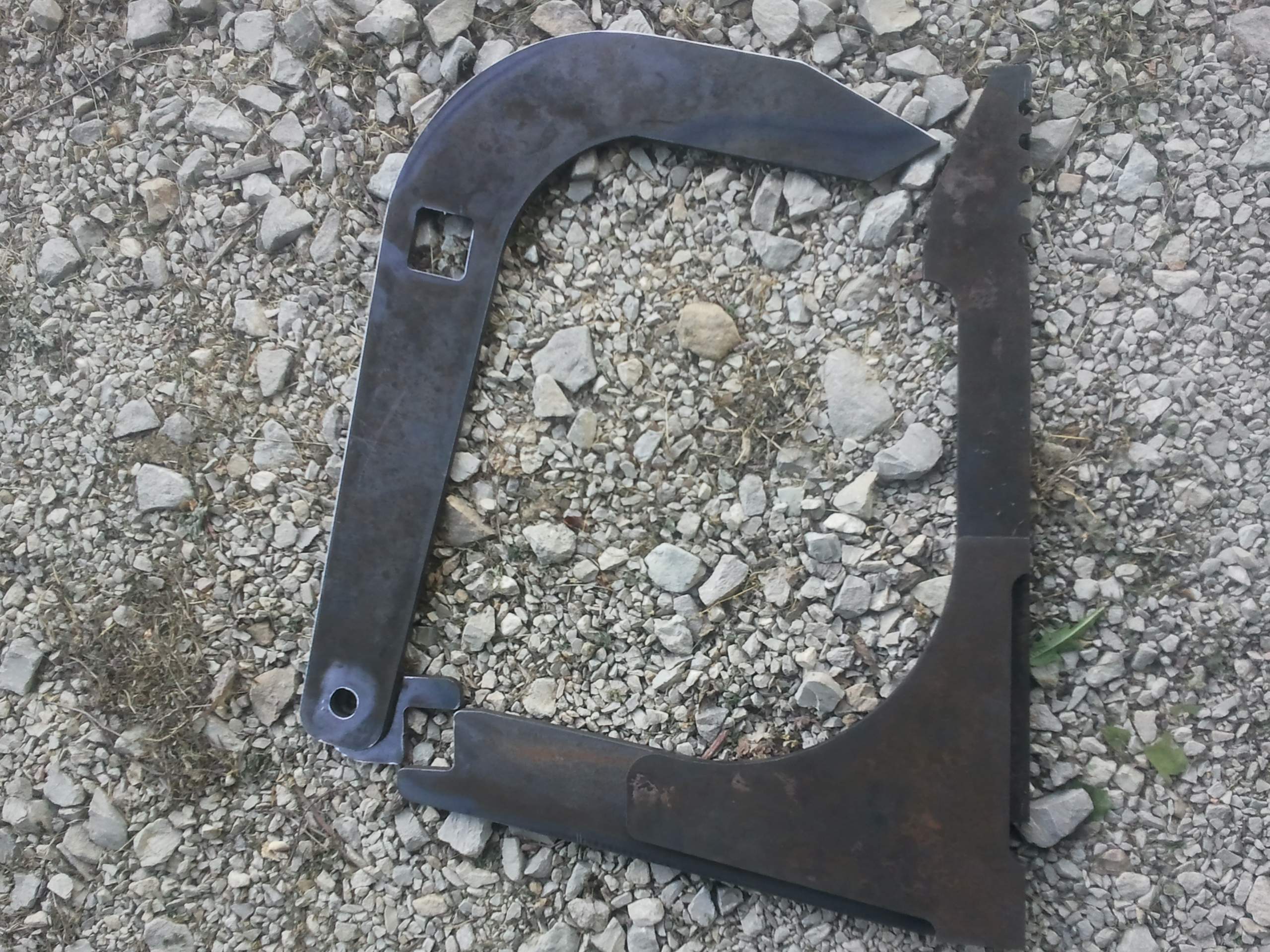

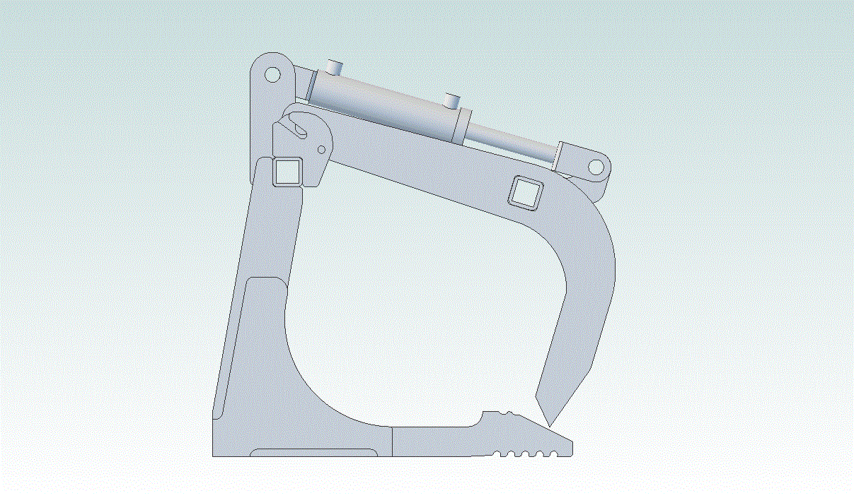

Pardon me for dumb questions but at 1026 Deere is approximately 25 hp. The grapple your building looks heavy enough for a 40+ hp machine. If I were building a grapple for my 4110 ( 21hp ) I would use 1 1/2 or 2" square tubing with an 1/8" wall. This is strong enough with a few gussets to withstand the abuse of the above machines. A 22' stick costs roughly 46 dollars. For $125. to include a scrap of sheet for the back plate the majority of the frame work would be complete. I would segment the grapple hooks with tubing and add 3/8" x 1 1/2" metal to the bottom side for additional strength at the welds and act as a contact for the brush / material your moving. The lazer cut pieces are top shelf in looks and durability but spendy for individuals like me who enjoy fabricating out of our steel surplus pile.
Like the thread indicates if your going to copy an existing design down to the lazer cut pieces your not gaining anything but welding experience. Fab shops have the equipment and get better material prices than single one time buyers. Many good comments and information exchanged.

One consideration of my design was that I wanted to be able to put it on a bigger machine when I get one, but thanks for the info. I agree with you. If it turns out to be too cumbersome I can always build another one :)

We'll see what happens after testing, but my calculations say it could be made from 1/4" mild steel and still endure the loads it will be subject to. That would reduce weight by about 80 lbs.
