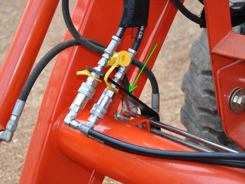

I'm going to fabricate some brackets and get everything mounted then I think i'll haul the tractor to our local hydraulics shop to get all the fittings and hoses I need. I'm planning on zip tying my hoses to the hard lines that run down the loader arm and either buying or building a bracket to hold my quick disconnects. Any suggestions on how to hold the quick disconnects?
/ grapple hydraulic setup 1026r #5
I would use bulkhead fittings to mount the quick couplers. Get the same type of threads as your couplers and hoses. You will need to make a bracket for the bulkhead fittings.
/ grapple hydraulic setup 1026r #6
with a 3 amp draw probably don't need the relay and could just wire direct from switch to valve. I include two pics I saved from an old post that shows how one guy mounted his quick disconnects. The first is a good pic of the bracket, second is of the bracket mounted. Send some pics on how you mount the valve. I have the same valve and am trying to find a way of mounting it to the FEL on my Kubota L3400HST. I plan to tap into the lines were the rubber hose connects to the solid line. Can't figure a way to mount it without welding or drilling into FEL arms. Like to see what you come up with.

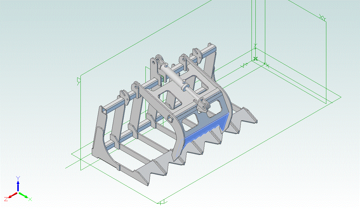

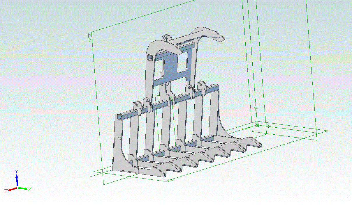

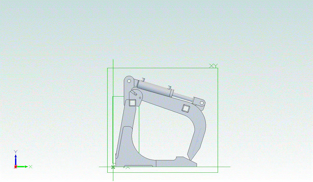

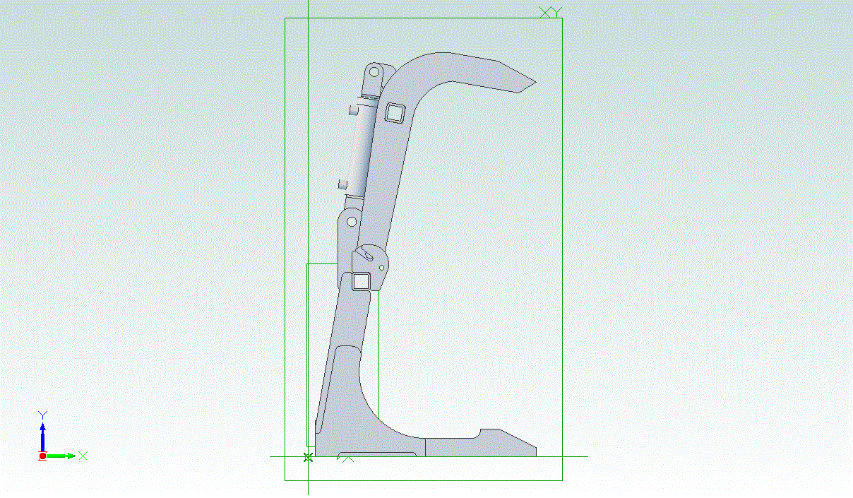

After 11 hours Cad work is done for the grapple bucket! I sent the nested parts drawing to the plasma cutter man. Next week may be bucket fab week!
#17
Here are some pictures of my design. I added teeth between the two front tines so i could pick up firewood while facing it instead of being beside it.

Will the added teeth affect your root rake ability?
#19
I'm not really sure how it will work. I assume it'll be like having a big ratchet rake on the front. I copied it from a toro dingo grapple I liked. I have a backhoe, so digging out roots isn't a huge priority for me. I mostly want to use this to clean up brush, trees, and construction debris.
