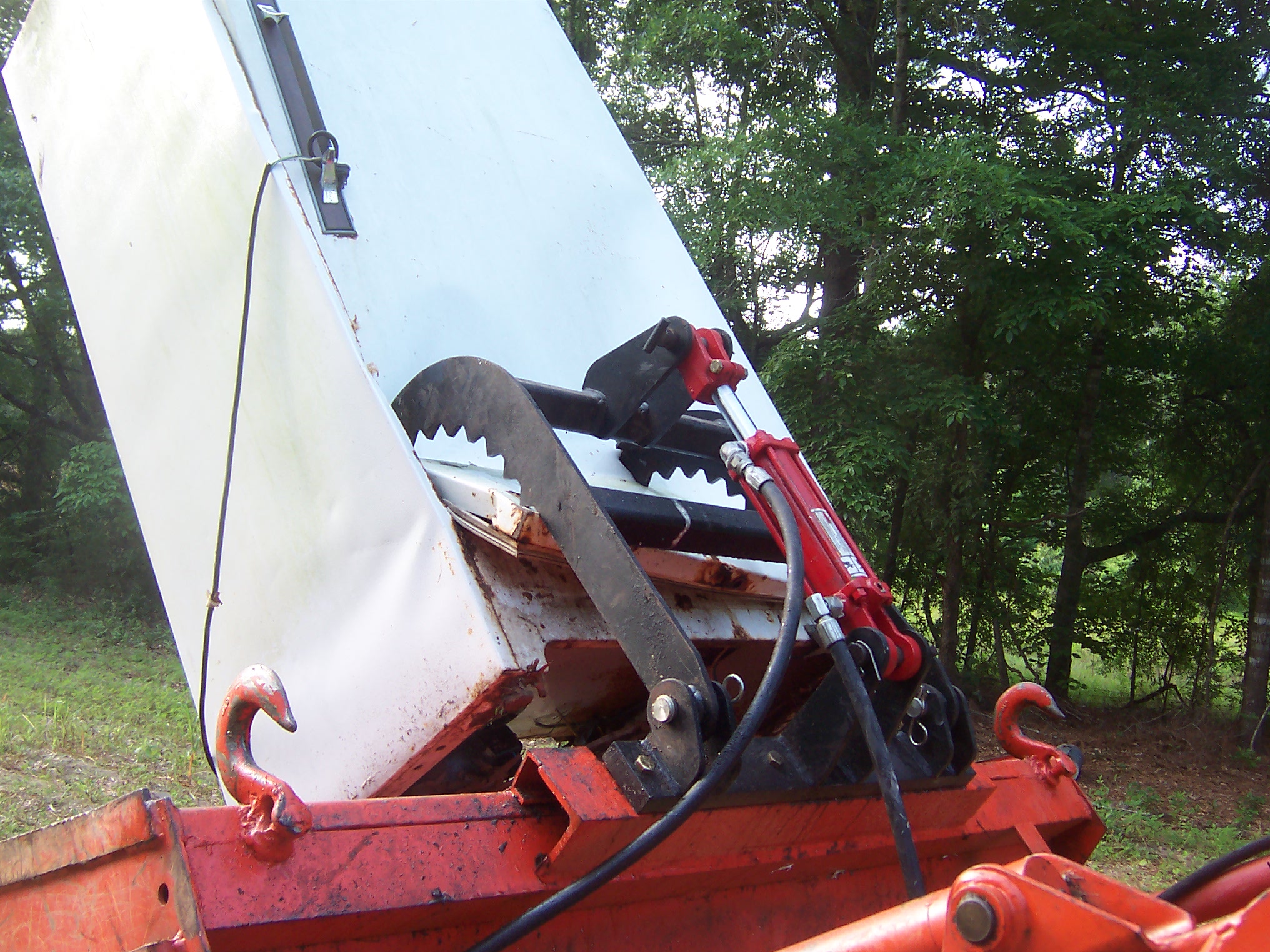

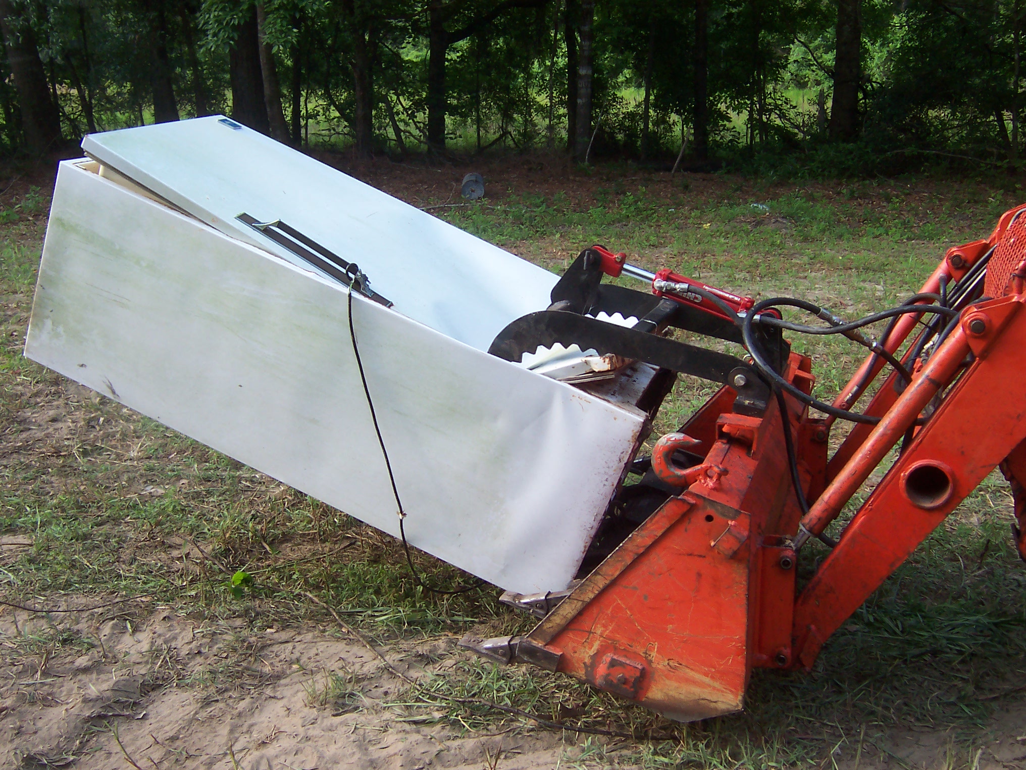

Was cleaning up some property this morning. When moving old fridges it would either squish the door in when clamped or punch into the sheetmetal a few inches.:D
Well those pictures sure proved you got it working!
