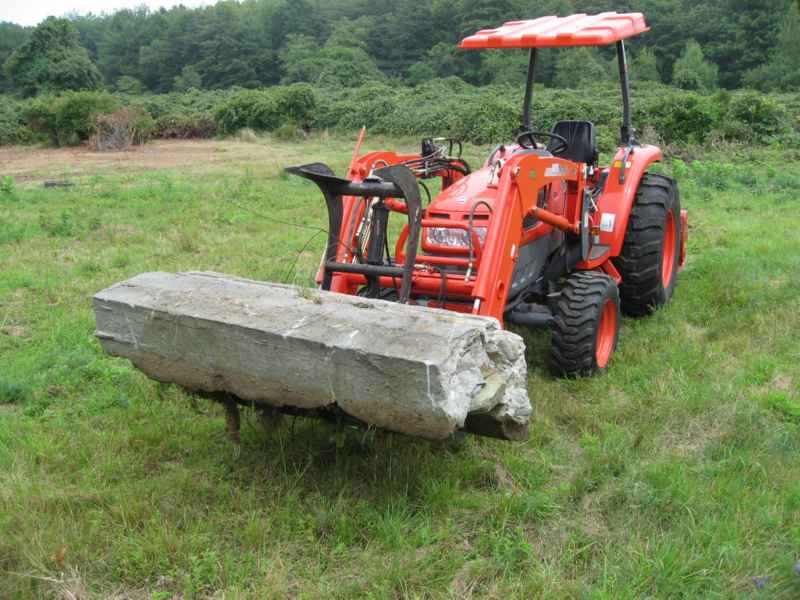

I'm not sure how much a five or six foot length of "Jersey barrier" weighs but I could pick one up with my 48" Light Duty Millonzi grapple and Kioti KL401 loader without any trouble on the grapple or loader end. My rear was a bit light for comfort however even with a 500lb mower so I just kept the load low as I moved it. See photo.
I'd say that was well more than 1000lbs and that there would be no problem moving pretty big rocks with your LA853 or whichever loader you have on the Kubota.
