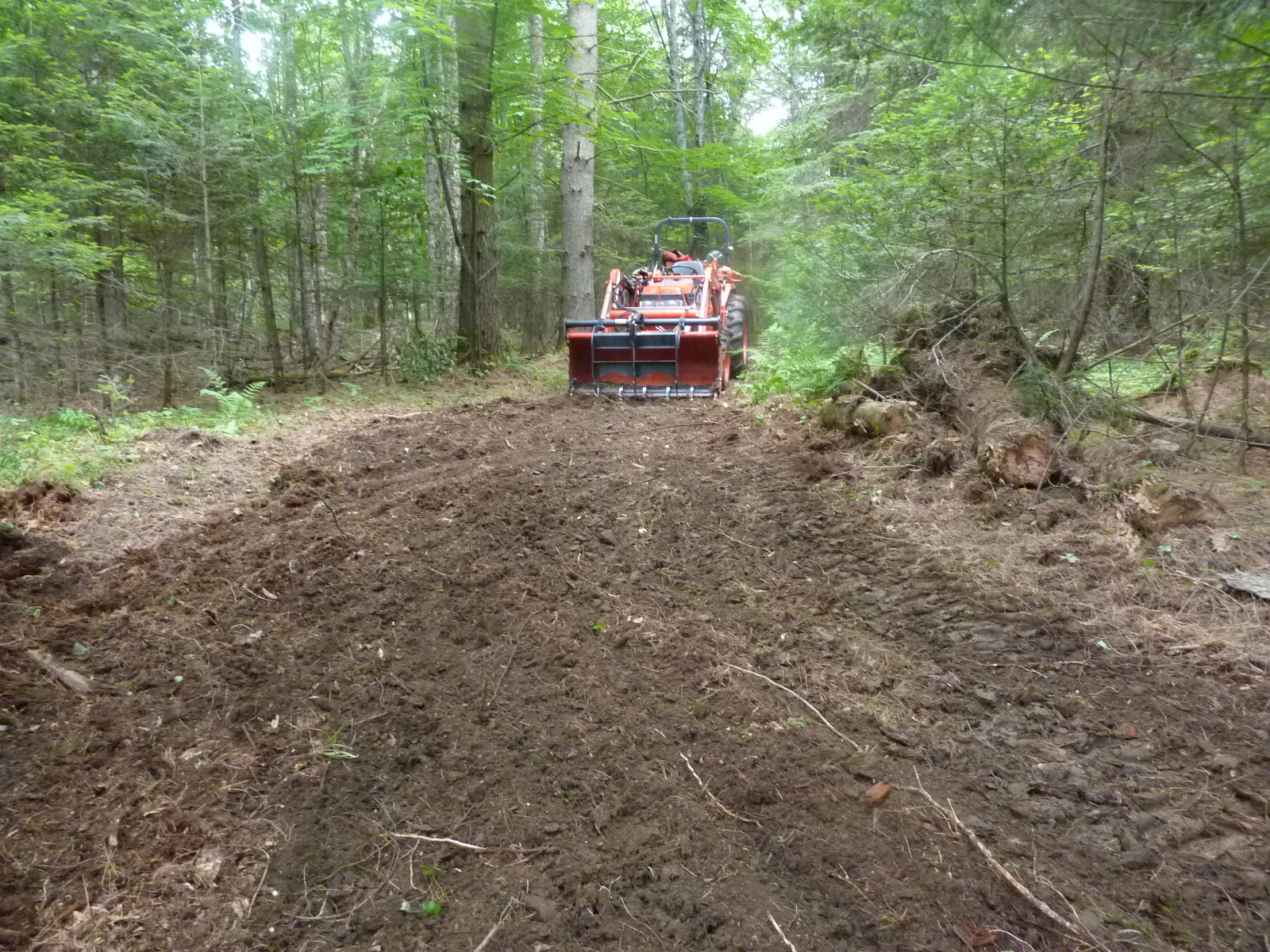

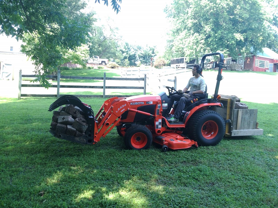

Small tractors with Wicked Grapples. Just for reference...
Not trying to sway you one way or the other OP!
Travis
You need some pictures where a grapple is actually doing something useful! Those two examples show pretty new grapples doing something that could just as easily have been done with a standard bucket!!! Indeed, both would have been more appropriately done with a bucket. Carrying small items (chainsaw, gas can, oil) or pavers that clearly were loaded by hand do not show the benefits of a grapple.

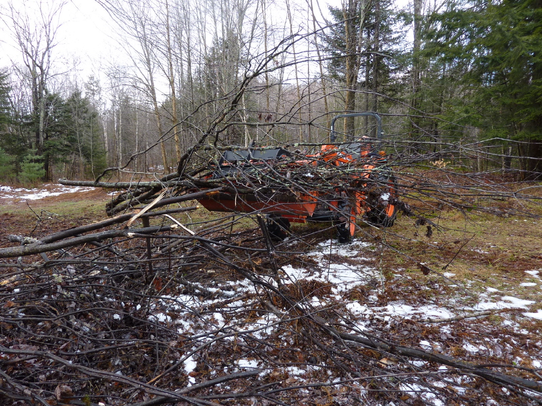

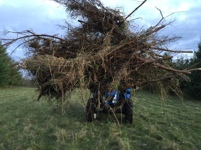

Here's a Wicked Grapple doing work, but where's the grapple?
Travis
/ Grapple bucket for SCUT? #24
I didn't take the pics, but I'm always grateful that people care enough to photograph our grapples and I like to show them off when the opportunity arises!
I have a pretty good collection of Wicked Grapple pics, but those were the most relevant to this thread.
Travis

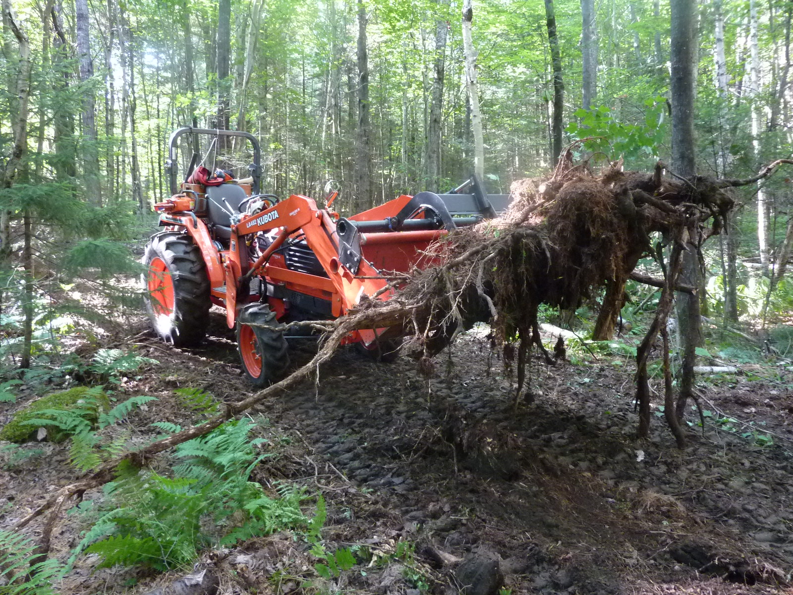

That's more like it!!!! I can see the left bottom corner of what I presume is the 50" compact.
You should start a series of photos "where's the grapple?" just like "Where's Waldo?...
That photo is also a great example of "sticky brush" and why a narrow single lid grapple can do far more work than one might expect.

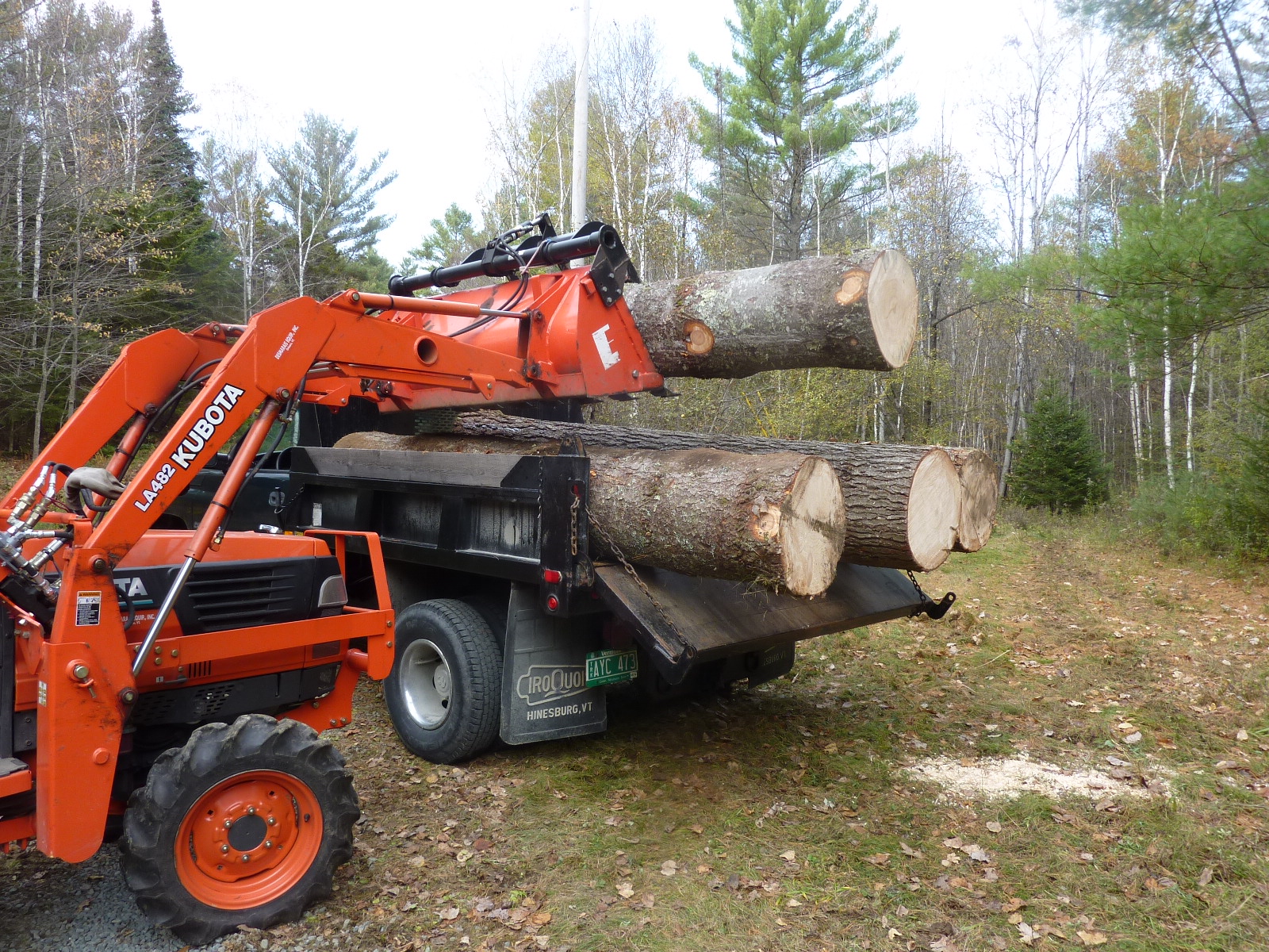

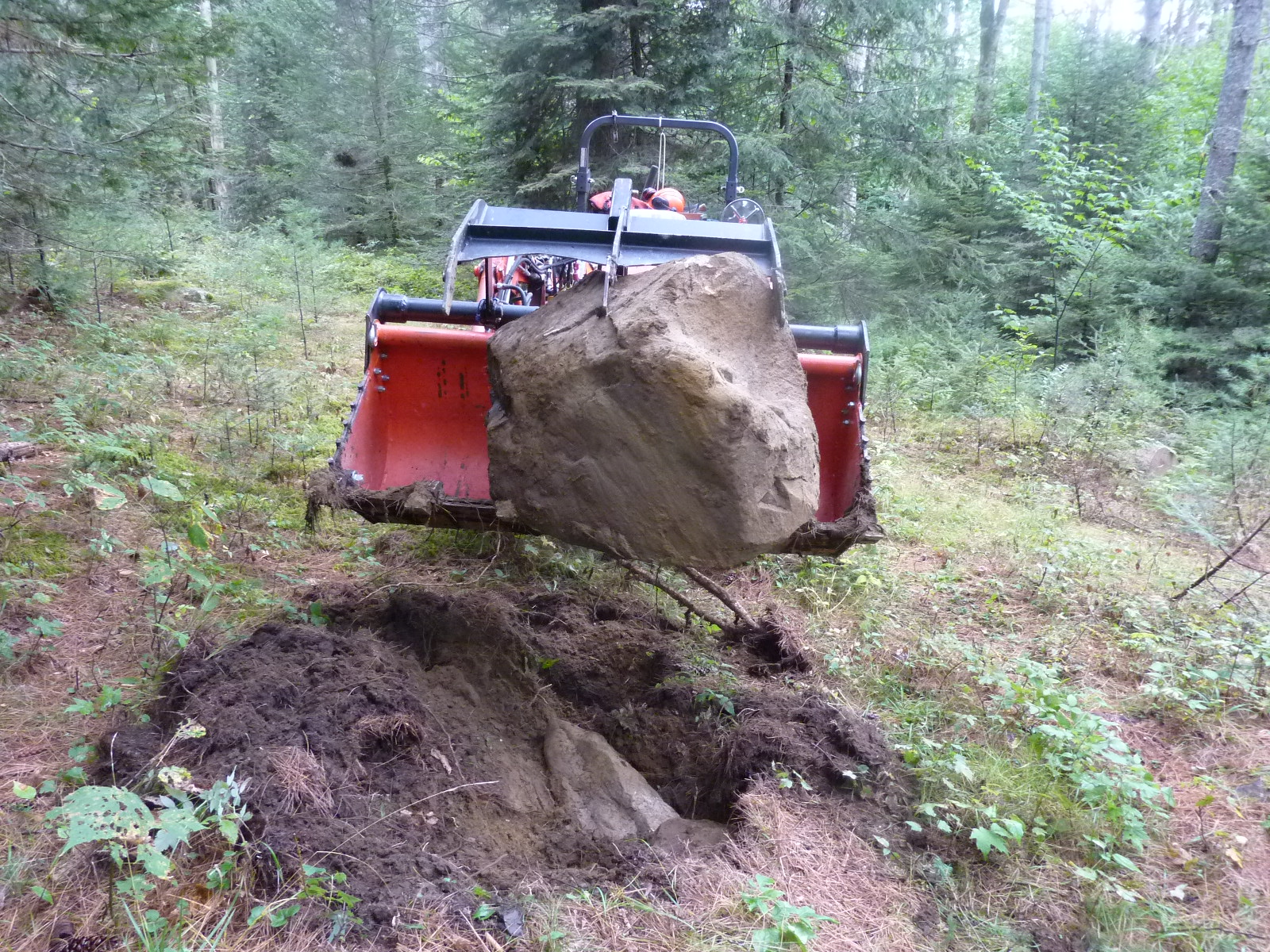

Here's a similar (non EA) 48" grapple trying to hide:

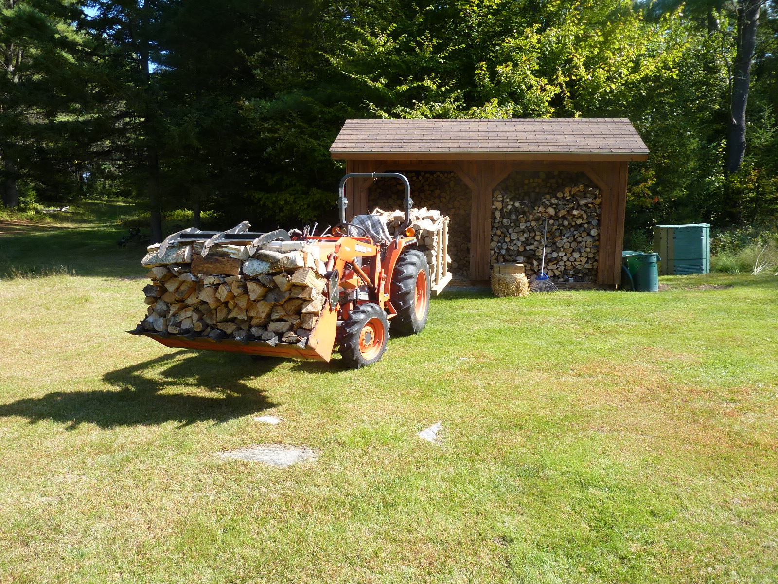

image-296781764.jpg image-3915794488.jpg image-1710909432.jpg The last picture was obviously hand loaded, but it still holds a lot more than the bucket. These pictures were a were small percentage of what I recently did with it. I cut 5 or 6 of those terrible pine trees, a large oak, and a huge maple. I cleaned it all up with the grapple.

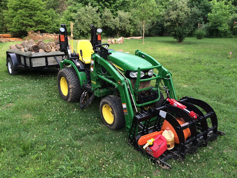

Just for comparison :D
I don't know why you are so against these bucket grapples they are really quite good.
gg
If you read closely most of the posters who seem to be AGAINST a bucket grapple have larger tractors and budgets. Those of us with small tractors, small budgets, and big ambitions have tradeoffs. I'd really like to have an EA $1,600 grapple, either pin on or with a $300 QA for my B7610 but realistically my chain and pallet forks will probably do for now.
