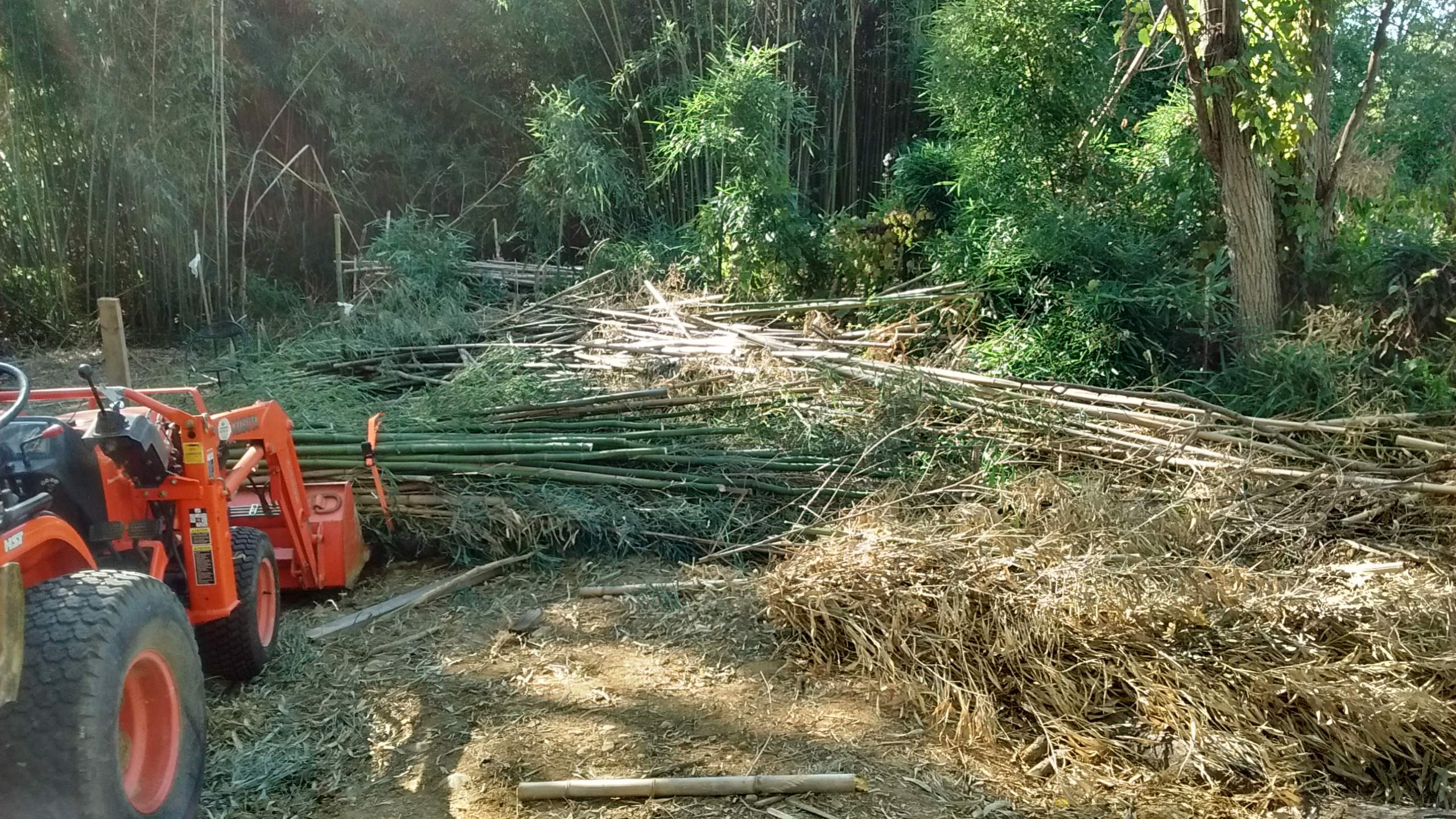

Do you have pallet forks?
With a $149 pair of clamp on pallet forks and a chain or two I was able to get sort of a "poor man's grapple" which greatly assisted in clearing 1/4 acre of brush and bamboo.

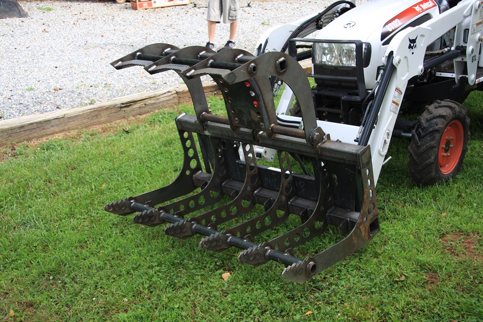

Since the OP has a pin on bucket, I'd vote for the add on thumb/grapple. That lets him keep his bucket for hauling loose material. And BAP gave him a great source.
If he were QA I might vote for an open grapple to swap back and forth with the bucket.
I built a Grapple onto a Bobcat low-pro bucket. I have the best of both worlds.

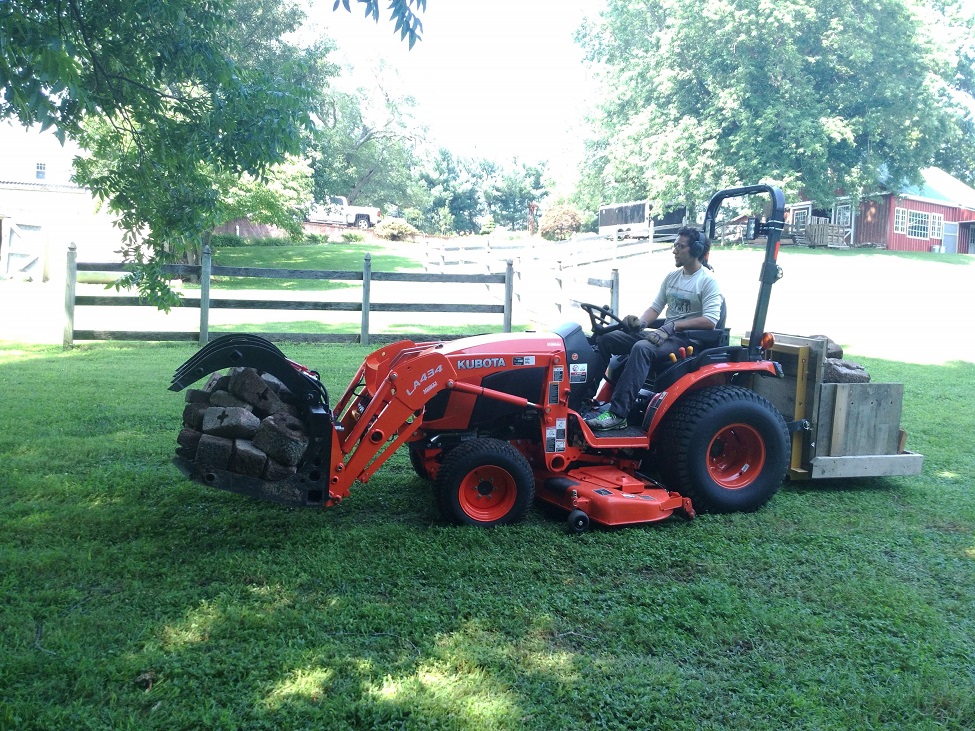

I did this to a Kubota BX 2200 scut with great results. Electric diverter valve from KBOH and the thumb from greens machine. Worked very well.

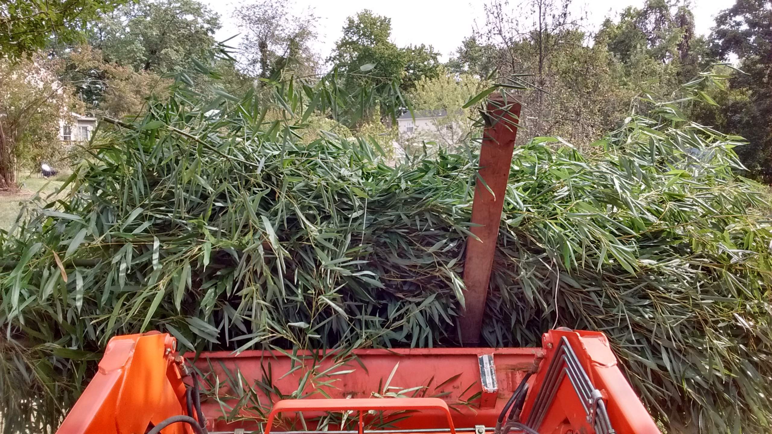

Trying a picture.

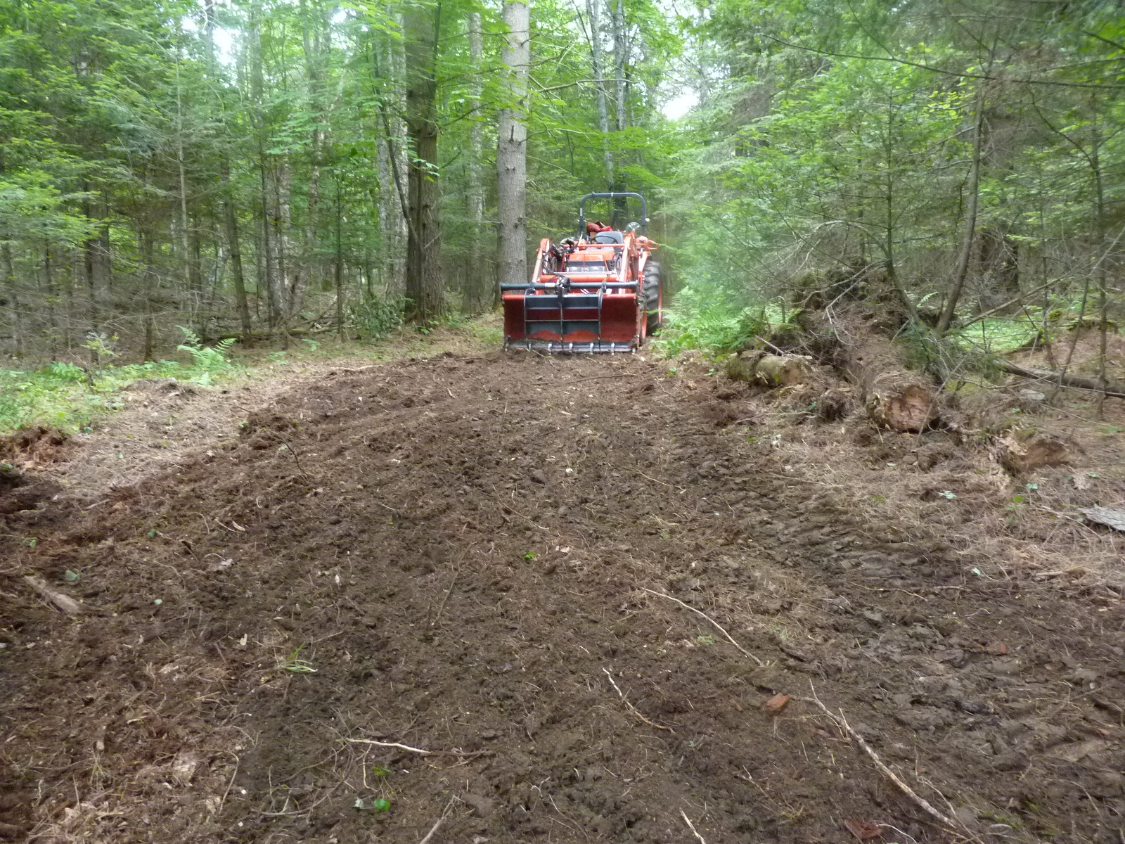

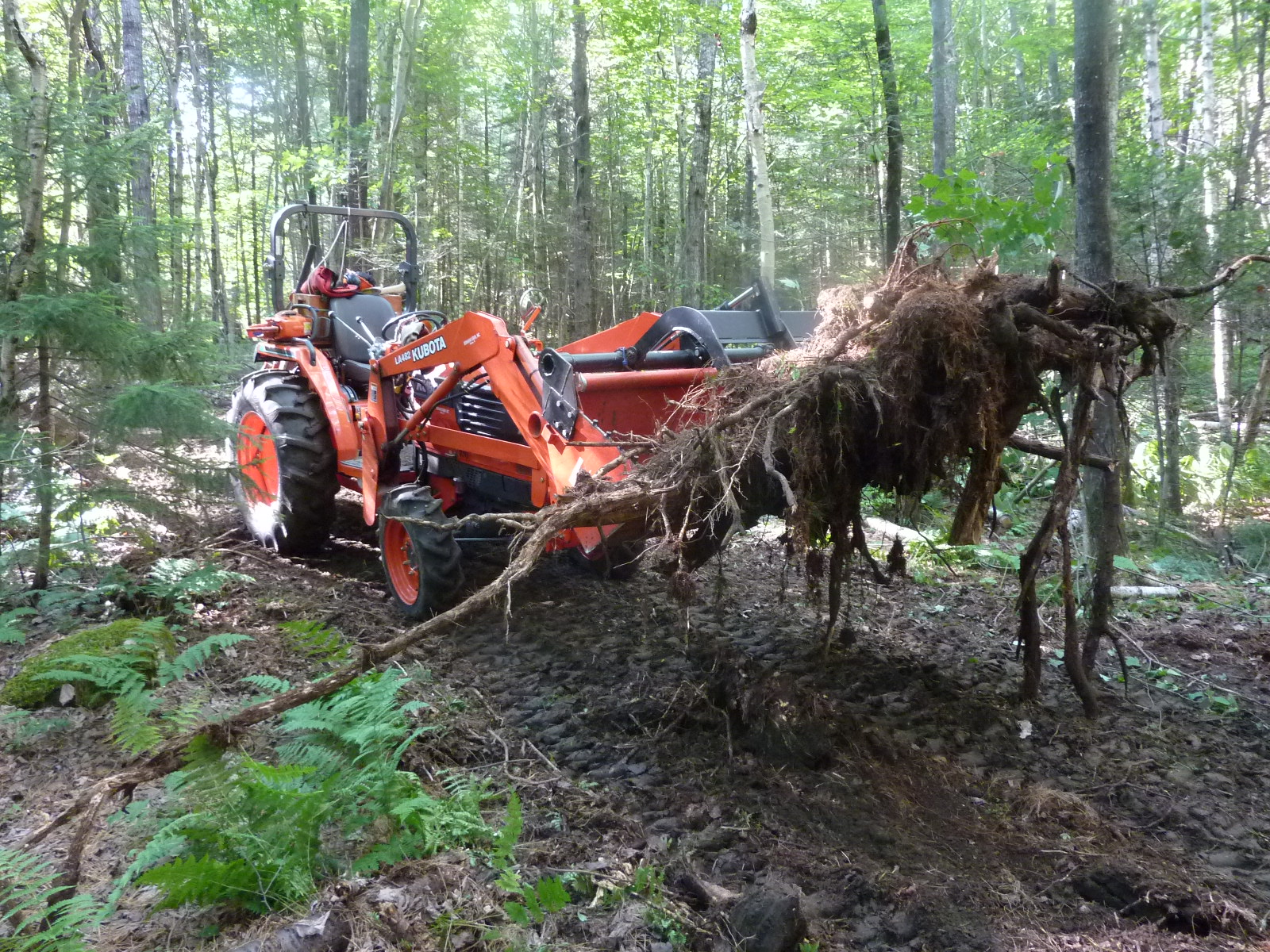

/ Grapple bucket for SCUT? #13

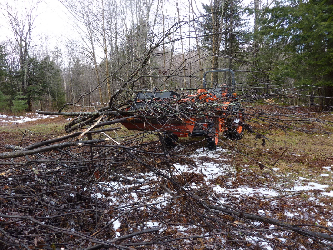

I have a pin-on bucket on my L3010 and put a bucket grapple and tooth bar on it. I find it very functional and use it all the time. The thumb types and the API I have don't weigh much. You loose a little lift weight but gain a whole lot in added capability. I work on woods roads and like having the bucket and grapple on all the time. Dirt, rocks, gravel, stumps, brush, or whatever, makes no difference - I can move it w/o changing anything.
gg

Another vote for Green's Machine Thumb;do reinforce the top of your bucket and a tooth -bar makes it more versatile.

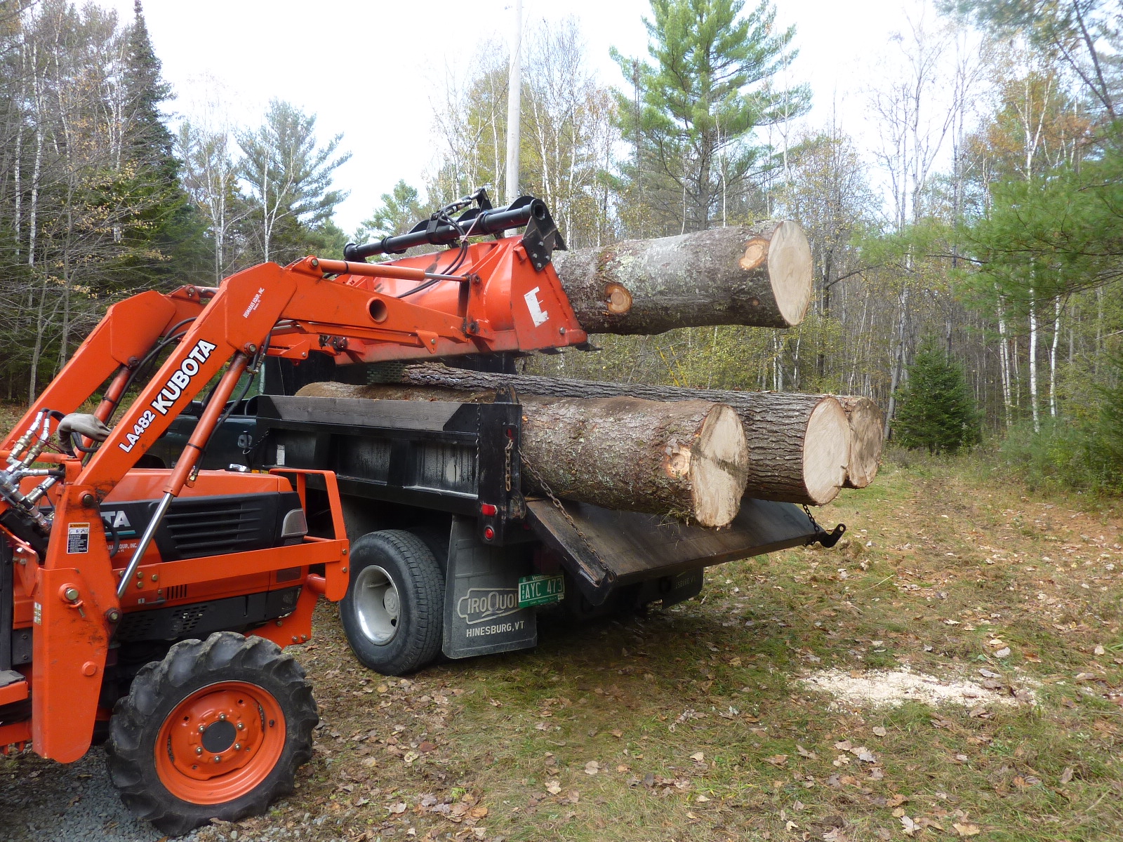

Can you curl the loader at the same time you close the grapple?
He cannot because he switched the hoses for curl/roll to the grapple. However, that is a very clever compromise especially for cleaning up debris or moving logs etc. Yes he loses the ability to come down on a load from the top but he has $600-1000 bucks in his bank account that the rest of us don't.
/ Grapple bucket for SCUT? #18
I would hate to give up the ability to curl it the same time. I curl and close the grapple all the time. He has more than that in his bank account that the rest of don't because he saved the price of a real grapple.
/ Grapple bucket for SCUT? #19
I used it to move large piles of bush to a burn pile, and lift logs for loading on a trailer and cutting with a chainsaw. It was a little hard on the trailer as I couldn't roll the bucket to avoid dropping the log from a foot, but no big issues. Would buy another in a heartbeat. Weight around a hundred pounds.
