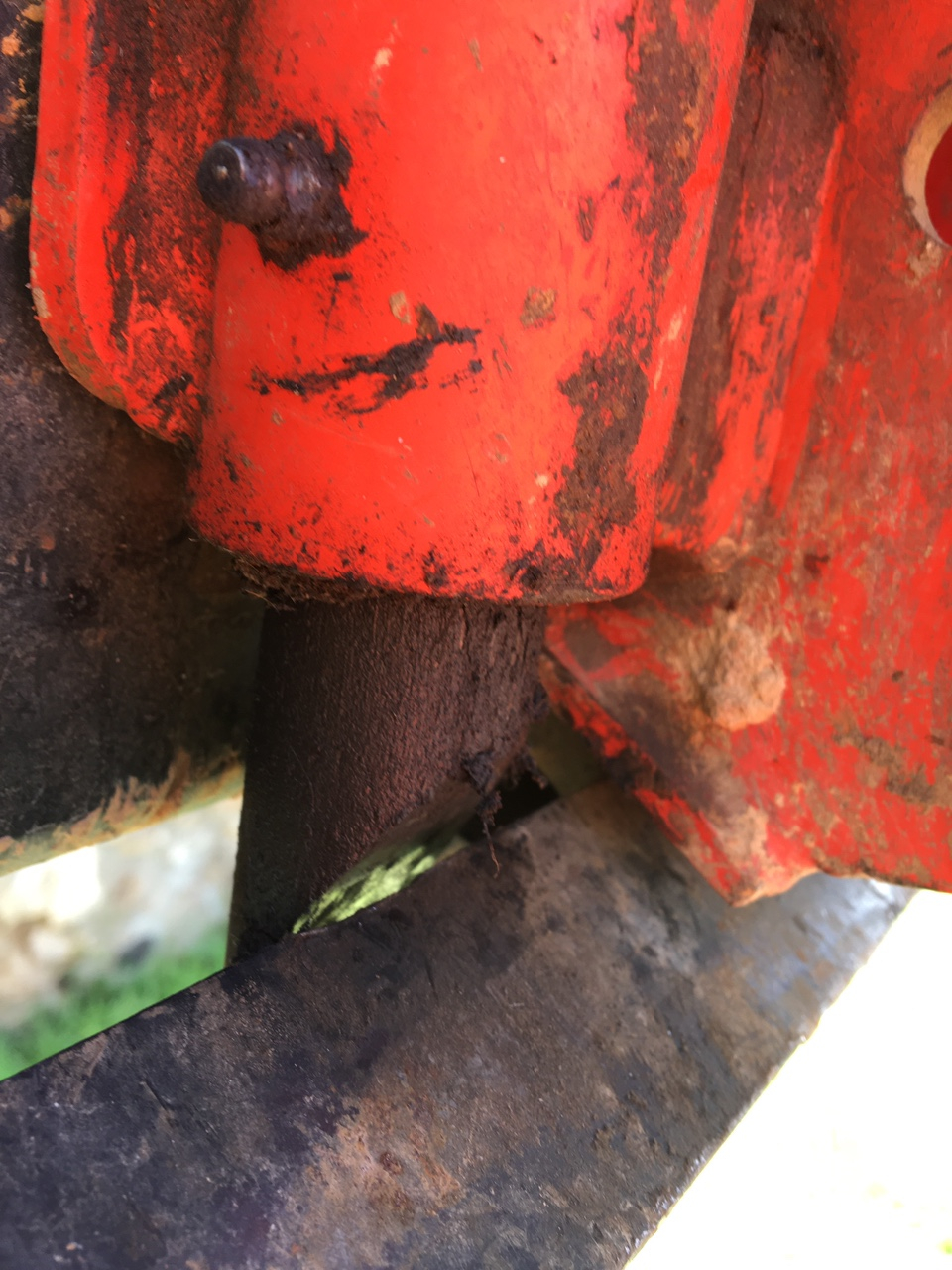

New grapple became loose and fell off loader. Result is scraped up hose and grave concern. This is noticed when grapple is full open, against mechanical stops, and raking backwards.
Cam over levers are not as tight as on my other attachments. With levers completely closed this is a small gap at locking lug and grapple lower engagement.
Measuring the distance from the top engagement to bottom engagement shows about 5/16 longer on grapple than it is on Kubota bucket or Woods forks I have to compare. As well the flat plate portion of quick attach does not have much to engage on grapple, this may contribute to apparent loose figment as well.
Is there a standard for this type of mount?

There is some adjustment of the wedge pins on the tractor side.
I have seen differences in the ssqa mounting by manufacturers.
My 30 year old skidsteer grapple fit the bobtach yoke on my old tractor fine. On the newer M59 there was a lot of play like you are describing. I made and welded in 3/8” plates on lower grapple side mounts.
Others said they have fixed similar issues.

It’s fairly common for the Kubota SSQA mount to be undersized. You just need to add a shim at the top. It’s an easy fix.

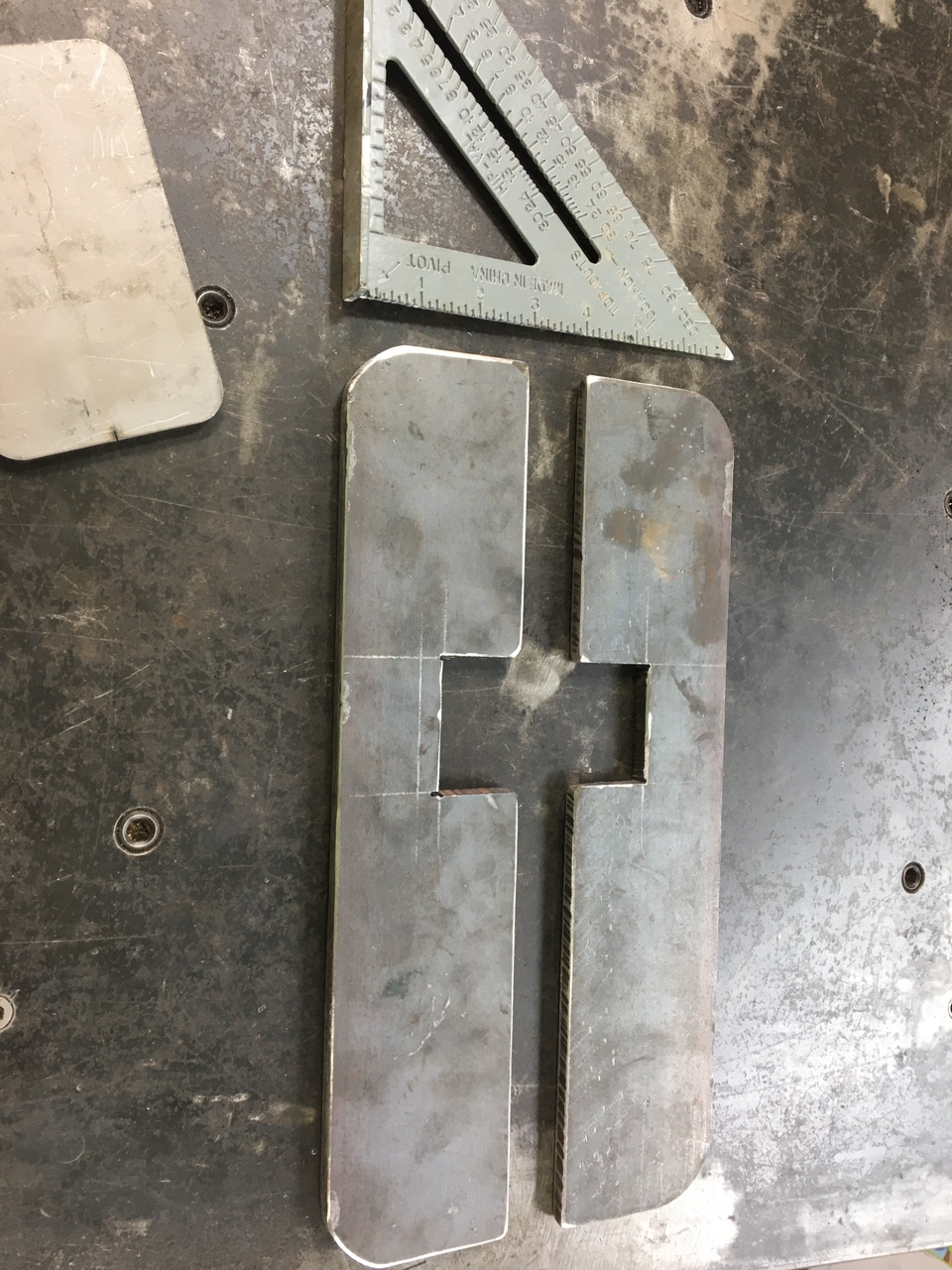

Take a piece of bar stock that’s as about an inch wide, as thick as the gap and as wide as the frame and weld or bolt it on the top edge.
/ Grapple became unattached. #9
I guess it works but I think you’d be better off shimming the top so you can maintain maximum pin engagement.
When you shim the bottom you you run the shim past the pin to maintain pin engagement, also helps to reinforce the lower latch area, I prefer it over shimming the top.
/ Grapple became unattached. #10
I guess as long as you did a tight fitting job it would be a good solution.

I agree with Smokeydogs fix at the bottom.
This is the gap that he shimmed:

This is why Kubota QA has a problem with forks and grapples coming off if there is a gap at the bottom.
Compare Bobcat top of QA:
To Kubota top of QA:
frj777 you need to check the top of the QA plate on the grapple to see if it is bent out or still straight:
/ Grapple became unattached. #14
Adding to X-mans post you really need a close fit in the three places pointed to by the arrows in the pic. Make sure there is no gap between the face of the SSQA and grapple first. Then add shims as required to close any gaps at the bottom or/and pin.
