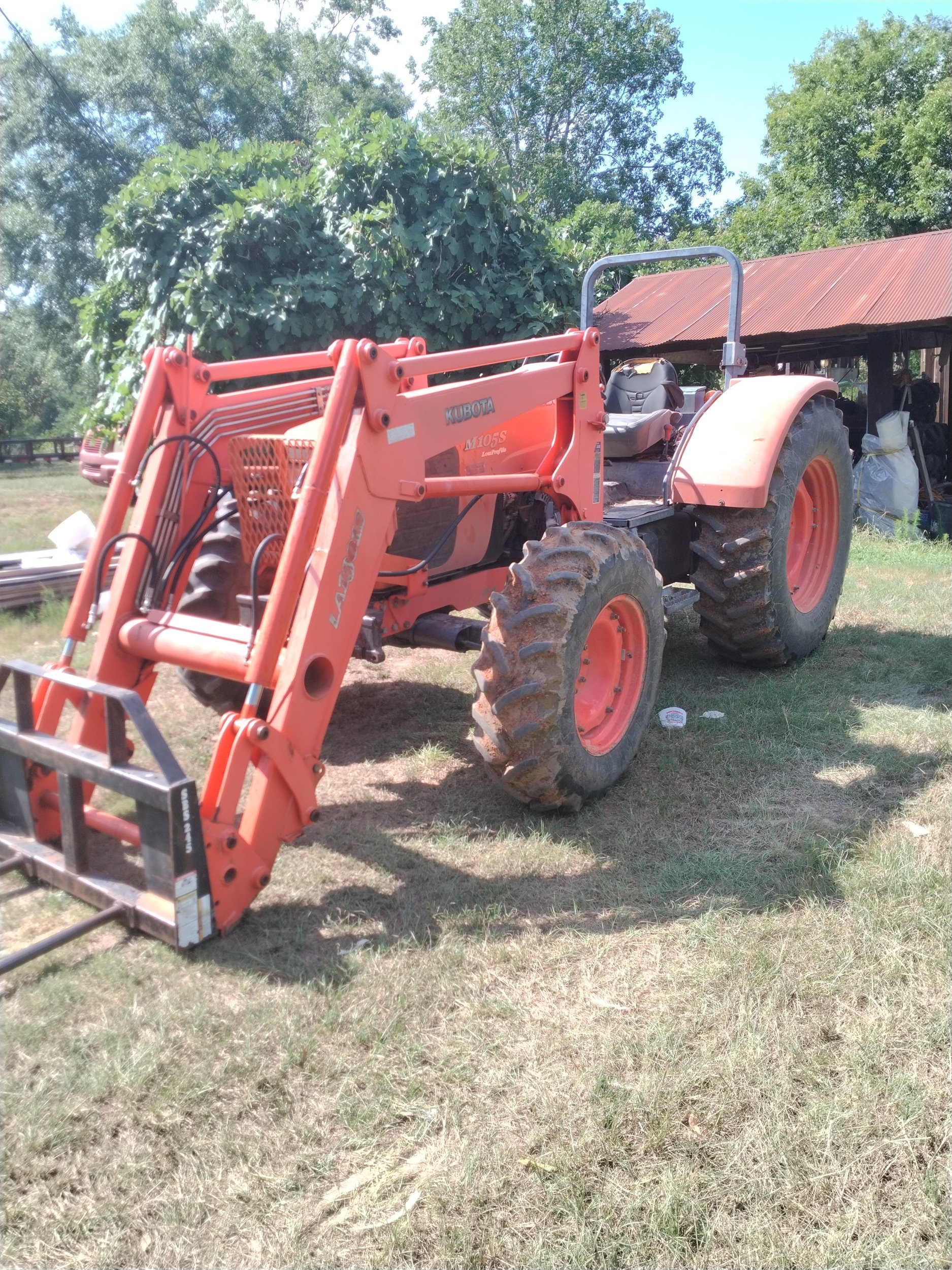

Ive used equipment so loose and worn that the bucket fell off in a mack dump truck full of poop. Then later the grapple came off two times one day cleaning brush. So, I finally had the new skid steer beside the old one and did some measuring. Waved a welder over, had him weld some rebar across top of the quick attach bracket. Then I drilled a hole, used a piece of chain and two screw pin clevis, and chained them two handles together when closed. Ain't no way she can come unaloosened now. Never has since. I don't know why they don't come that way. We changed all six of our tractors to SSQA on the loaders. Bought plates and welded on all our front end loader attachments. Buckets, grapples, hay spears, etc... I got some good loader quick attatchers working at Kubota. One side would come loose and bend bracket real bad, they would replace. I would take the bent one home and cut it loose and weld a new straight pipe in it and put on one of our tractors. You will notice the orange paint.

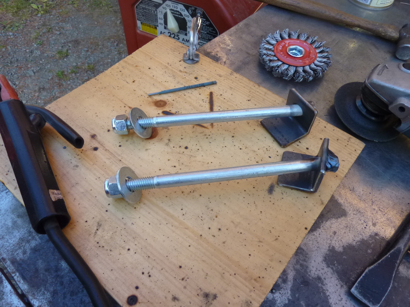

Same thing happened to me when I was pushing down on a big brush pile to compress it. One lever was pushed open by an upright branch in the pile and that side came off. I made a couple locking bolts to hold the levers closed. There were a couple existing holes in the loader I ran the bolts through.

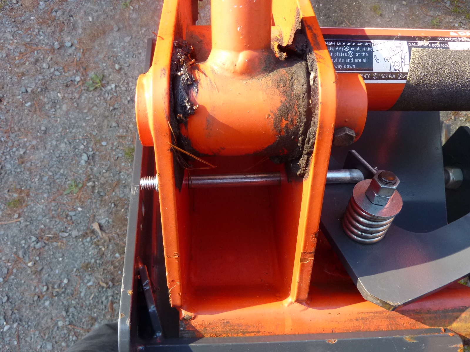

Thank you for posting this, I was wondering how I was going to fix mine. I don't even know how I bent it. I took the grapple off and tried to put the bucket on but it wouldn't line up. A little gentle persuasion with my 16lb sledge hammer got it on, I am not looking forward to taking it back off.
/ My grapple fell off #8
Usually you can tilt it all the way up. Chain the side that is still away from the loader, back to the loader. Then tilt down a little bit at a time until other side lines up with it. That's the simplest one man show way to fix it. The ones I was talking about were bent like 90° to each other. Cutting and welding was the only way to fix those. We always kept the old one there, and if the customer left it, we could get it and take home.
/ My grapple fell off #9
porta power and a short ram, leave the side that is troublesome connected and disconnect the other side then use the short ram to bend it out a little
/ My grapple fell off #10
That was easy, thank you. I used a variation; chained one to a tree and tilting a bit.
