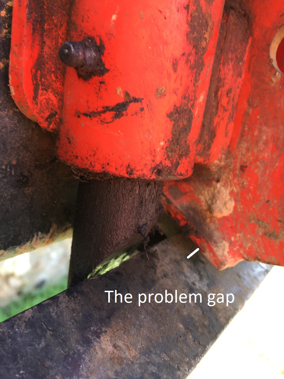

My EA Wicked grapple goes on and comes off a LOT easier than my other SQAs, though, despite a lot of heavy action it has never come loose. I seem to recall that Kioti also had some advisory out around the time that I got my Kioti [2016] (but it wasn't applicable for my tractor). I suspect that manufacturers are little loose on their interpretation of the specs: and aftermarket folks likewise- add the two together and things can be a bit off.
/ Grapple became unattached. #23
The Kioti bucket fit perfect. The Kioti forks and RK Granite grapple were both really tight to the point that the left pin wouldn't fully engage, and the right one took me standing on the lever to get it to go over center. Had to grind on the left pin to get them to fit, and it still take a good bit of upper body force to get them to go.
/ Grapple became unattached. #24
That sounds like something is bent, flexing or out of spec. You shouldn't have to grind on the wedge pin. The pin is wedged to compensate for variations in attachments. Fix the attachment, not the pin.
On my new grapple the pin is spring loaded and adjustable. I can adjust the tension on the lever from zero to stand-on force for closing or going over center. Once the pin is engaged, it shouldn't be popping out.

On my Kioti, at least, there are no adjustments for the pins that I can figure. The pin was just a touch too long and the wedge angle was just a touch outta spec. I'm sure both dimensions were within tolerance but the pin was just a hair off compared to the other (I actually mic'd both, and you could see the pin just barely engaging at the tip) so I decided to grind the pin down so I didn't have to adjust every attachment to the pin.

Smoke with manufacture and they are sending a shims for bottom of QA. It will be up to me to weld…they did credit my card $ to allow for me to hire a welder. All in all not unreasonable.
I expect this will resolve my problems.
Grapple is a EA Wicked 60 inch Root Grapple.

The first photo that shows the OP's locking pin seems like the pin doesn't extend far enough to lock in. All the other pics from other posters show the pin extending further.
/ Grapple became unattached. #39
The first photo that shows the OP's locking pin seems like the pin doesn't extend far enough to lock in. -------------------------------------
It looks that way because the bottom plate is too low, there is a gap between it and the QA.
The shims will fill the gap and contact the pins.

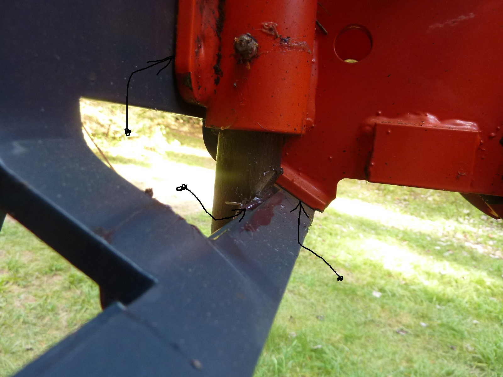

Installed shims provided by EA. They where laser cut and required trimming and grinding to allow for welds already on grapple, expected. I drilled and counter sunk grade 8 bolts tapping grapple frame.
Over all I am pleased with results, however there is still a gap at plate, right side is 1/8th inch and left is 1/16th inch. Also notable is that spring tension…it is now present where previously it was not but is not as much as my other quick attach implements.
EA only had 3/16 shims, they sent 4 so I could stack, but this will not fit. Considering asking for 1/4 and 5/16 shims, or 1/8 shims (2 on left and 1 on right with existing 3/16 shim). This should increase spring tension and eliminate gaps.
Thanks for industry standards on quick attach mount, very helpful. This supports my gap measurements perfectly.
