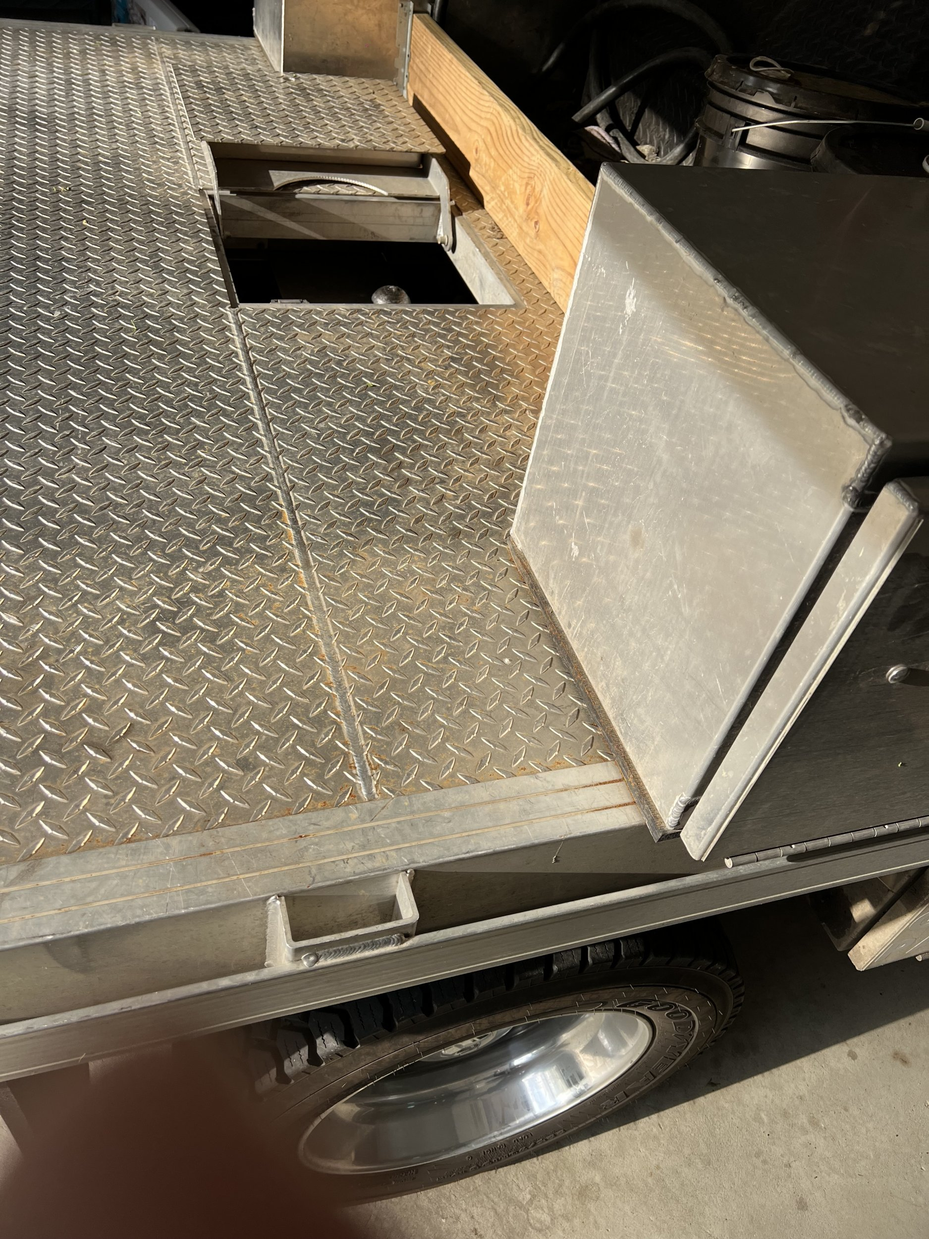

I can't find my paperwork for my B&W hitch. Best I can tell the GN ball is 3.5" ahead of axle center. This is on a 2002 SD Crew Cab short bed.
