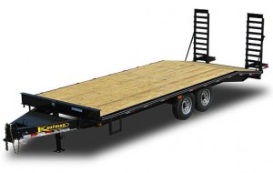

May be a bit late to the party, just saw this thread… I have both and it’s subjective and personal preference. If you haven’t purchased as yet, please take a look at Kaufman trailers, Kaufman Trailers | Equipment, Gooseneck, Car, Dump Trailers Just purchased a 16k GWR Flatbed bumper hitch. Added the Pop-Up cleated dovetail and it works great. Apples to apples, hands down the same or better quality than the Texas or Gator made. Seriously, do a price comparison, it was over $4k less than the Texas and $3800 less than the Gator. Hope I’m not too late but this may help someone else. Cheers

Did you go to their manufacturing plant in NC to pick it up? I am interested in one of their 16k tilt deck equipment trailers.
/ Gooseneck or bumper pull? #112
I would like to add that exact trailer to my existing Kaufman 38K GN. I‘d spec what you have with 8k’s and a split ramp gate. Maybe dual jacks if any $ left. lol
