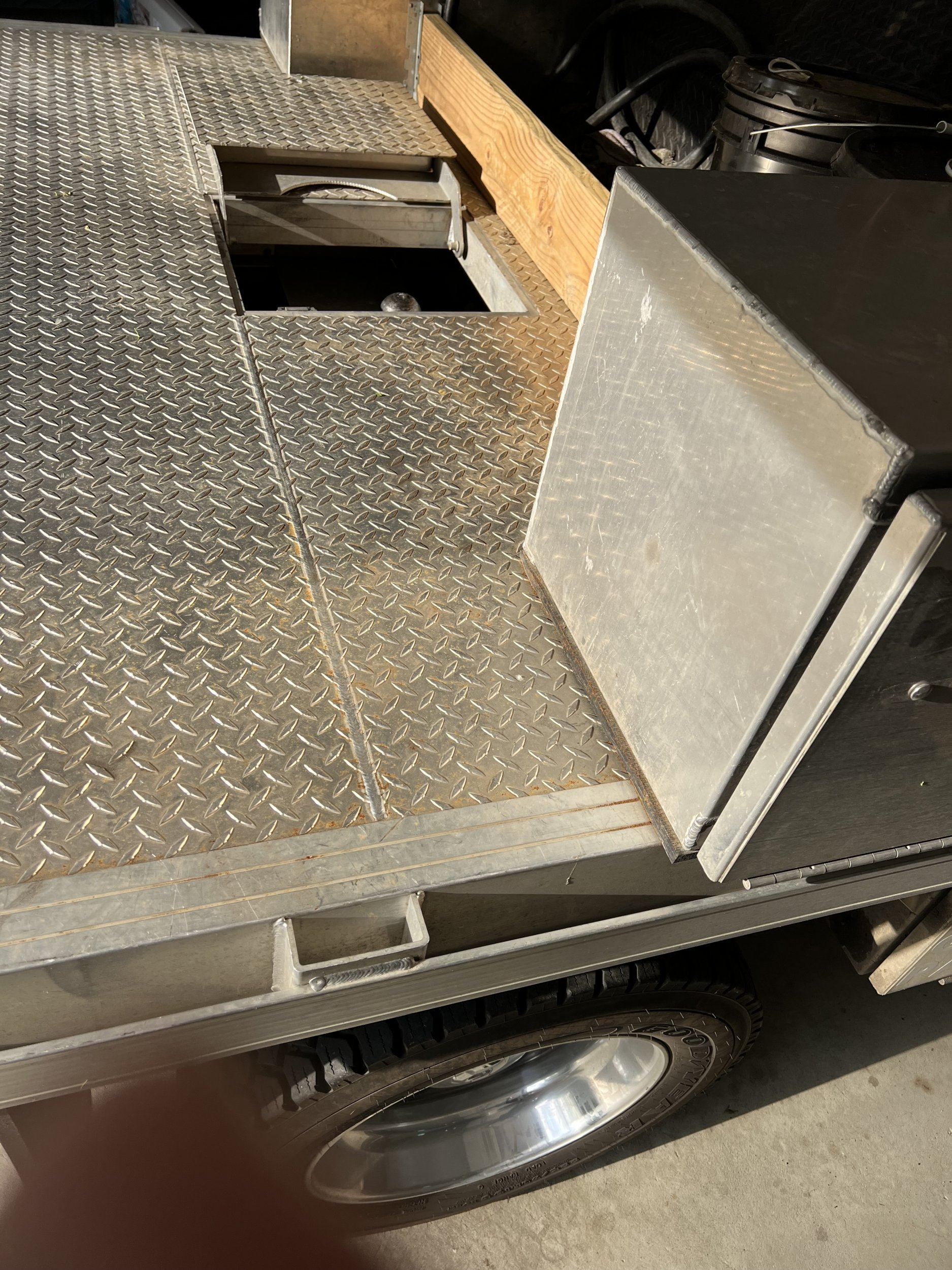

Every one I’ve ever installed (B&W and others) is just FORWARD of centerline. Including factory installed from Ram.
We always put them a couple of inches ahead of the CL mentioned. They live loads pulled great.
Yep, that’s correct.
EBY installed my 45,000lb 3” ball hitch about 4” forward of the rear axle on my RAM 5500. Allows the hitch to share a little more weight with the front axle, too.
